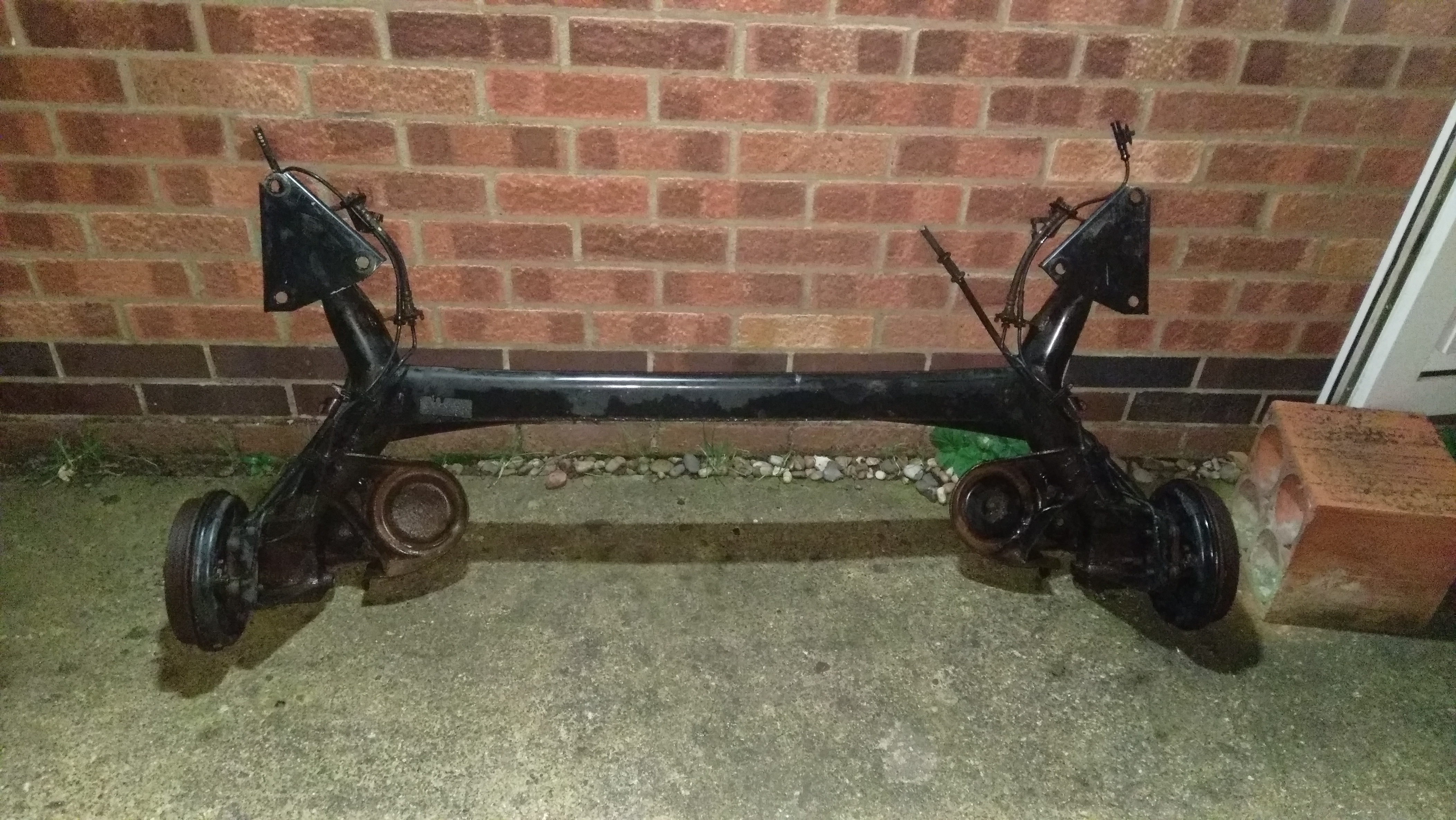

I now have a 2015 Fiat 500 axle under my Panda. It fits fine
I've used the 500 brakes, shocks and springs. Brakes are identical. Shocks look identical. Springs are longer but softer so the back ride height is more like the 100HP. I will try some 1" spacers under the spring mounts but may well go back to the Panda rear springs. The ride wont be as good but load crying is better.
I've not tried the front, but if you want better road holding, 500 springs all around are likely to be the best. If you want the Panda's utility then the stiffer Panda springs will be more acceptable.

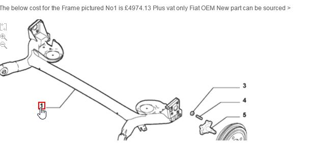

This was not before I had done some research and looked at quotes. I received this one.....

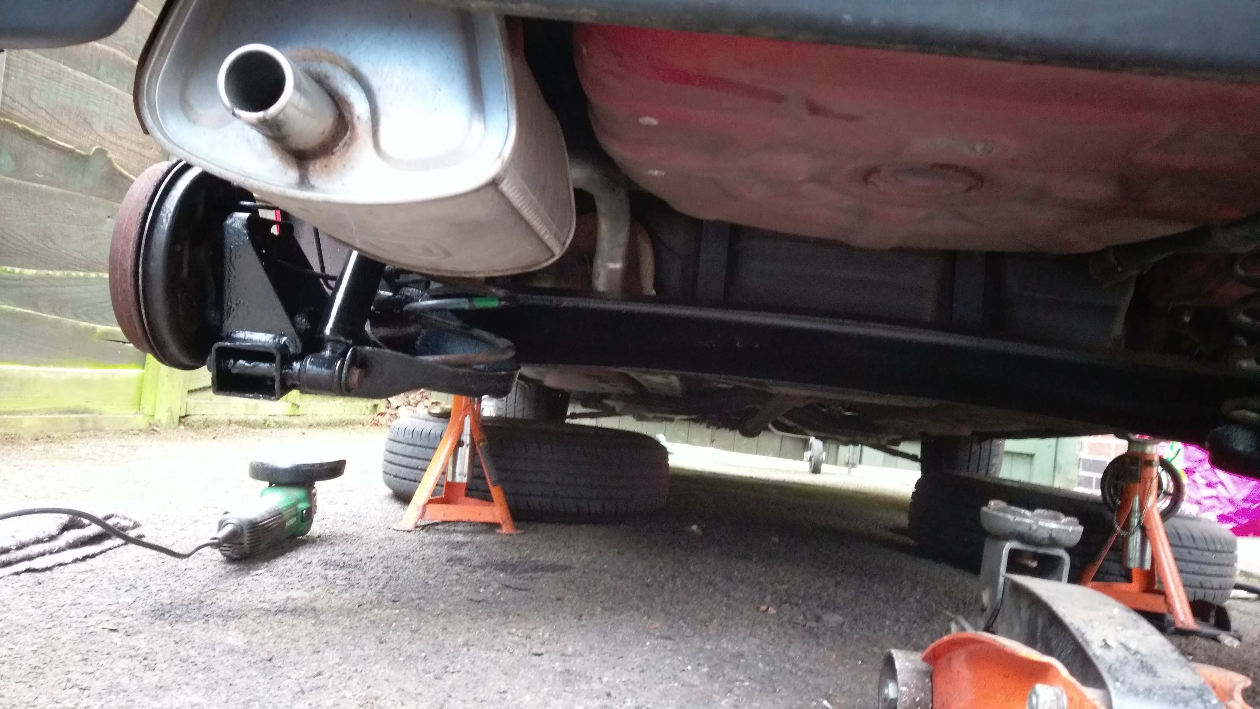

Pretty simple to do. DaveMcT did a good post on the method.
Just needs a good jack, couple of axle stands, some basic tools and preferably a spare pair of hands for the lifting part, although not essential.

A year and a half on from the repair job on mine and she is still going strong.
I had the other side done as a precaution so hopefully no issues for a while yet.

When it failed it was a proper clunk and the spring fell onto the road, lucky we were only in a car park and not at speed. The guy that welded mine up didn't even take off the axle. Just did it on a ramp so repairs are possible and certainly in my case not excessively expensive.

It's a 56 plate. It's in great condition other than the beam although have changed it today only took a few hours...paid £120. For replacement.
