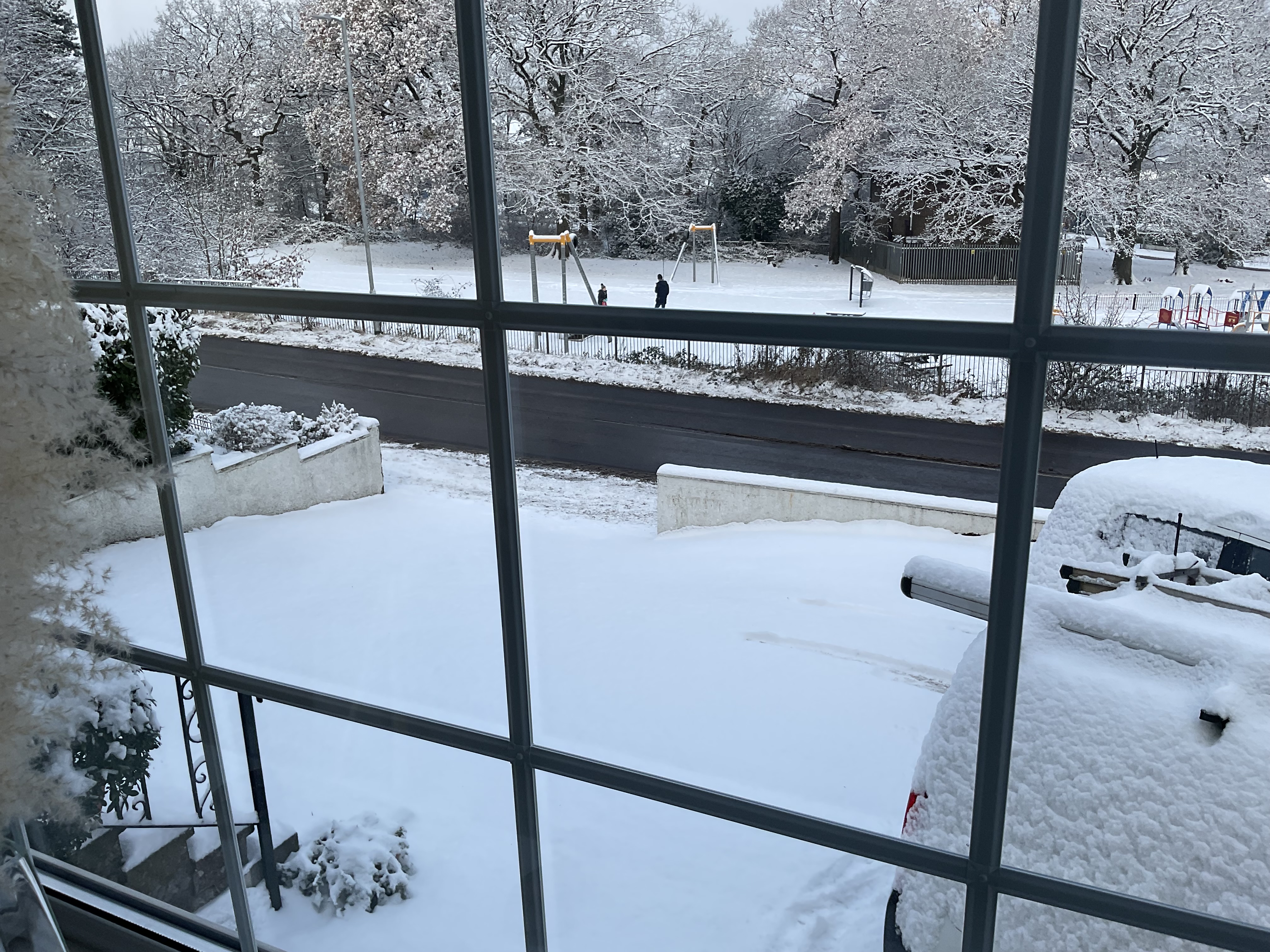

Well we've had a pretty heavy snowfall during the night & this morning probably about 4" or so the soft powdery stuff.
I tried to drive the 4X4 off the drive without clearing the snow but I know this drive and it's treacherous so I abandoned it in favour of clearing the snow with a snow shovel and salt and got the car off the drive however I'm doubtful if even pure winter tyres would allow me to drive off this drive as it's a really steep short runway and I would be reversing to start then turning and then driving off forward.
I managed to get down about four or five feet from the parking position to the tyre tracks in the snow in the photo.

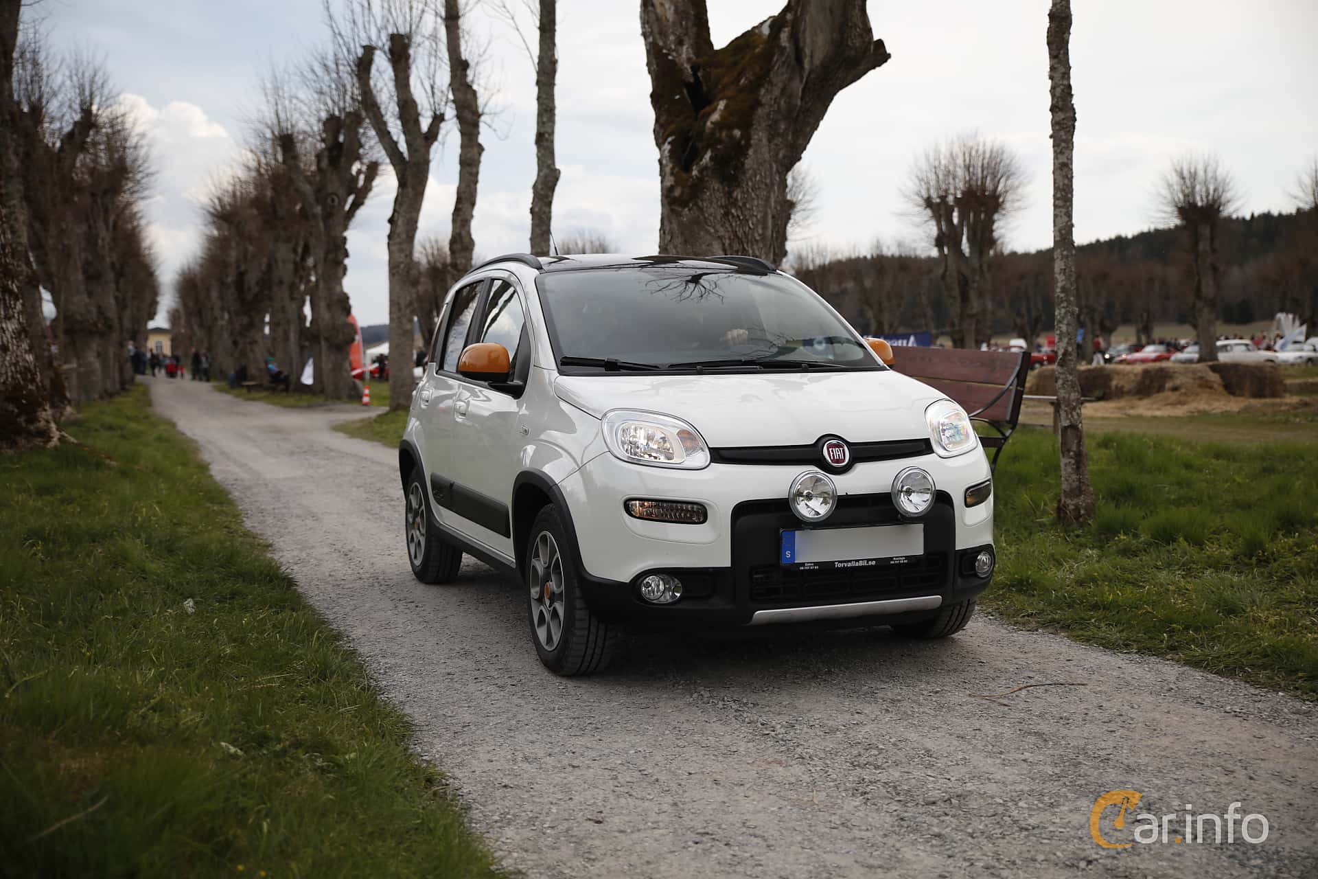

I have agonised about extra lights and am sure you could do this by fitting a bar to the bumber beam, but it would be involved. You would need to remove the bumper and cut it to allow the lighting mounting bar to fit. I have seen some photos while googling panda photos with fogs fitted so you can get some ideas. I dont want to mess with the bodywork on mine. You can get the bumper inserts that hold the standard fog lights and wiring is not difficult. The fog light is common to several typres of car and van and can be had on eBay for sensible prices from OEM suppliers. I have done fogs on a 169 Panda and thy were done without taking the bumber off I anticipate it would be the same on the 319. The existing bumper filler plates were exchanged for for light carrier ones. The fogs fit to these with self tapping screws. The new Panels fitted from the front and again are held with teh rearining ratchets on the trims and a couple of self tappers. There is a guide in teh mk3 section.

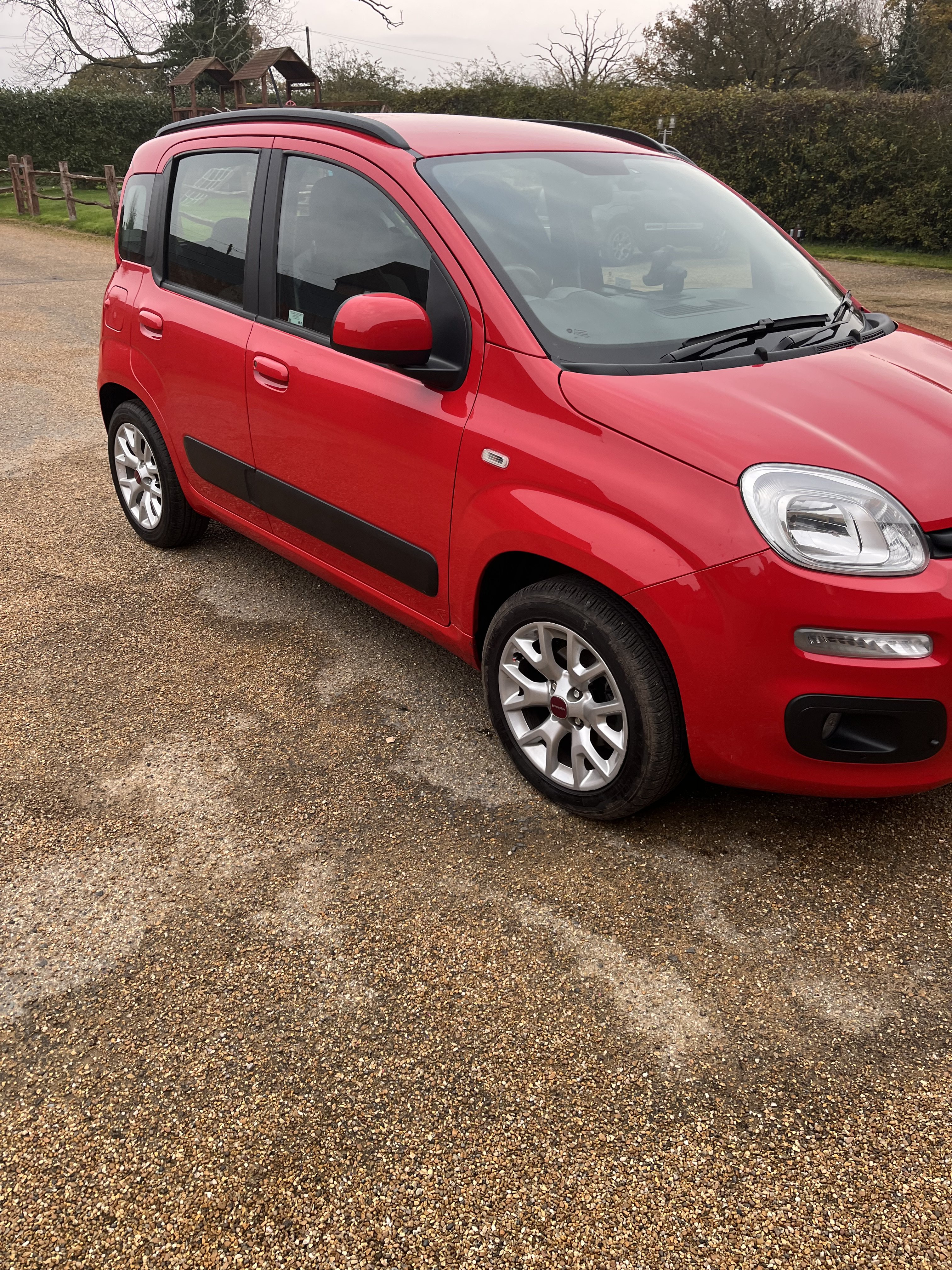

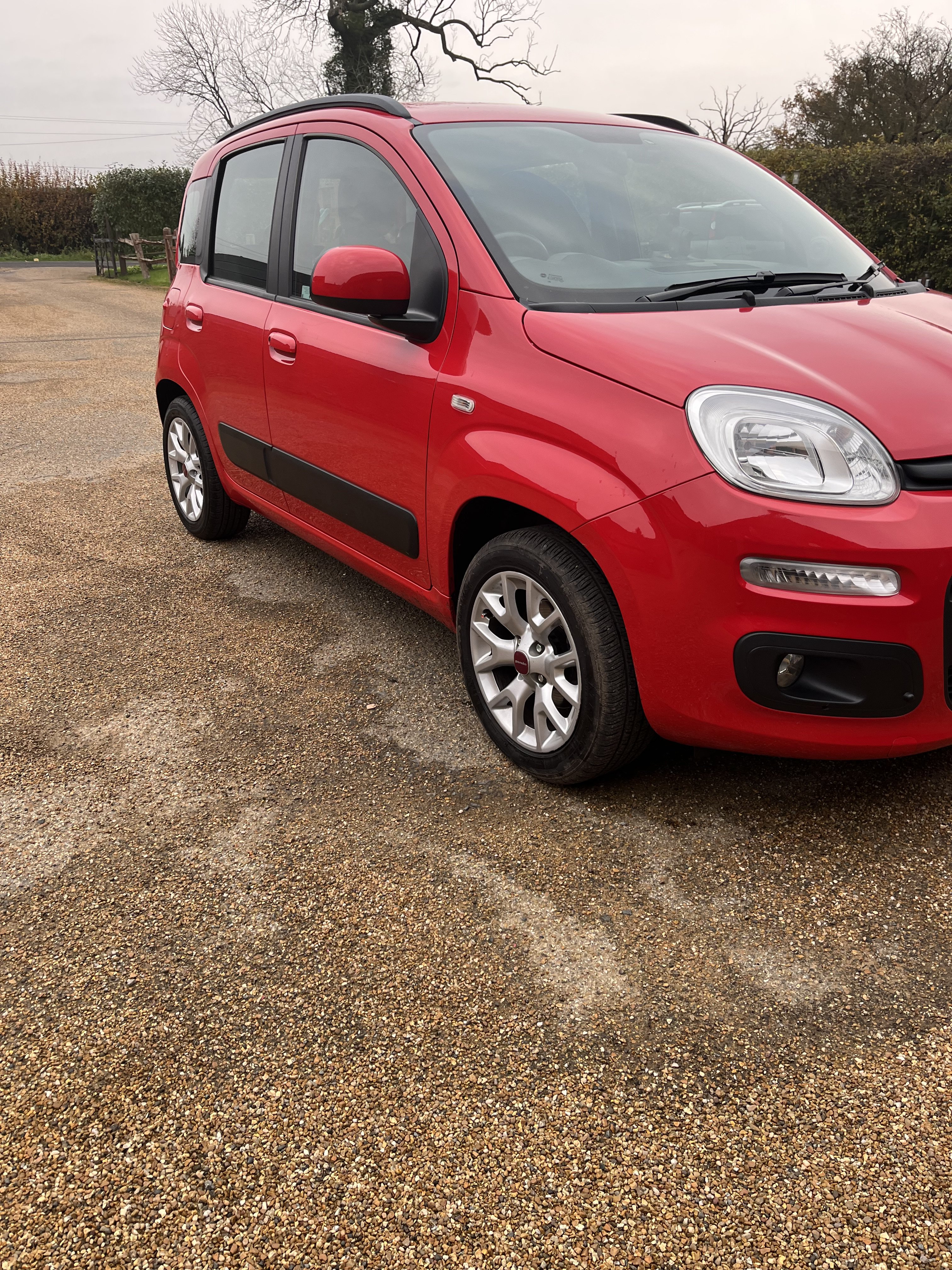

I've also fitted a set of Prometeo spacers, 15mm rear and 10mm front on my red Panda Lounge. Pics below, but I'm not sure on the look, so may take them off.
View attachment 434469View attachment 434470
Fills the wheelarch better. To be honest, no-one other than us geeks will ever know or be interested. I can leave my mates blank if I talk Panda! I guess that's why we share on the Forum.
I quite like the look and the extra track but I wouldnt do it because of the potential paintwork issues. We have enough trouble keeping up with the wheel arches getting stripped now. Even a small increase in track might be useful on rutted tracks for teh 4x4 tho.
I've had a full PPF on mine, so paintwork should be ok.
