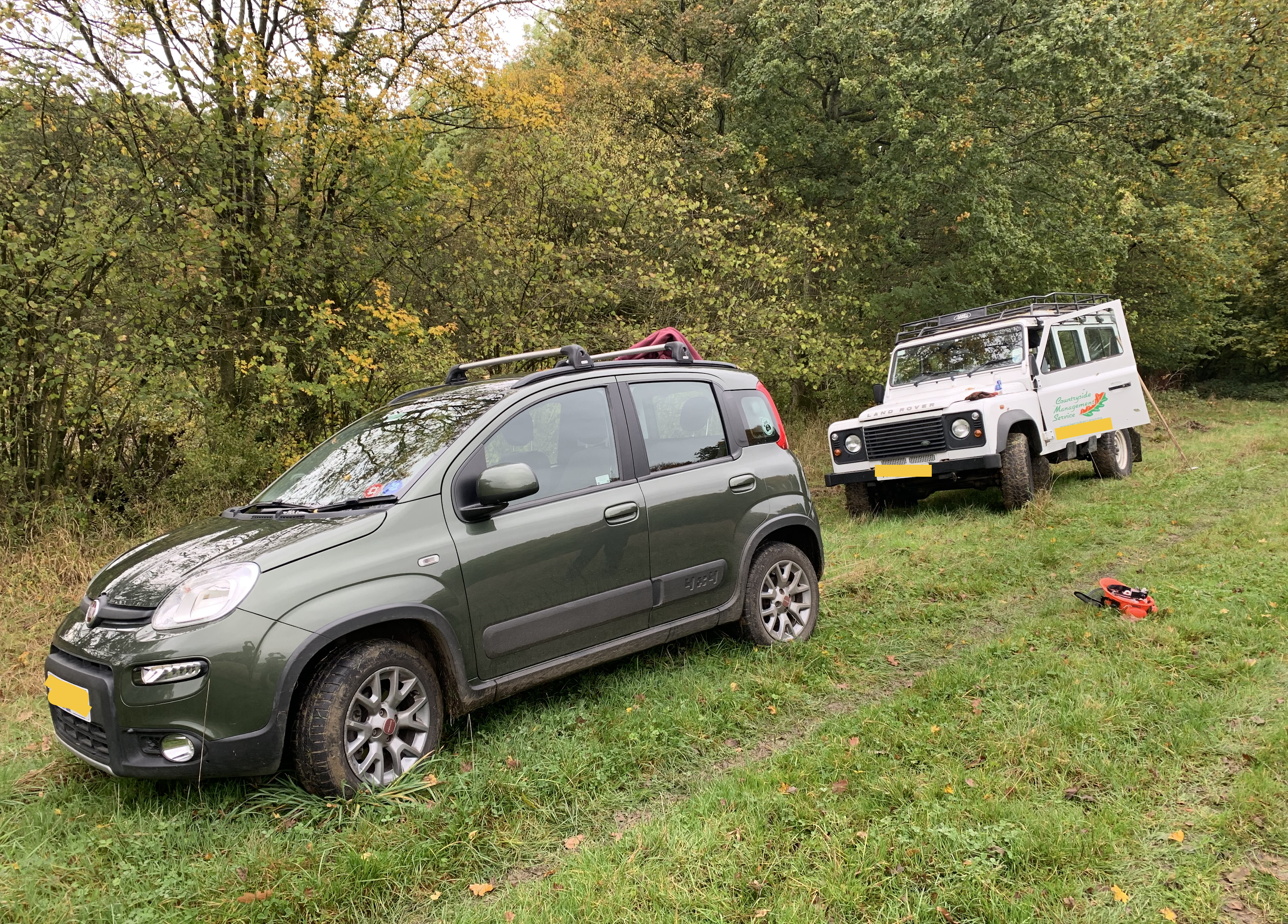

Let us know the outcome - although my 4x4 is mostly used on the road, I do go well off the beaten track quite frequently... (not overly challenging in this shot - just very slippery clay mud and wet grass, but this is maybe half a mile from the tarmac)
