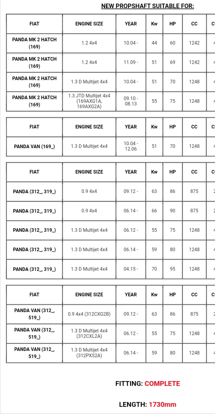

Was this fitted to a Mark 2 panda or Mark 3 (2012 to present)? As the supplier I have tried (same item) says that is incompatible with my 2016 Panda Cross as the part numbers do not match...

Here's the part numbers for the post
2012
I haven't checked if they are the same
There are centre bearing available
I take it with a pinch of salt but the part numbers listed are the same as the older 169
Which means the £11 one at euro car parts should fit, for me it would be fairly simple to remove the old one and take it to ECP and compair
GFS has just listed one but all the information and photo is missing, you could give them a call.
Again implies they are the same
The amount of trouble with listing at the moment, I always message or phone first
