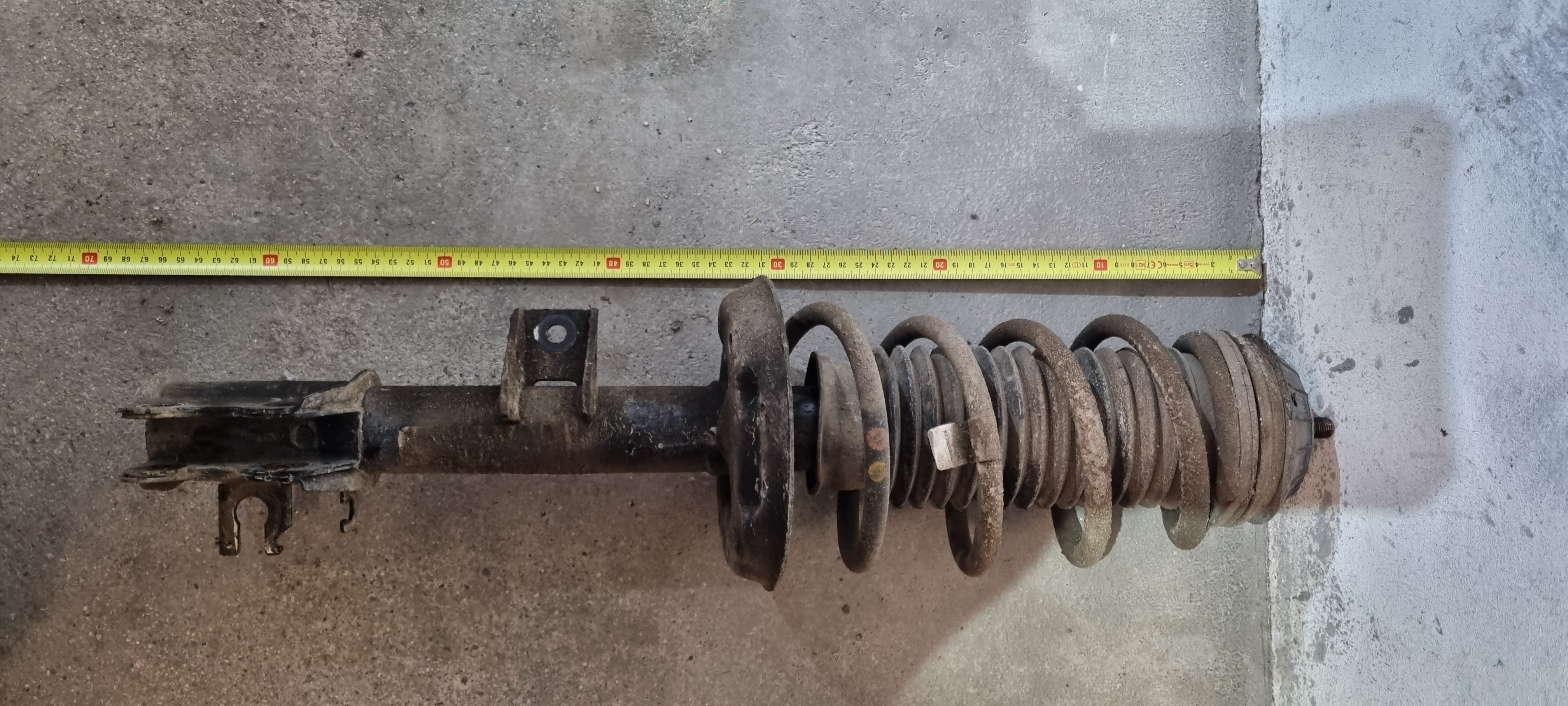

3cm spring lift kit ( measure OEM springs to for possible order of custom springs and shocks)

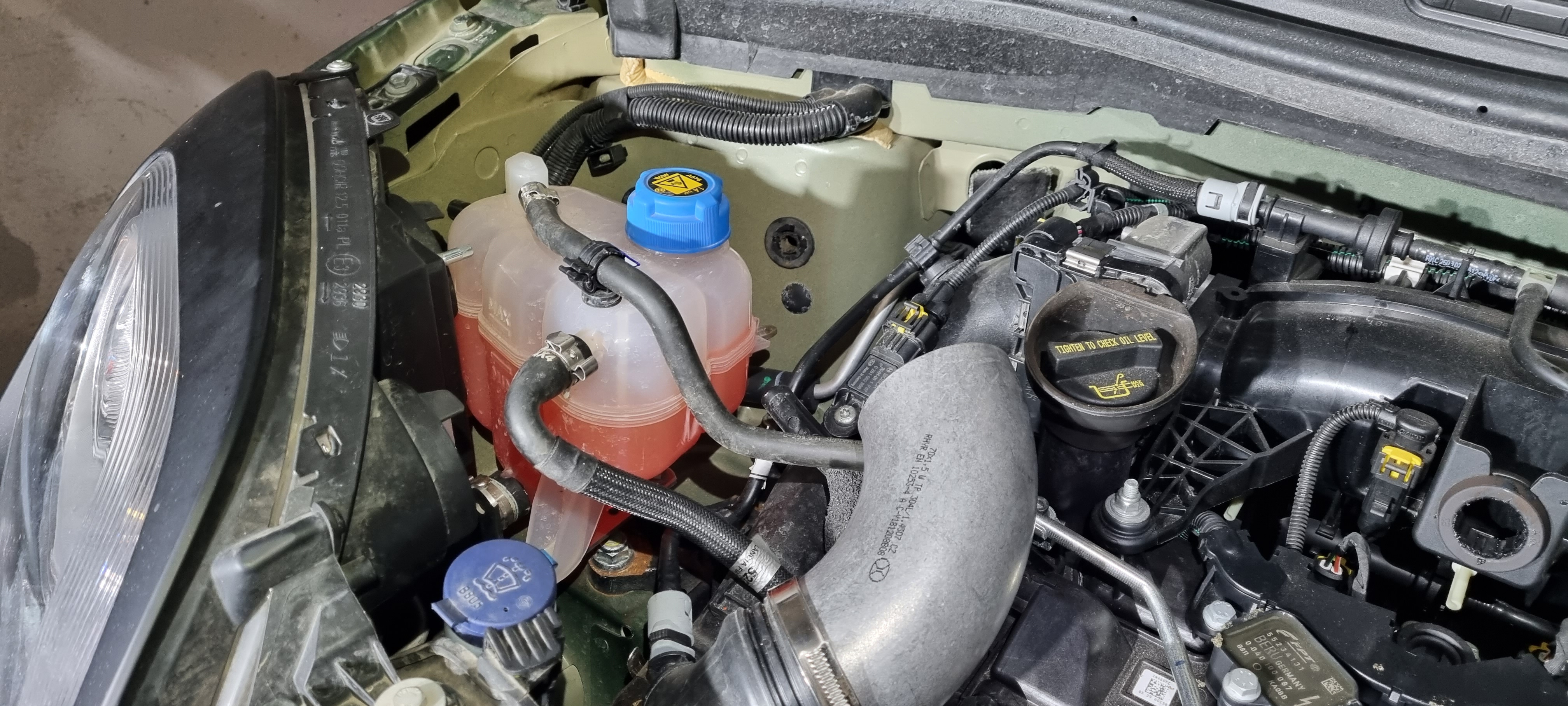

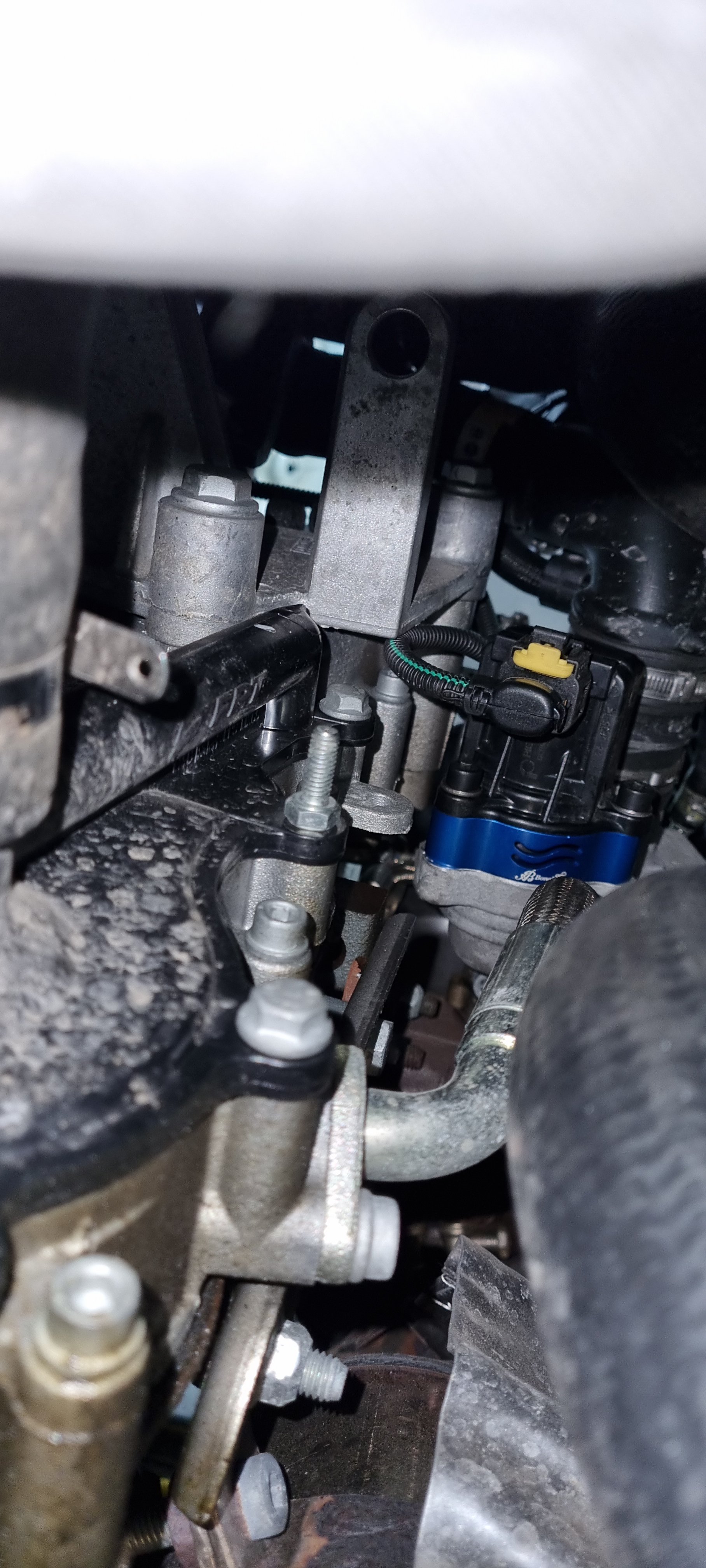

I have installed the blow off valve today, ( its from Bonalume in italy)

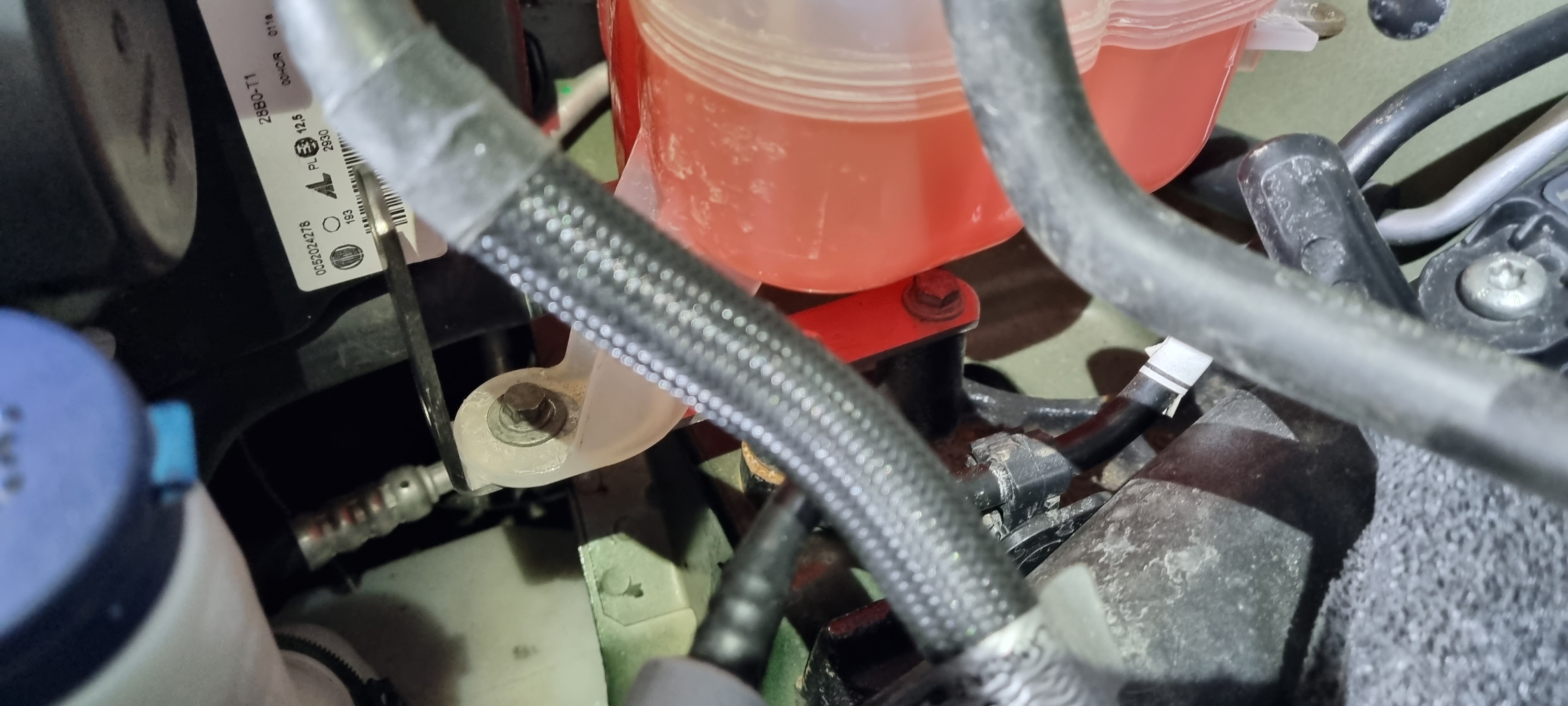

and have prepared the location for my cold air intake. I am waiting for the Ram air filter to arrive on monday.

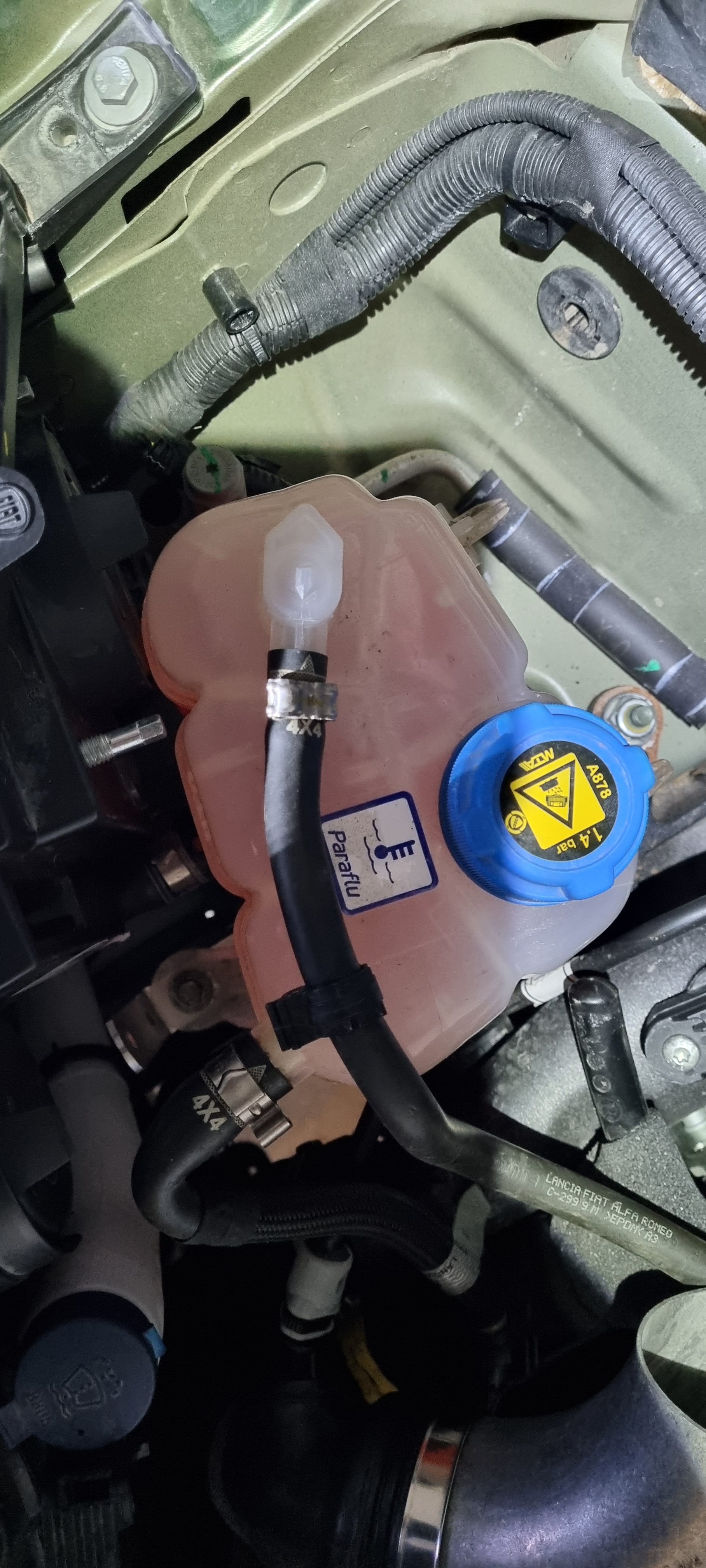

I have moved the engine water container forward using a new stainless steel bracket.
The new filter should fit perfectly up high and away from the heat of the engine ,like in some other versions.
What i have arriving in the next fdew weeks is the tyres and suspension spacers and wheels spacers..
Depending on the lift and the ride, i will decide to either keep it or order custom air shocks.. i will see how it goes.
I have attached some photos and videos.

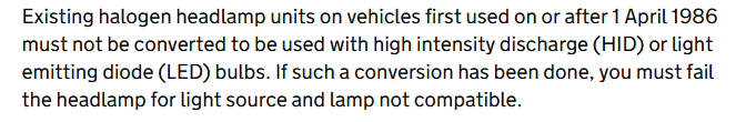

That's the biggie, unless the headlights are designed for LEDs they're no longer legal in the UK and will earn an MOT fail if spotted.

Fitting LED bulbs to a headlight unit designed for halogen bulbs is not road legal in the UK. This probably will (and certainly should) result in the car failing an MOT, and may invalidate your insurance.
From the MOT testers manual:

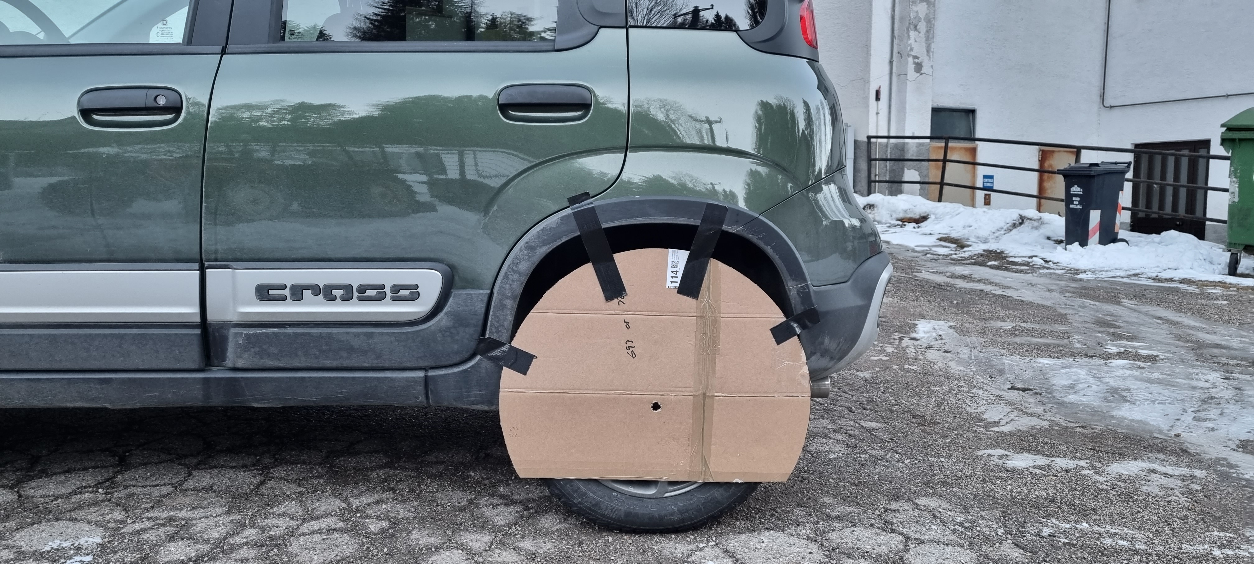

Ok the tyres i first ordered are way too big... i dont know what i was thinking... I made a carboard cutout and realised that there is no chance in hell i could fit the tyres even with a lift and cutting the plastics.. I have to wait until they are returned and get a refund and order again..
I made a carboard cut out to see how much of the plastic i have to cut for the new tyres i am ordering and its not that much.
The tyre choices i have are either All terain or mud tyres... Im think i would prefer less road noise so ill probably put cooper discoveries on..
Cooper Discoverer A/T3 Sport 2 205 / 70 / r15 or
Insa Turbo Dakar MT 205 / 70 / r15
will fit just right, with a little modification of the plastics.
I lifted the car by 3cm , same as the spring spacer kit arriving. The carboard cutout is 10mm larger than the actual tyre.
I think it will look awesome, There is 20mm clearance from the tyre and the front shock housing. With the spacers i think it will work out..
I will post in a few weeks once i receive them...

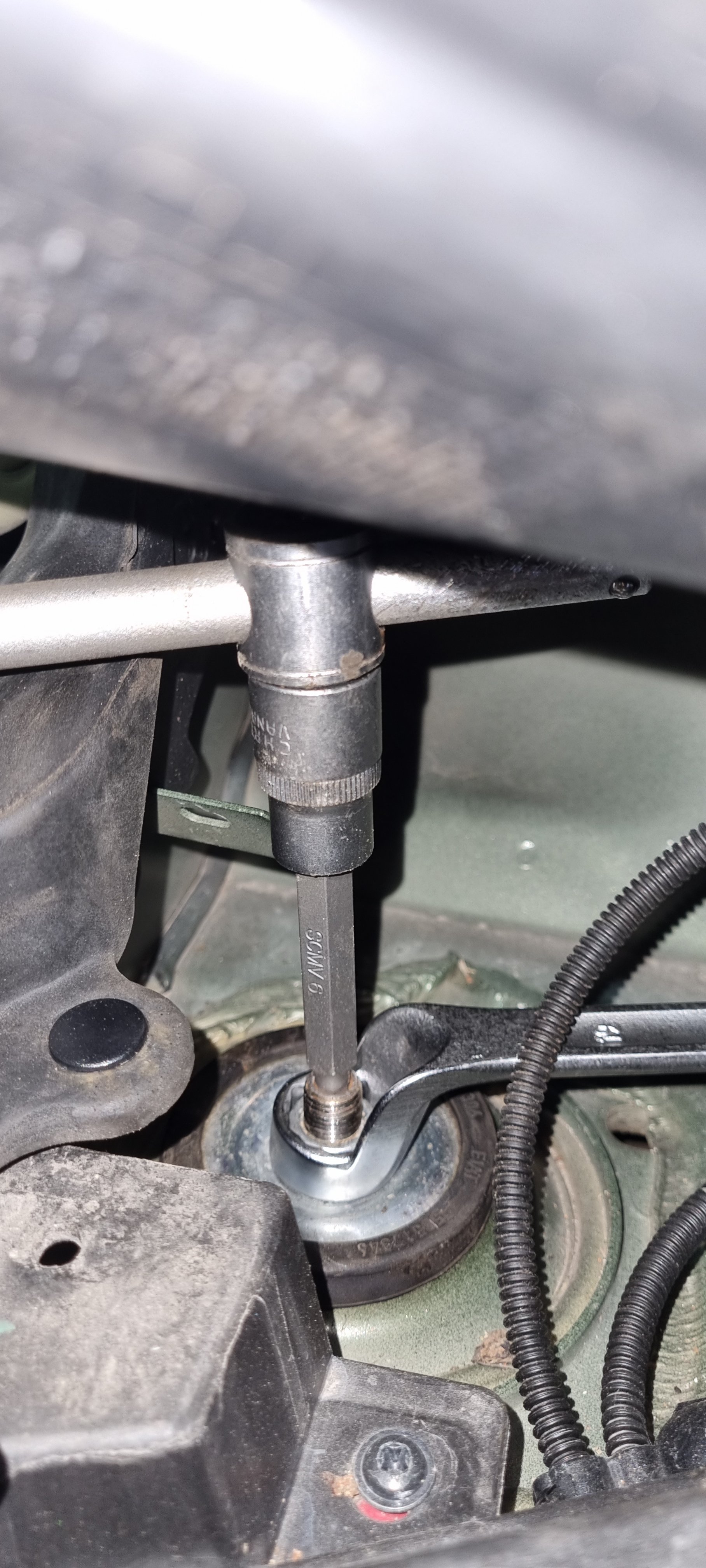

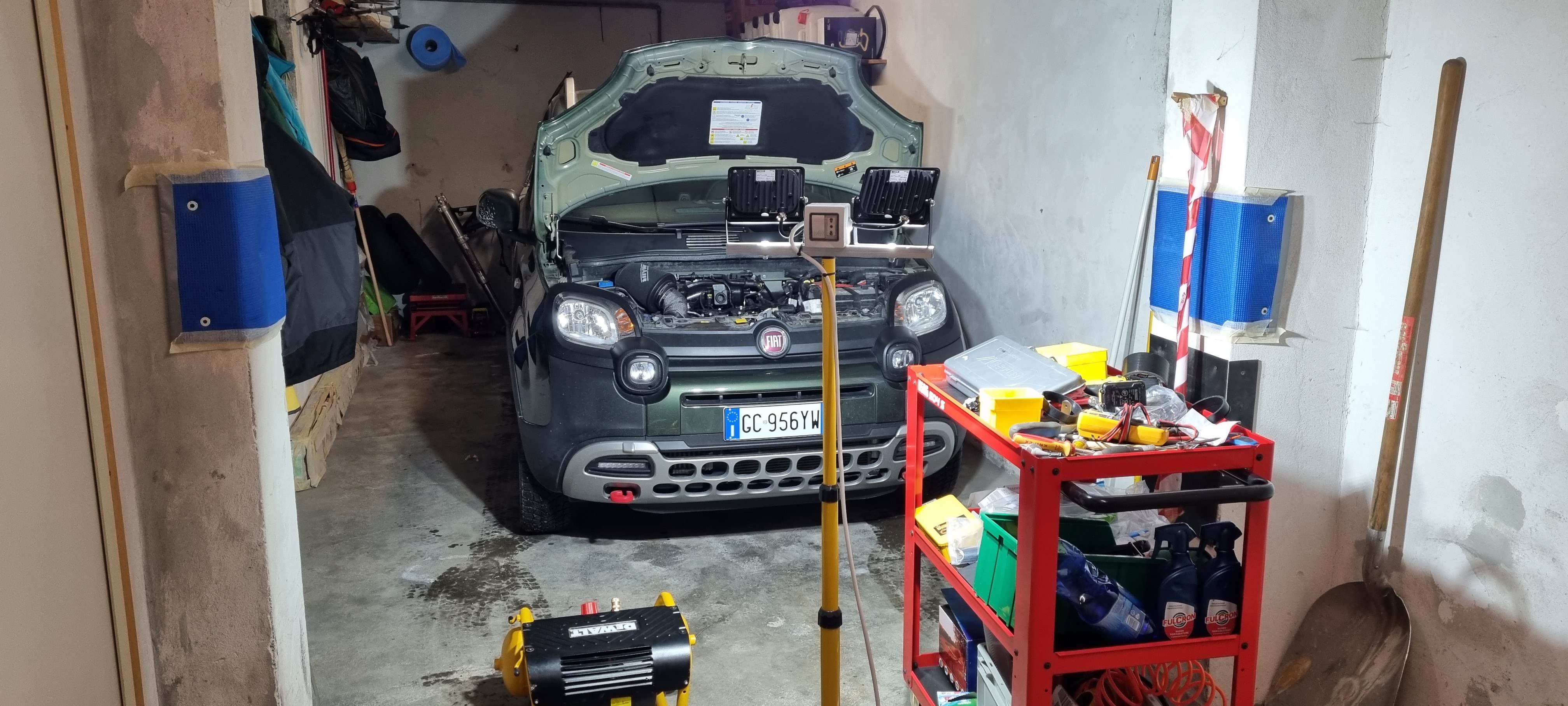

As soon as i opened the box i couldnt help myself, i went downstairs and started working on the front right shock.... It was actually pretty straight forward. No instructions were sent, and no reply from the company when i asked them for help. typical...
If anybody wants me to make a step by step video on the front left and rear left... let me know..

I used these amazing spring compressors i purchased from Amazon.

Finished the front right , and i couldnt be more happier... I measured the total height. it was 725mm.. oem was 680mm.
thats a 45mm difference... Im stoked.. tommorow i will finish the rest of the car and take it for a test drive...
