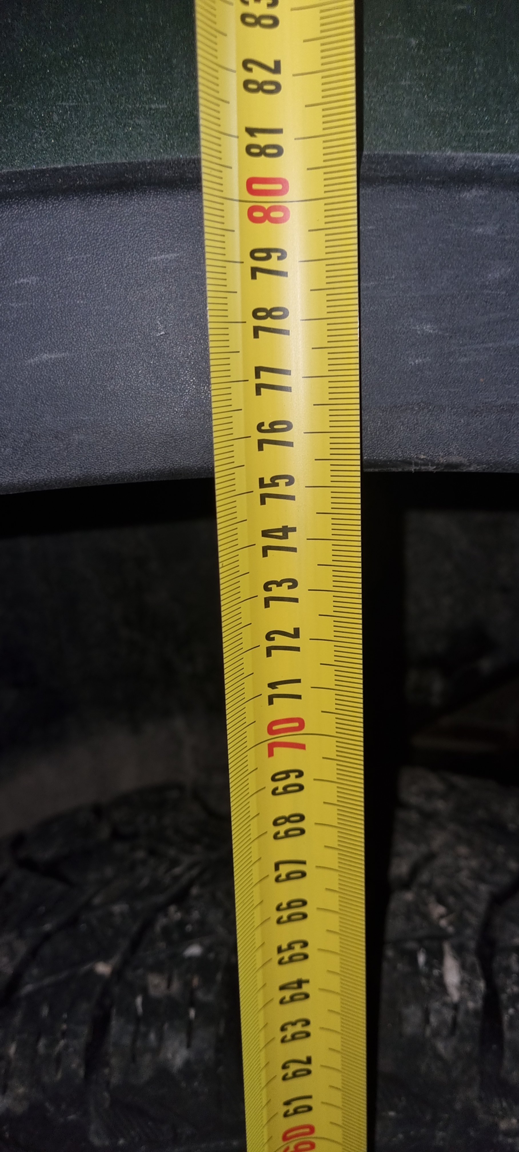

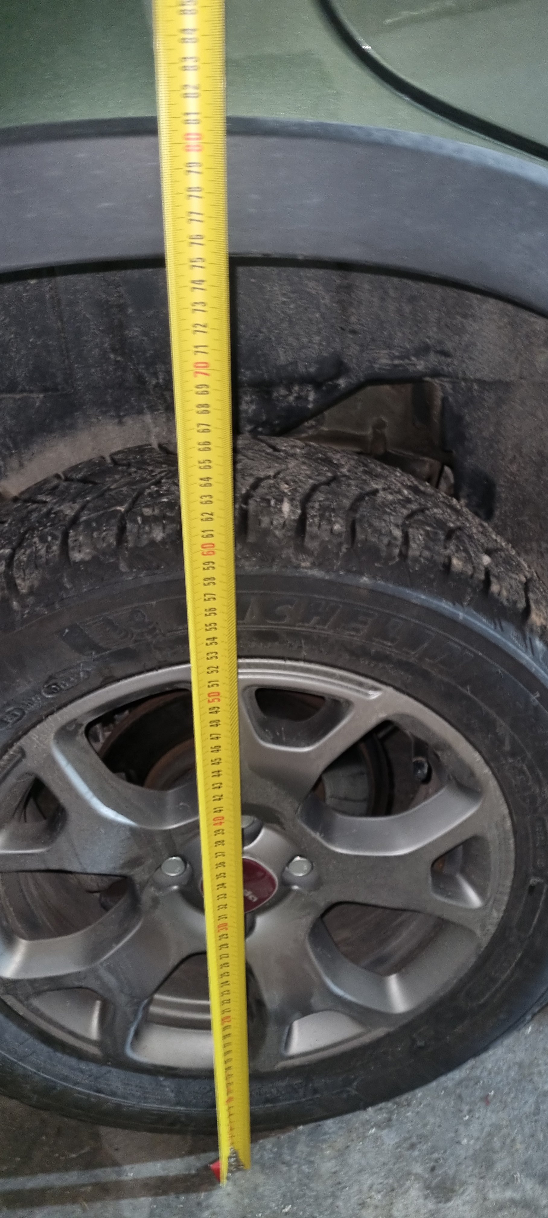

I have installed the blow off valve today, ( its from Bonalume in italy)
and have prepared the location for my cold air intake. I am waiting for the Ram air filter to arrive on monday.
I have moved the engine water container forward using a new stainless steel bracket.
The new filter should fit perfectly up high and away from the heat of the engine ,like in some other versions.
What i have arriving in the next fdew weeks is the tyres and suspension spacers and wheels spacers..
Depending on the lift and the ride, i will decide to either keep it or order custom air shocks.. i will see how it goes.
I have attached some photos and videos.

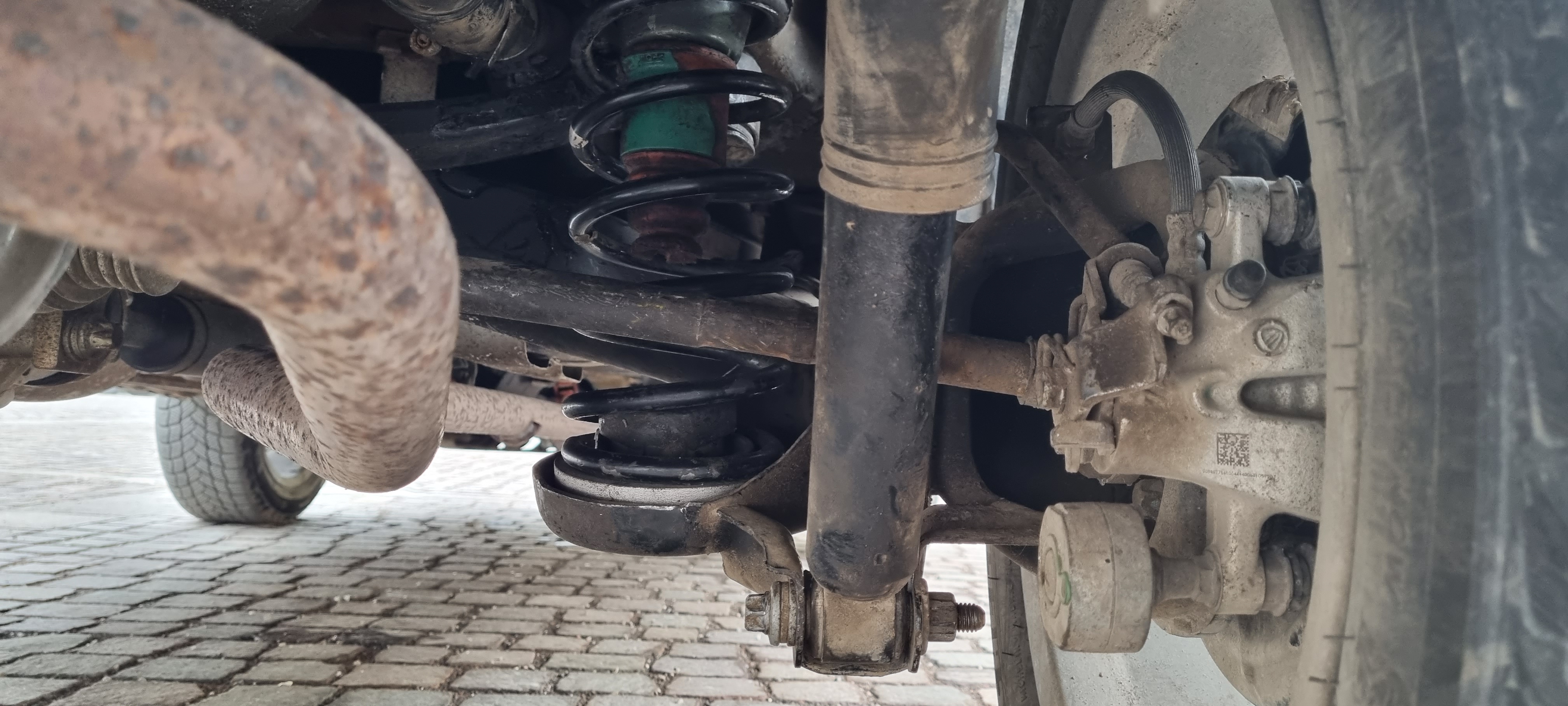

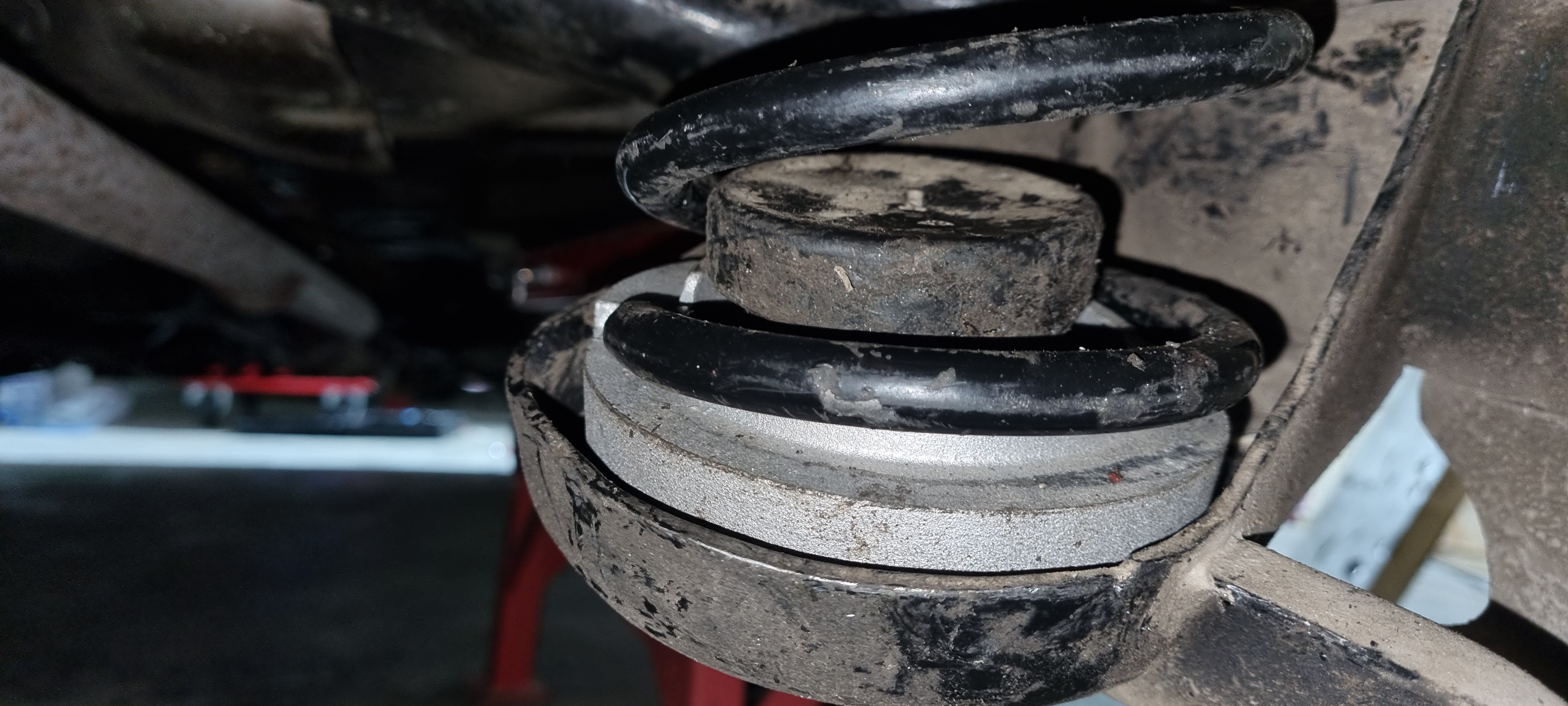

The rear springs have been a pain today, but i am slowly getting there..
I finished the lift today. It was a massive pain in the ass. But worth it . the car looks awesome.
The car handles great, and has heaps more grip. I cant wait to test it in the snow.
pictures below are of the rear suspension lift.

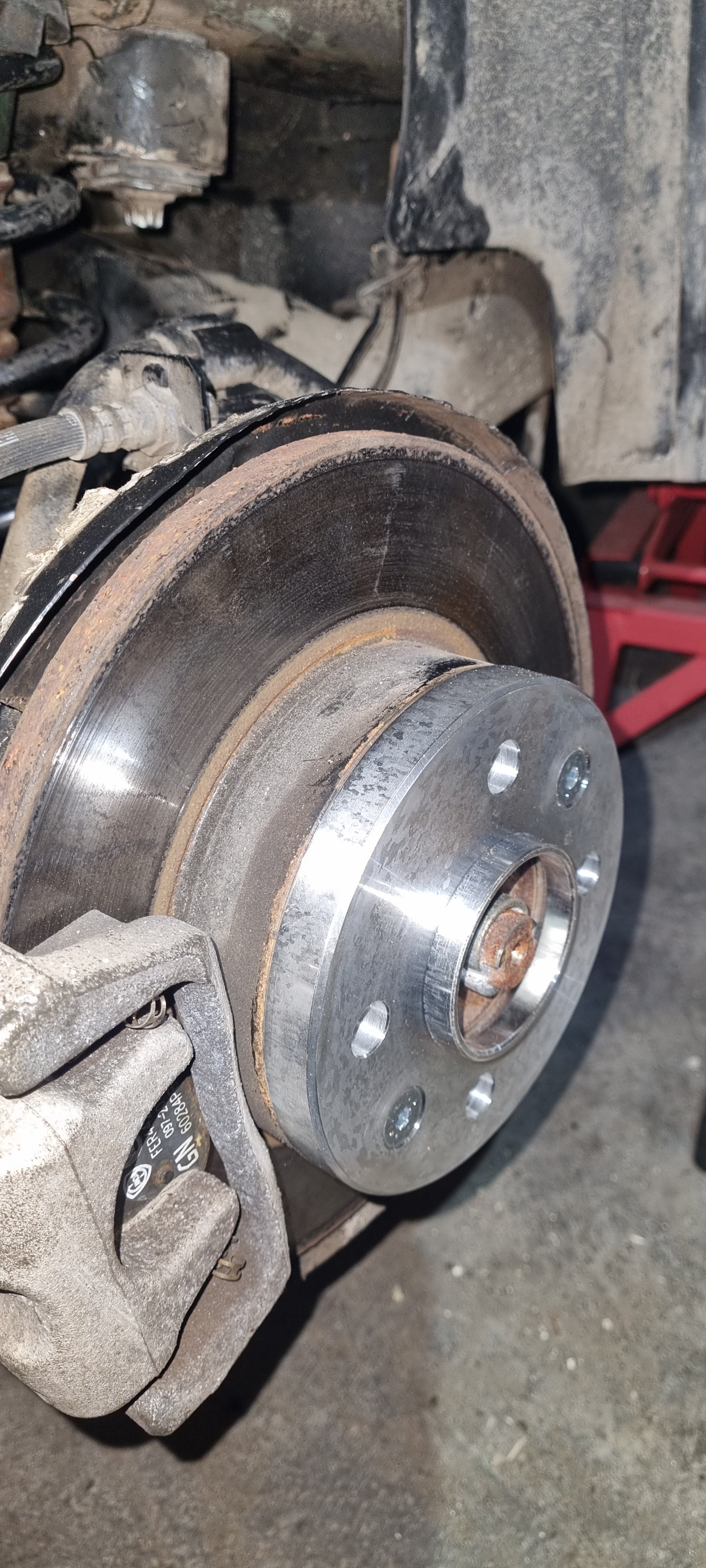

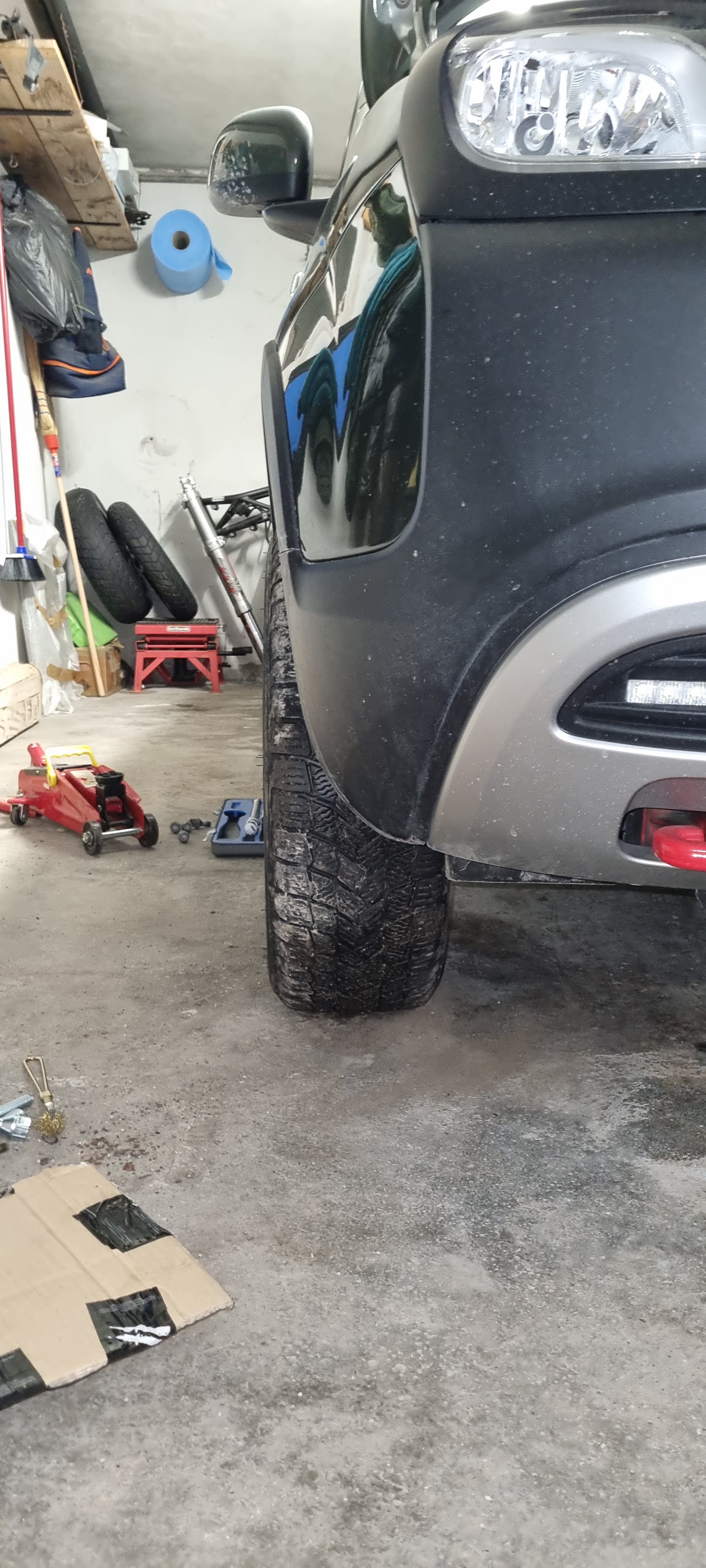

I just came back form a long drive through the mountains. My thoughts on the spring spacer kit and the wheel spacers.
I can feel the bumps allitle more, but inturn it is considerably more stiff. Less body roll and more leveled while cornering. So far i am very happy.
The extended front and rear wheel span has improved handling considerably. The car feels more balanced around corners ,and understeer is all but nearly gone. Now i can turn into a corner with confidence knowing my front tyres will not break traction before my rear. it has changed the character of the car completely. I think its the best upgrade.
Now for the issues.

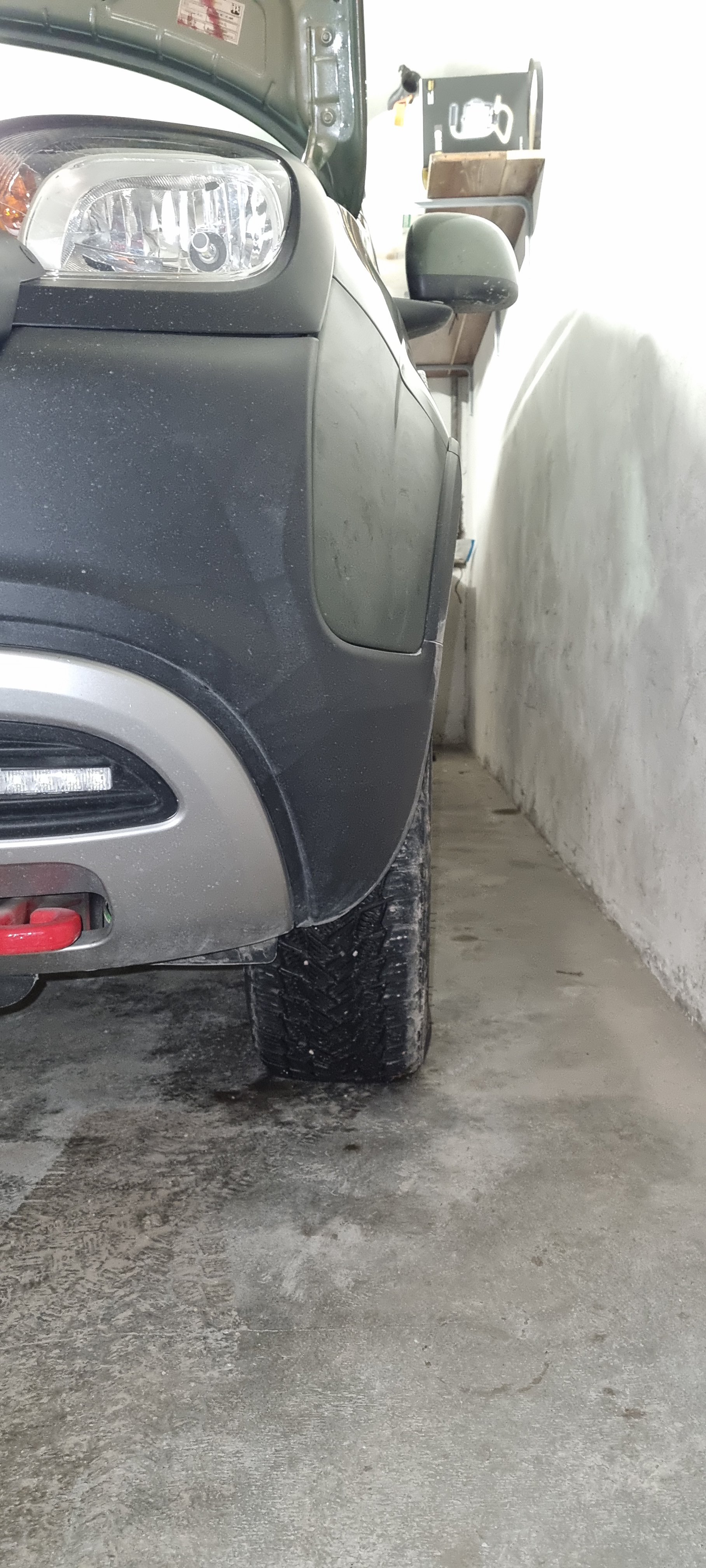

Slight rubbing of front tyres while in medium to full lock . very slight. i checked and the tyres are just rubbing the plastic. This must be becuase of the 20mm spacers. I was advised to use 16mm at the front , probably for this reason. As i am getting even bigger tyres, i already knew i was cutting the front plastics to make room, so i am not bothered by the rubbing. But for the rest who are thinking about wheel spacers i recommend 16mm at the front and 10mm at the back., This difference from front to rear should remove most of the understeer.

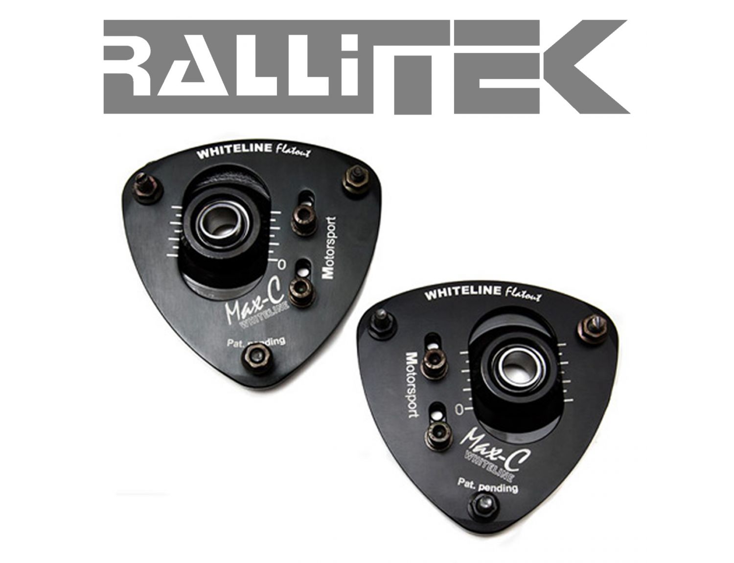

Also would it be possible to get an offset top strut mount.( or udjustable one) Wouldnt this be an easier way to get the desired camber?
Or does that only work when the top mount bolts to the chassis? like in this picture..
  • whiteline-max-c-adjustable-strut-top-mounts-sti-2004-2007-wrx-2002-2007.jpg
Glad you are enjoying the end result even if the installation was a bit of a faff. You never mentioned who you got the lift kit from though, for future reference.
As you've already stated you'll be cutting down the inner wheel arch (and possibly fenders) to fit the larger tyre size I've got one more idea for something to empty your wallet on: front camber bolts. When the McPherson strut is extended by the taller suspension the angle reverts to negative camber, and while wheel spacers will help to a degree, they're also adding an extended moment arm of force on the wheel bearings. While I was never able to find a camber adjustment kit or camber bolts specific to the Panda (at least not where I live), I've seen a few folks manage to adapt kits made for the 500 and achieve the front-end grip you (and I) desire by getting the contact patch right as opposed to the "safe" approach the factory camber provides.
Also what do you think about this?
this seems like it would work for the panda?
or are you talking about something like this ?

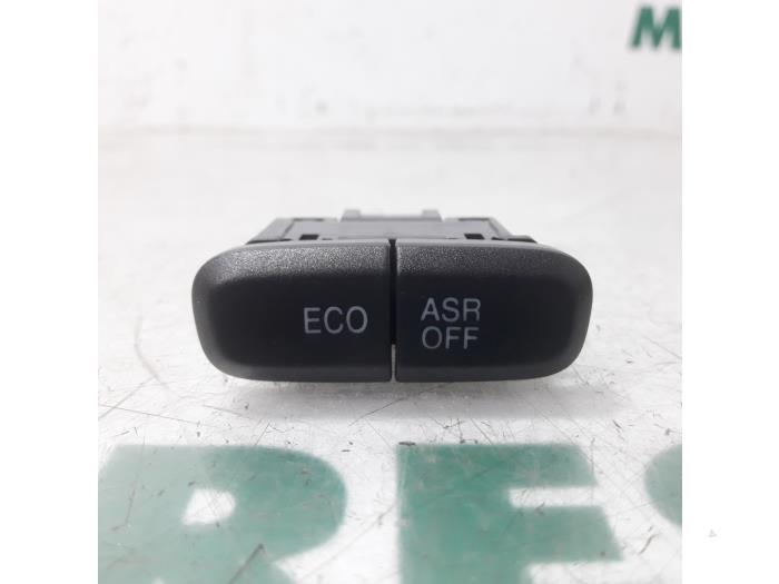

Now I would like to be able to turn of ASR. I saw that some version of Panda with twinair engine have this ability. So i found exactly this kind of switch (see attachment; stock one have only ECO button and second one is blank). I've installed it. After turning key to ACC it is recognized (the light on it blink for a second) but after pressing it nothing happens. What is strange, the ECO swith is working as usual.
Can you provide me with any help? Thanks!

I have the Cross model and i have a drivetrain selector under the gear stick, when engaged it removes ASR (traction control) up to 50km/h. Im sure if i added the switch like yourself it would not work. It must need to be programmed into the ecu. Who knows.
I wanted to remove traction control aswell, I was about to sel lthe car, but some lovely people on this forum advised me that my drive selector removes ASR when engaged in all off road mode... it doesnt turn it off completely but enough for me to slide the car in the snow and have fun.
Thanks for an answer.
Yes, I know that offroad mode disable ASR but i want to disable it without engaging rear drive.
I suspect that it needs to be programmed but I'm wondering how. I've already enable menu option to turn off DRL via AlfaOBD and OBD bluetooth interface so I thought maybe there is an option to activate this button also.
