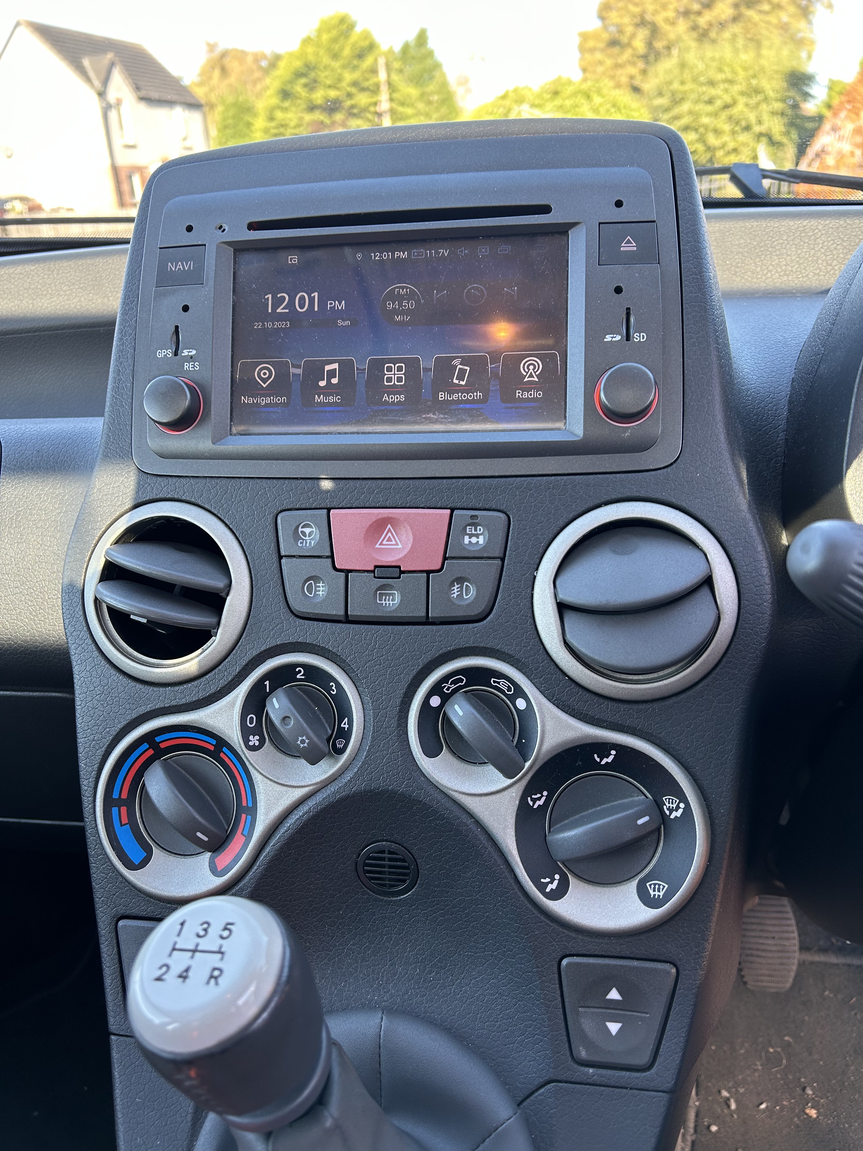

My Panda 169 4x4 doesn’t have an auxiliary position on the ignition switch It’s a bit of a nuisance because I can’t listen to the radio unless the engine’s running. Is there a way I can adapt the wiring?

It’s not factory and I don’t even know the brand. It’s very good though, touch phone reversing camera etc.
It’s the ignition switch that I can’t understand.

It has been wired in wrong.
The new radio will have standard DIN plug for power. That expected a permanent live, and a switched live, plus earth, lighting, speed, an output to electric aerial and earth.
The car will confuse this, by having a permanent live and earth, plus two tiny wires for the data, as the car communicates using Canbus.
The radio is not coping with whatever is connected,so is not giving you the 'On' without ignition.
Correct wiring would include an adaptor, trying to hide somewhere behind the unit, that acts as interpreter between the digital car signals, and analogue expectations of the radio. That would give you the speed signal, if the Nav in the new radio needs it, and a lighting input, to perhaps dim it at night. Fitting is fiddly, and sometimes difficult with limited space. An alternative, mentioned on here often, is to take a switched feed from the 12v socket.

I removed the set and found a single wire where it gets the power from. As you say it should get it’s power from the harness, so I’ll see if I can sort it tomorrow.
