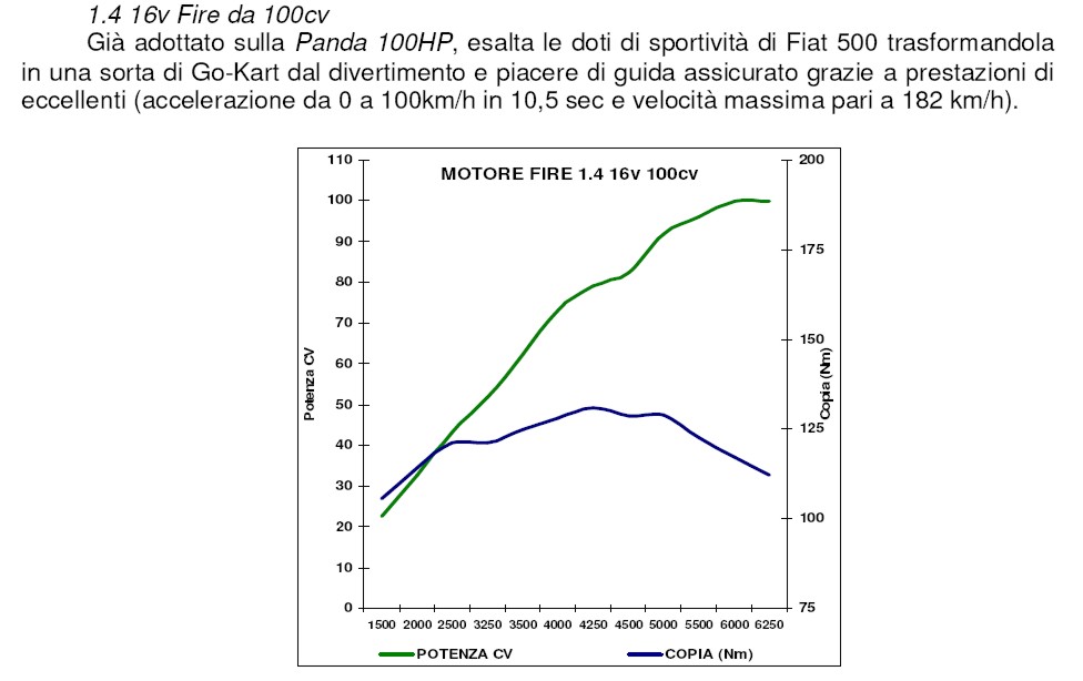

I've no idea about the differences with the 'sport' map, but this chart is from FIAT's original press release for the 500:

Scwenck, that Fiat graph I would guess is plotted from 6 or 7 data points rather than continuous figures like the magazine plot. Through the arse you can feel there are definite steps in the torque curve.
