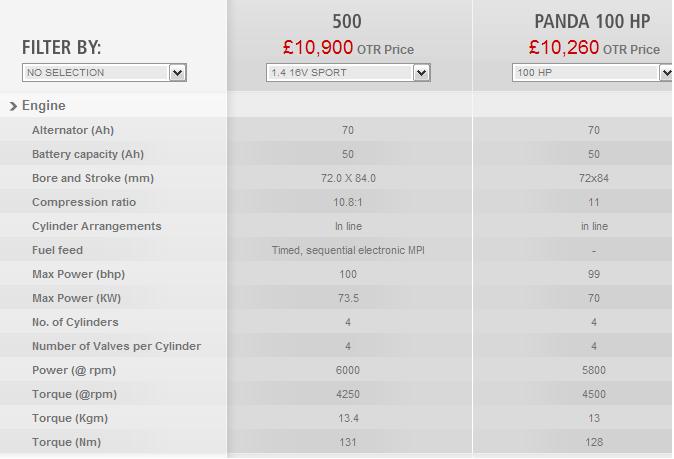

No, 500 is not VVT. It is a standard 16v FIRE engine. Same capacity, same CR, same quoted output at same rpms....

Fiat begs to differ:

Finally had use of a 2007 ePER. The 500 does not have variable valve timing, just shows you shouldn't trust some sources....
According to my parts cross referencing between a 1.4 500 and a Panda HP, they share:
Inlet and exhaust cams
Pistons
Crankshaft
Cylinder head and head gasket
Valves
They differ with:
Conrods
Intake manifold
Throttle body
