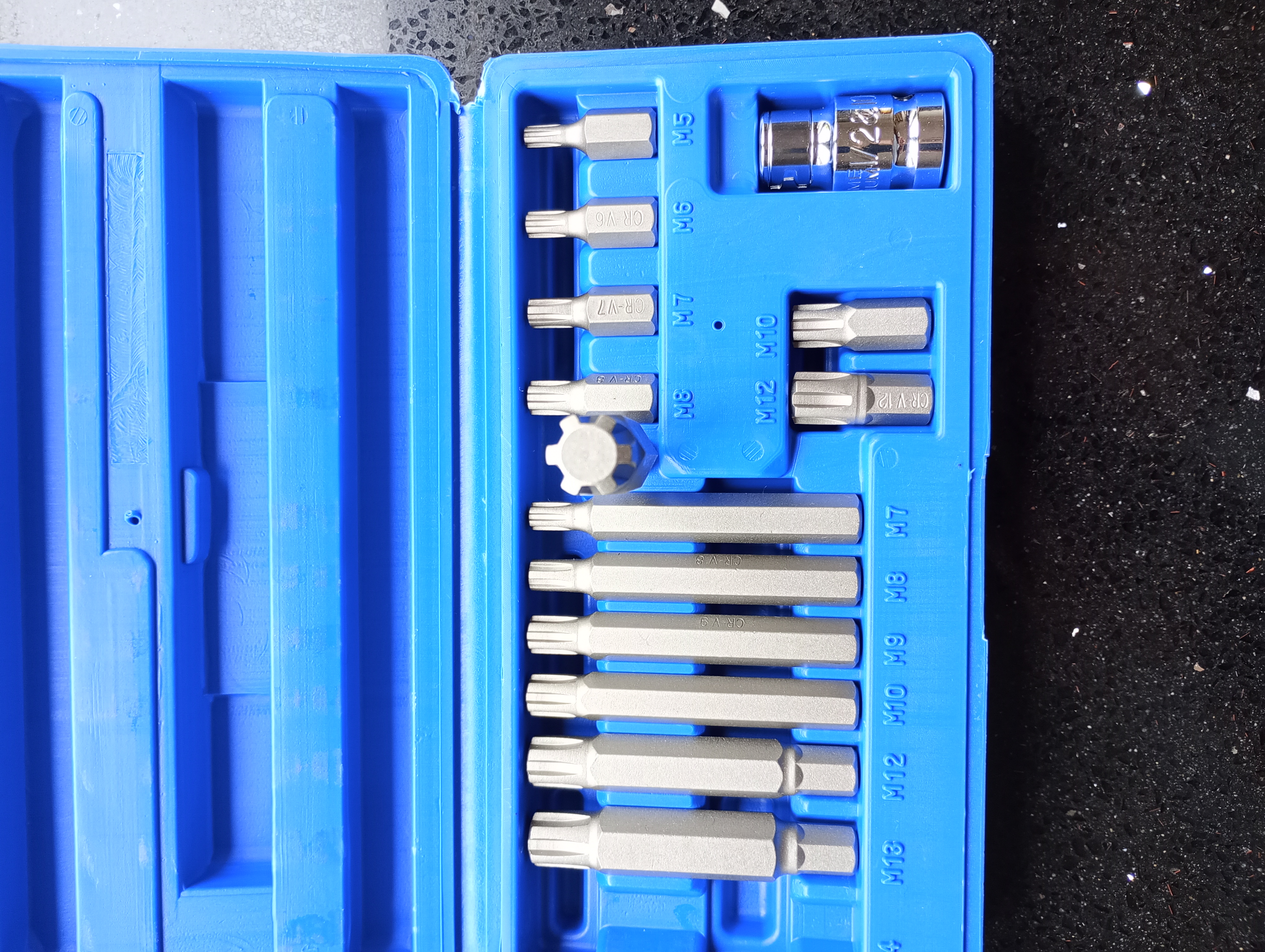

I now need to find a splined tool for the cylinder head bolts. Haynes say that they used a close fitting Allen key but I would like to get the correct item. Couldn't find one on eBay so may try my local Fiat dealer. Haynes said they are not expensive but we will see!

Bolts are Ribe you can buy a set such as the laser ones for around £10 just make sure they are long enough
If you want to buy an individual one, unfortunately I don't know the size, different fiat engines have different sizes and the information on the internet isn't reliable, in fact on here I can see it listed under two different sizes
I'd not heard of Ribe fixings before. I must be out of date with these things. Rather than follow the Haynes Manual suggestion of using a close fitting Allen key on the head bolts I bought a set of Ribe keys on eBay M5 - M14 for a tenner. A 6mm Allen key did fit but not as snugly as I would have liked and it's the last bolt you want to screw up!
You would have thought that the Haynes workshop would have Ribe keys but maybe they're a bit out of date like me!
Ribe ? Never heard of them before, they look like torx to me but their obviously not.
Is that a can of worms I can hear being opened. :D
You can see from the upended Ribe bit in the centre that they're quite different from torx bits. I can see why Haynes said that an Allen key should do the job but I wasn't going to risk it on a head bolt. This set cost a tenner from eBay with freepost so very inexpensive.
Not really
There's dozens of different systems in use such as triple square
But I normally only see three
Fiat generally use Ribe
VW and Audi generally use polydive
And more generic parts are torx
There's a bit of leeway if your desperate, especially in countries where supplies are difficult
It always better if you can to use the correct bit as it reduces the chance of slipping or splitting the head, and here in the UK their readily available
I used my set of Ribe bits to remove the ten cylinder head extension bolts (Ribe M8). I loosened two of the cylinder head bolts (Ribe M9) but the Ribe bit fractured on the third bolt as they were extremely tight! So I've bought a replacement bit and the eBay description says it will be Draper, Sealey or Franklin (not heard of the last one). So the job is again on hold awaiting the bit.

Anyway, for anyone with a 100hp Panda you might want to record somewhere that you need Ribe M8 and M9 for cylinder head removal.
