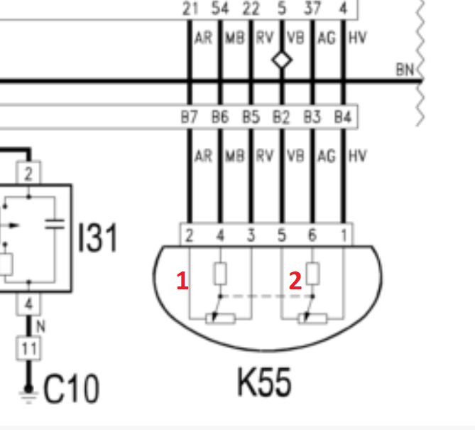

I had a quick look at the connections and they looked okay - is it worth getting a wiring diagram and testing point to point resistance to check cabling?
First code is a mismatch between track 1 and 2 (k55)
this is the diagram for the silio which has very similar wiring even the fuses have the same numbers
unfortunately the diagram for the panda appears to have the pedal missing
the thin line above it is a connector (b7,b6) in the engine Bay somewhere. Should be able to find it if you follow the big bungle of wire that come into the engine bay behind the glovebox. and the bit above that is the ECU
