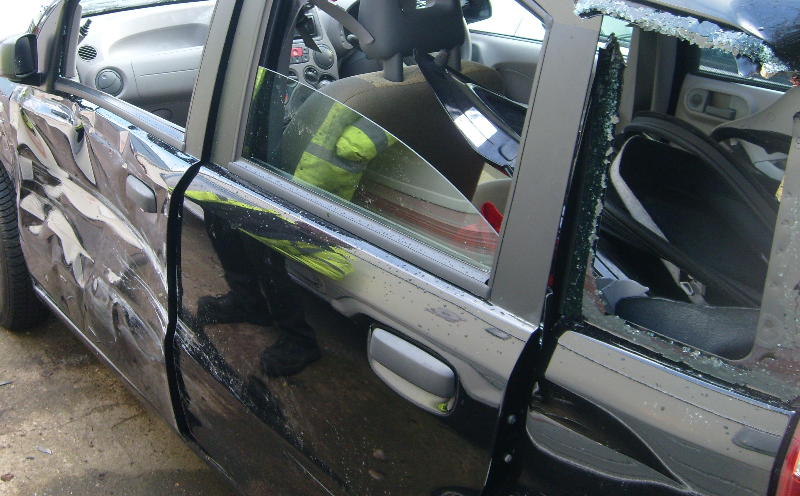

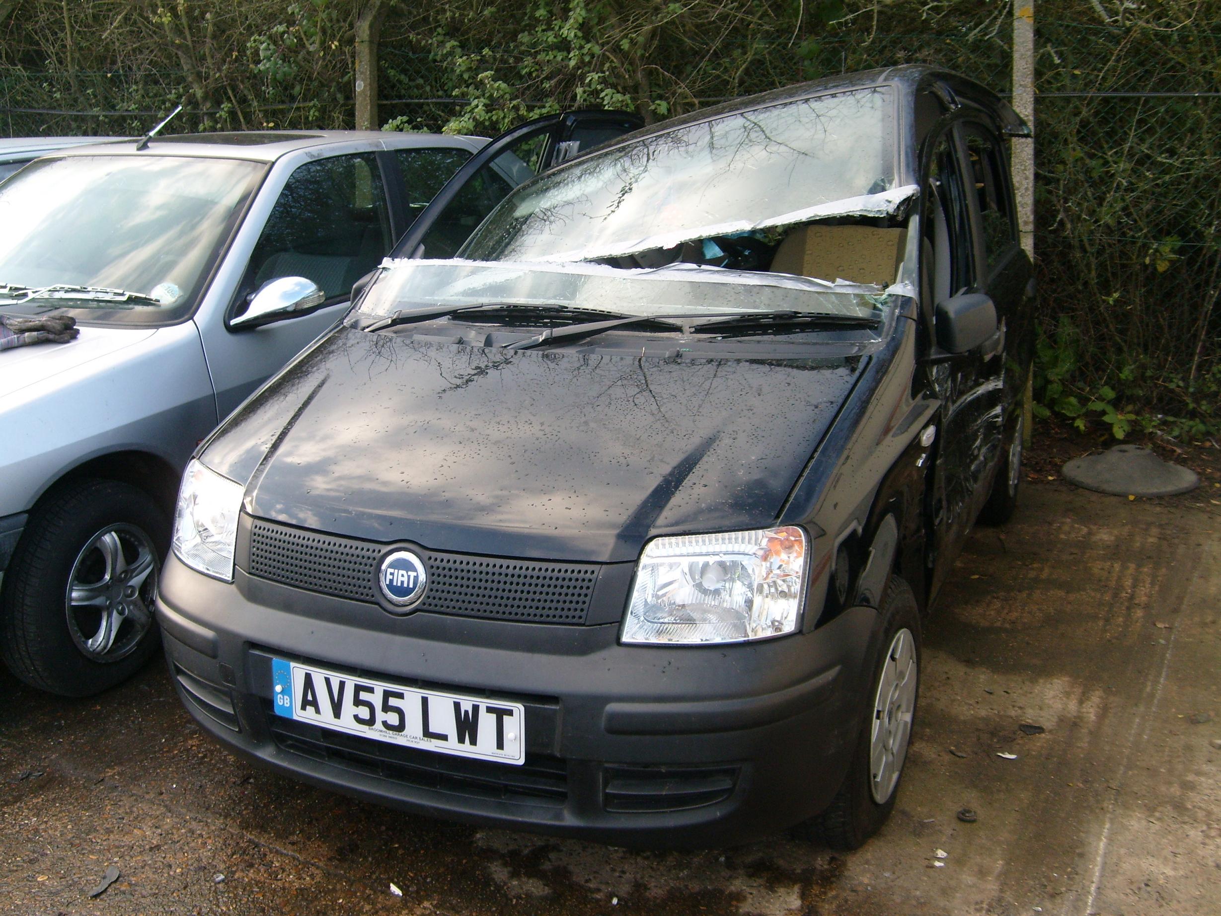

Just before Christmas in Bradwell. One of Yarmouth's finest policemen decided to go into the side of it on a roundabout. Funnily enough we got a call from the police a few days ago saying they won't be taking things any further and the blame lies 50/50. :rolleyes:
On one hand we want to fight the bas***ds so they admit 100% responsibility but I don't fancy the idea of taking on the police.
The accident itself wasn't that bad, one side quite dented but possibly repairable as the car was only 4 years old with 17k on the clock. After the crash the copper told my wife to sit inside the car with the heater on until the ambulance arrived - good advice you might think? (y)
She started to complain of back & neck ache so the firebrigade cut the roof off the car to get her out. Turned out to be whiplash.
