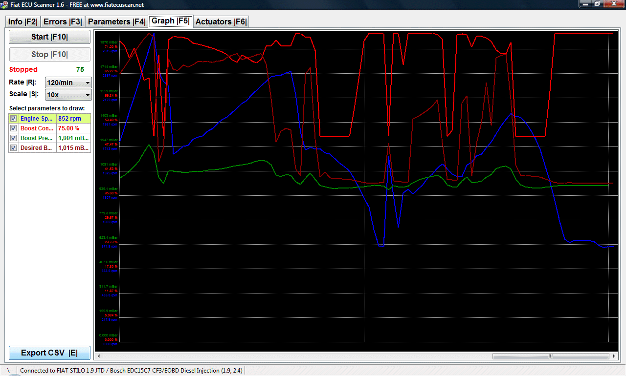

This time it was an instant fault light whilst just doing a steady ~70mph in top and the scanner showed a P0236 with 'low signal' and although it cleared ok, it came back a couple of days later on the same stretch of road. I did the usual connector checks and tubing leaks, but nothing obvious. However, watching the little actuator rod on the turbo showed it not moving at all when the engine was revved and by the looks of wear marks it was "not on" at all - which may well account for some sluggish performance that i'd just gotten used to :eek:
Just to confirm my suspicions, I did a short run with the scanner monitoring RPM, Boost control, Boost pressure and Desired boost pressure. It confirmed that the actual boost pressure wasn't hardly moving on my 1-2-3-4 gear change to-end-of-road test and so differred greatly from the desired boost level.
I took the plunge and got a new boost solenoid - what a difference :D The new boost level now tracked the desired value with a bit of lag and the car was transformed as you can imagine. A quick check of the turbo actuator showed it now moving when revved. I've done a couple of screen captures attached of the before and after runs for info, incase anyones looking to compare.

When I put the ecu scan on the car, the desired boost pressure and the acctual boost pressure looked very similar to the first graph above so i'm now assuming the boost solenoid is the problem as with yours Ics19.

You might find that some of the ECU Scan info is a bit misleading - especially the desired boost pressure - even after changing mine, it rarely reaches the desired figure - but I still have excellent boost/performance. You say yours has a fault at the same rpm - does this coincide with anything else? Mine would do it on a certain stretch of road going uphill, which if you immediately lifted and reapplied throttle would clear itself.
