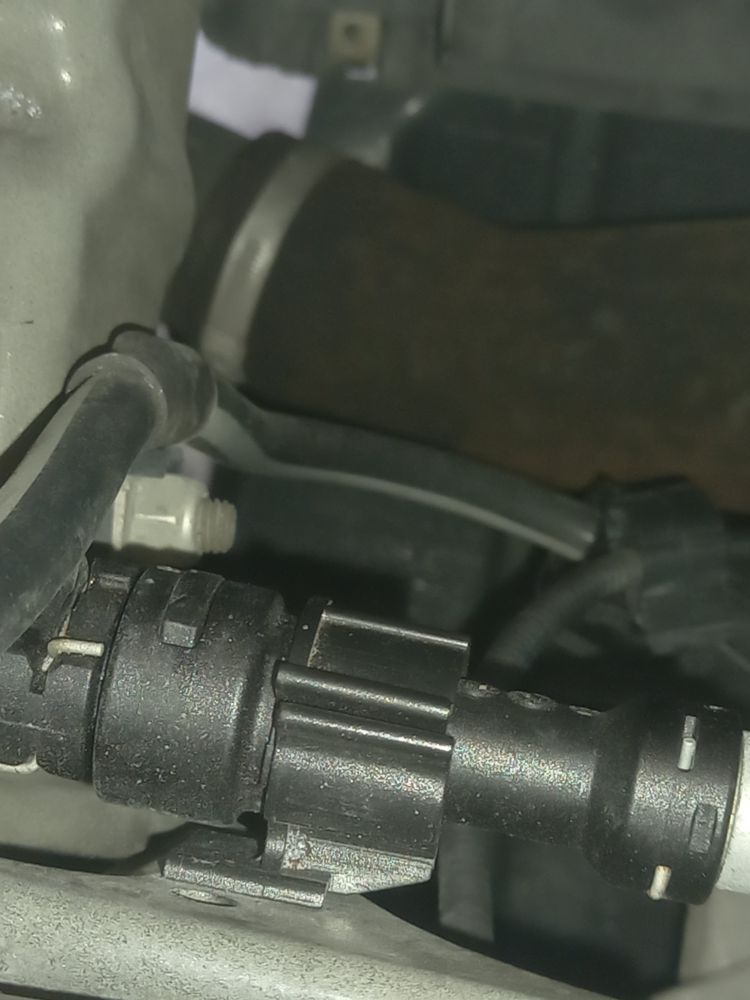

The main earth on the panda runs from the battery negative terminal to the left chassis rail then onto the top of the gearbox
Same as mine ehehe
