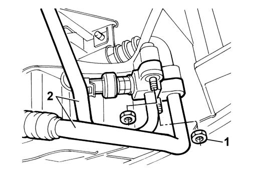

OK Air con pressure stat.
The fact your pressure resistances don't look right ( but bear in mind figures will be different with it connected and gas pressure pressure on it but should still add up ie A+B= C every time) and as soon as your connect yours the 5v rail system collapses shows a failed component there
I had a look back at my receipts and I bought one for Stilo 1.6 in Jan this year Part no 0051768498 price £39.47 inc VAT.
It's very easy to change, easier than changing a spark plug except you need to get underneath the car. Just disconnect the electrical connector, undo the sensor, be prepared for a slight psst of gas and then fit the new one. Easy as that
