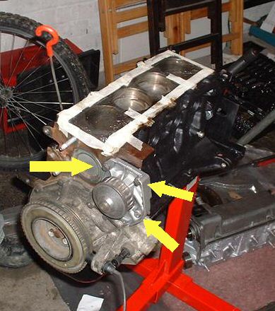

that is a funky picture (y)
Removing the water pump is easy. Couple of bolts / nuts hold it onto the block. I think there are four in total. Picture shows roughly where 3 of them are.
You will need some sillicone based gasket sealing stuff, when you get the new pump you will see a small lip round the edges of it. Put a thin bead of sealant into this. Then stick the pump on, and tighten the bolts down to 8nm and the nuts to 10nm.
Timing belt does not auto adjust the tension. That is handled by the tensioner. To set the tension, you need to loose then nut holding it in place and then twist it - you'll see what i mean when you are working on it.
Correct tension, you should be able to just twist the belt 90degrees when held between finger and thumb on the belts longest run.
