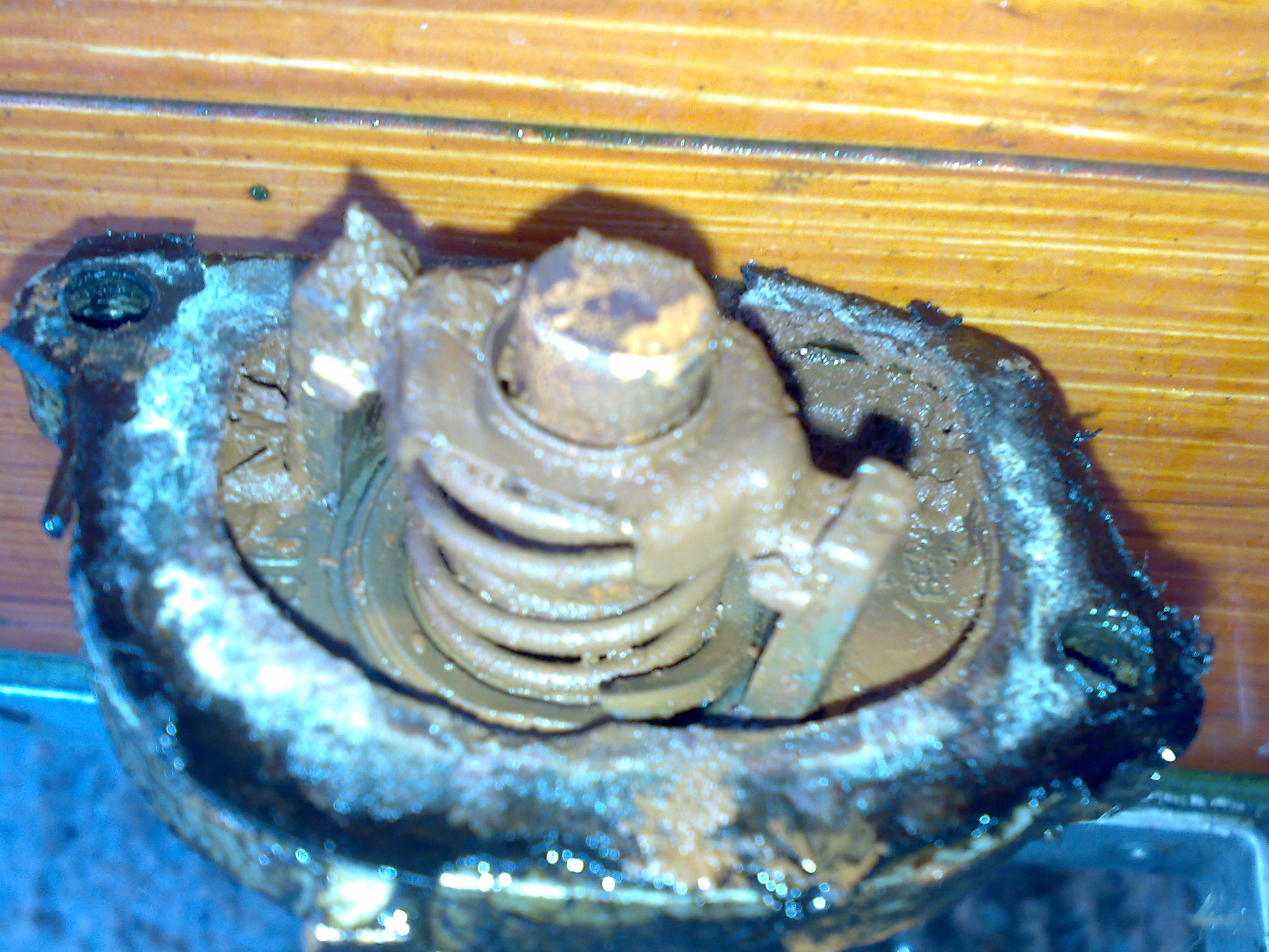

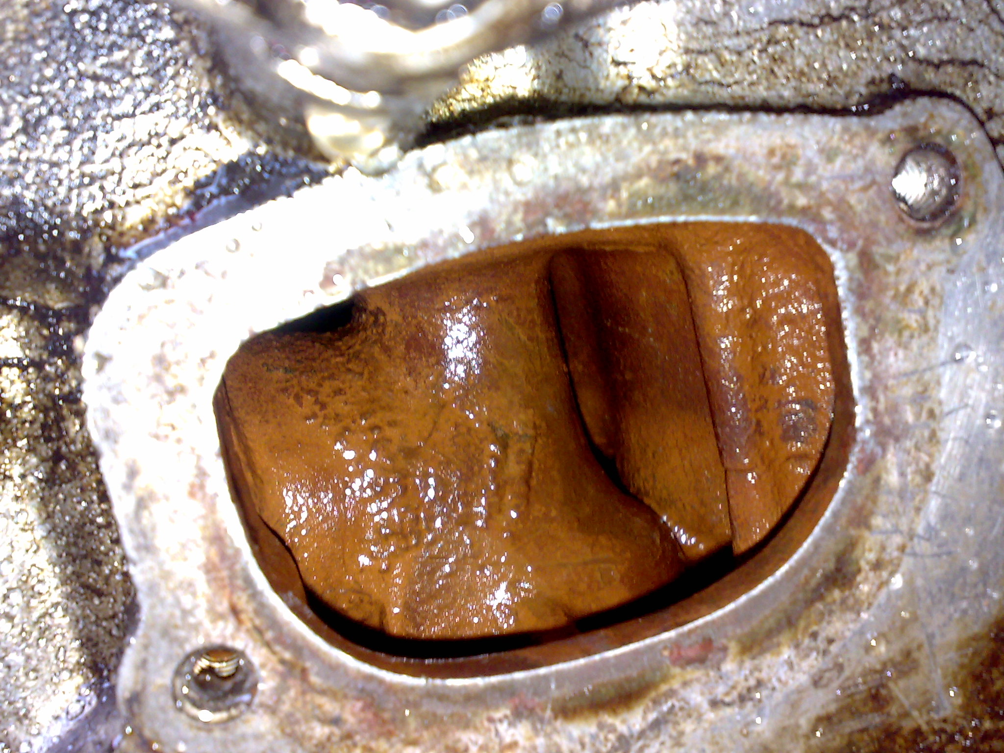

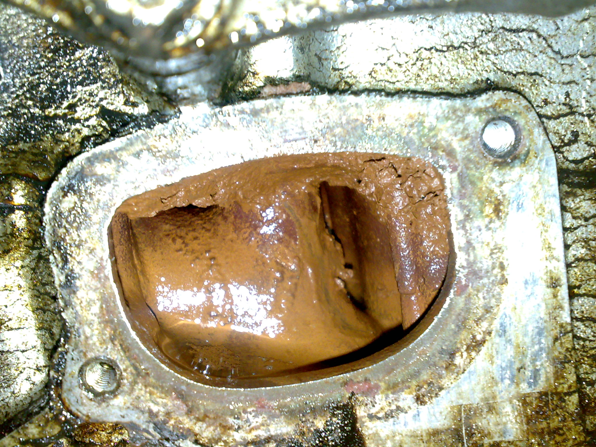

Iv recently flushed mine, theres still a considerable amount of rubbish in there after 2 full rad flushes (using the additive) and pumping some 300 litres of water through the engine, got one more water pumping session till the water runs clear again and im calling it quits, using a camera I took some shots into where the thermostat is bolted, and it is covered in 'orange' gunk that used to be antifreeze.
I can post them if you want them for comparison?
Exact symptoms for mine were initially a guzzling of fluid and overheating quickly in traffic (found to be a failed thermostat gasket allowing coolant out, air in but not enough to stop the system pressurising).
This lead to the radiator being full of air and some 3 litres of coolant needed to top it up to be suitable for running.
All was fine for another couple of months then the symptoms started coming back so I stripped it into as many pieces as possible and flushed vigorously; cleaned off the oil and grim and smoothed off the mating faces with wet and dry and applied an instant gasket product that will form to fill the gaps and all is fine now running on the correct mixture I arent losing any fluids.
Airlock removal tip: if you cant get fluid into the heater matrix but have got 3 litres in then move the car so the radiator is above the heaters and allow gravity to fill the heater matrix through removing the bleed screws and topping up until fluid comes out and use the squezzing top and bottom tubes to help shift air.

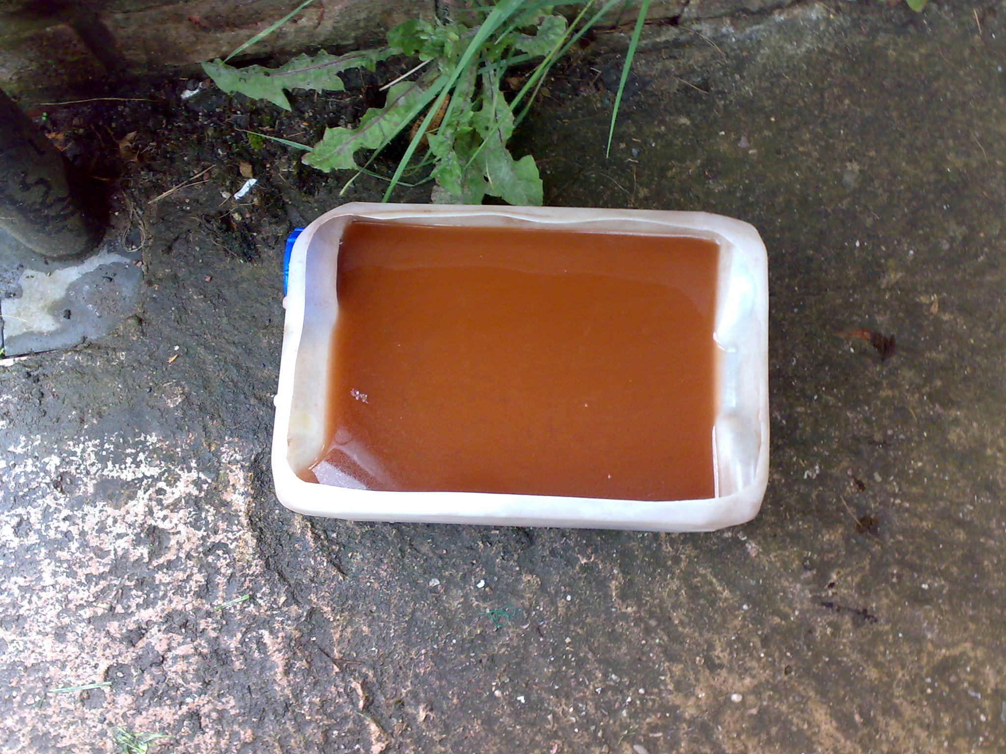

The round container is from the first emptying of the coolant system. The car has no record of a coolant change ever, so I can only assume that the original coolant had just been topped up and up till I decide to tackle it. The thermostat picture is what it lookde like after washing it off in a bucket (is alot cleaner now) and the square container is what the first rad-flush additive bottle loosened up out of the engine after flushing as much out with water as possible, the thermostat gasket view pictures are after flushing with water then after the first rad additive flush (the darker one was taken at night).

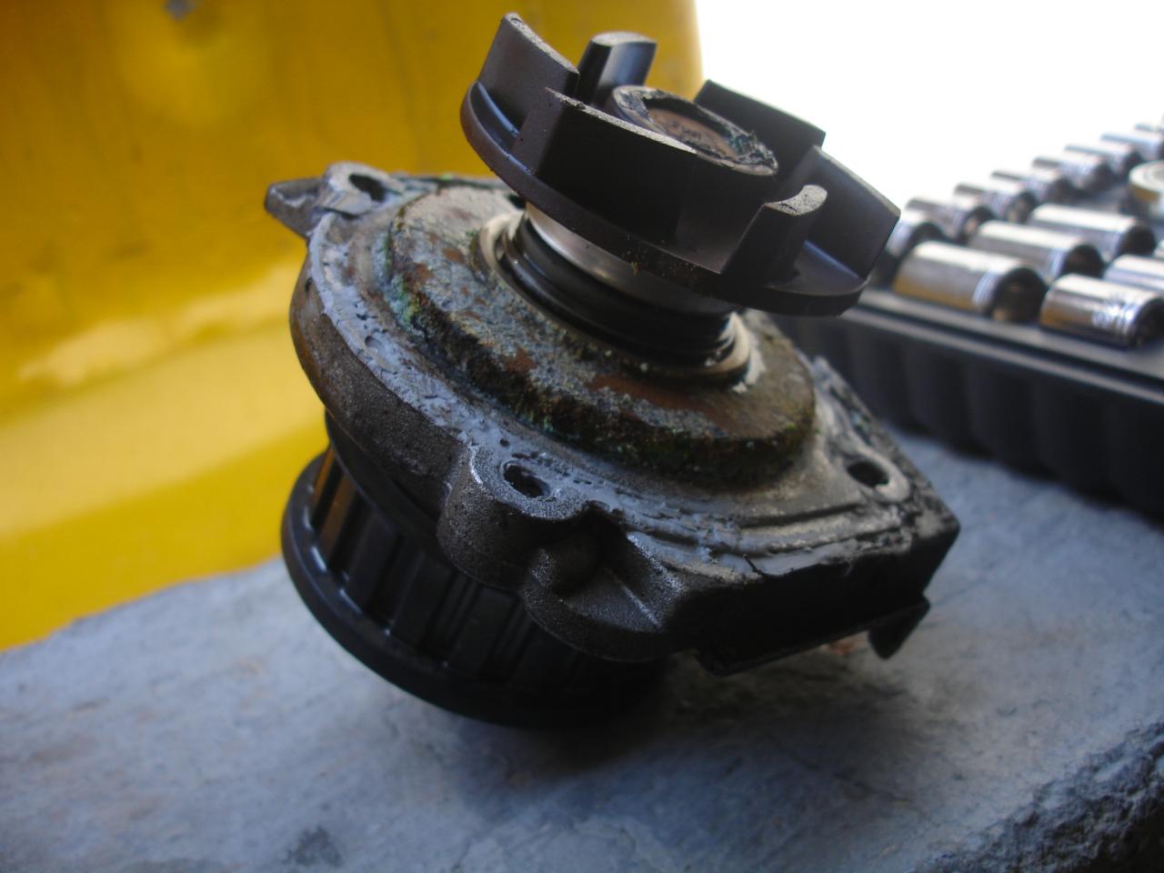

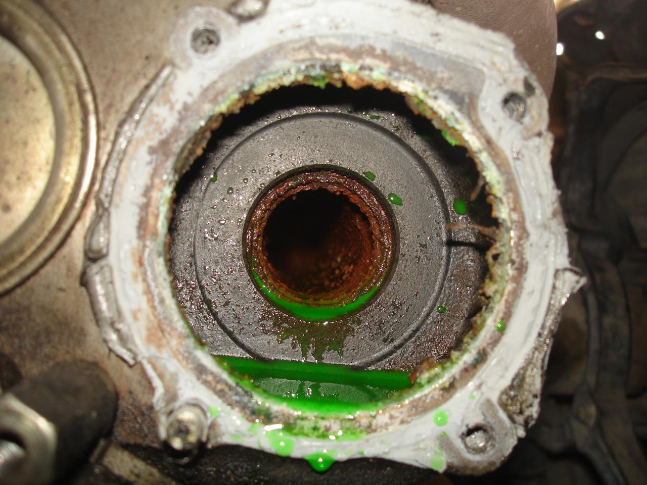

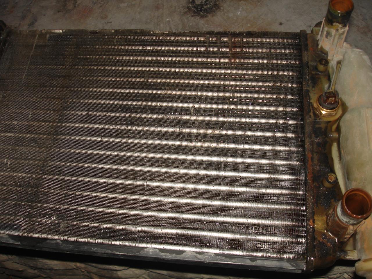

I also have some pictures to share. The first one is old radiator when I took it out to do some flushing with water. And other 2 are from water pump change.
