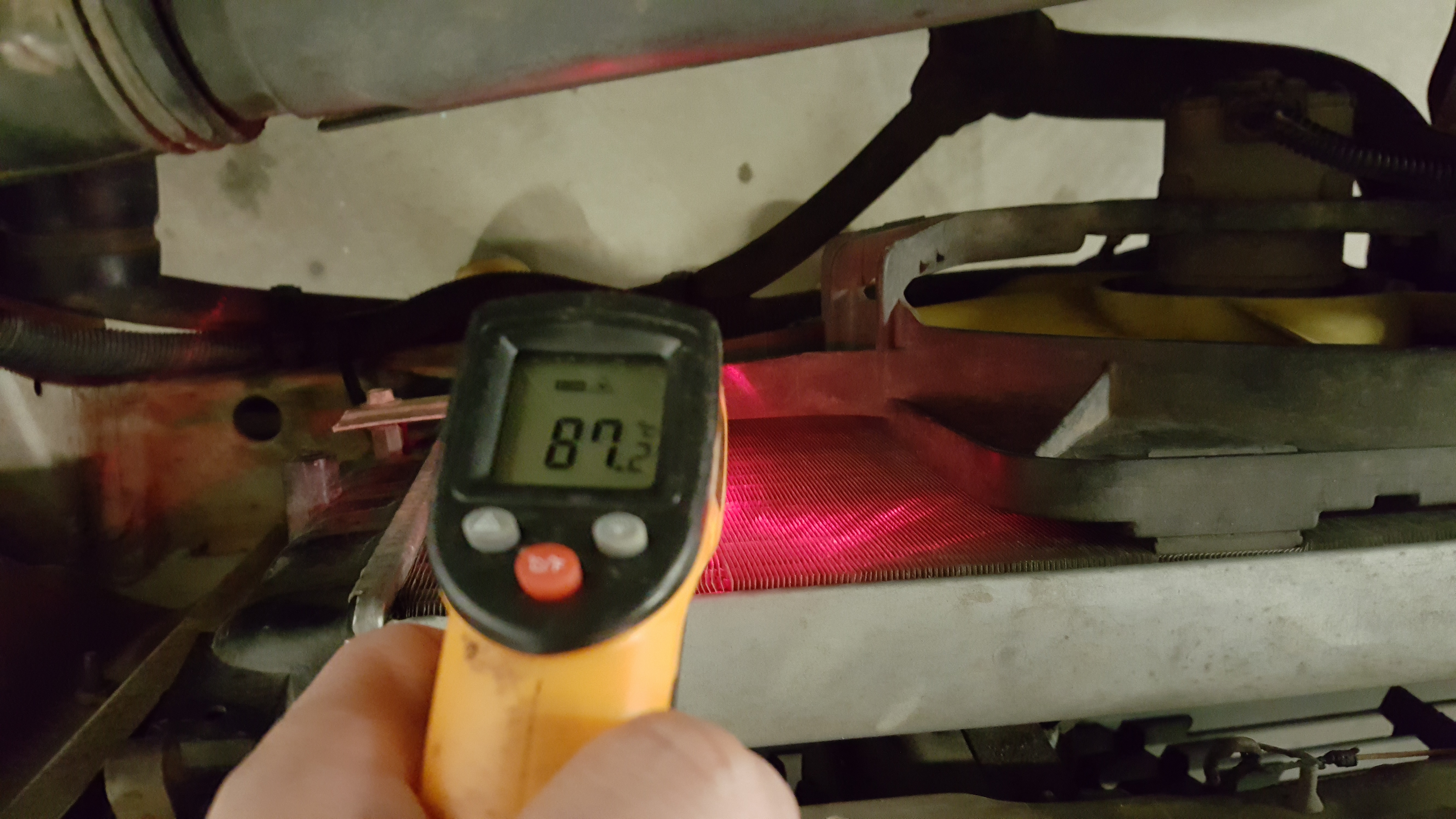

I changed the thermostat yesterday and gave the radiator a wash, temp is still the same.
I checked the the radiator with heat gun and it goes up to 87-90c then fan kicks in.
Hoses are hot and does not pass 90c.
Hi there
I had exactly the same symptoms as yours and had tested and tries there was to try. Until with the help of this forum that realised that I had put the coolant straight without diluting it. So the radiator couldn't get rid of the heat. Could you have done the mistake I have done too?
I am using 4L Paraflu which is already diluted.
From cold,have you checked what temp the thermostat opens,with your heat gun. My cheap thermostat opened after the cooling fan cut in,new thermostat then cured it.
