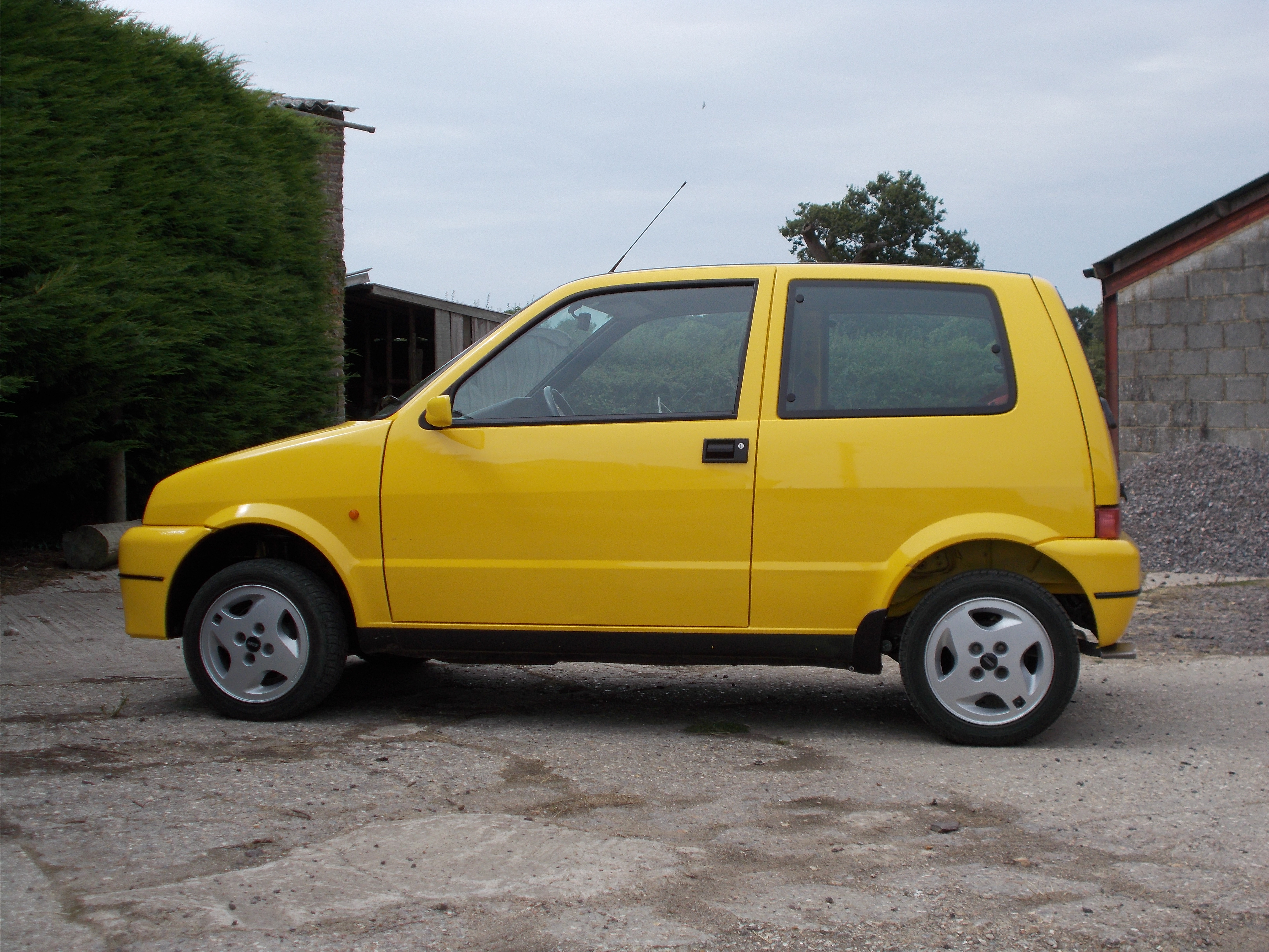

Finally, after nearly 3 years off the road, this little Sporting is now roadworthy!
Work included...
  • The rear beam and springs have been refurbished
  • New shocks all round
  • Powerflex bushes
  • New fuel tank
  • New brakes all round
  • New exhaust
  • New wishbones
  • Welding in various places - especially the offside rear wheel arch
  • Painted front and rear bumpers - colour matching took some time as the car had faded
  • Rocker cover gasket, sensors and general service items
  • Wheels refurbished and powder coated
  • Steering wheel refurbished
  • New radiator and cooling system pipes
  • Period radio - complete with cassette player :slayer:
There are still areas left to do, but it's now usable (and legal).

Good work on the cinq! and good luck with the coupe...
Just FYI, there is many variants for broom yellow but only one paint code.
i.e. there is only one broom yellow, but even 2 cinqs that are broom yellow could've been a different shade to another even when new, and thats before you take into account different cars will have faded at different rates and then even panels on a single car will fade differently too.
Its basically impossible to get a 100% match on broom yellow unless you take a bit of the car to be colour matched or paint the whole thing with fresh new paint.

Blu73, we did indeed find that Broom Yellow seems to have a significant tolerance!
Fiat Broom (258/A) was too dark for the Cinq, probably due to fading. We colour-matched the Cinq using a coupe of parts in the same area as where we need to paint.
The result was creating colour cards with various combinations of Mitsubishi and Ferrari yellow. Ended up being perfect!
The Halfords Broom Yellow was too dark for the Cinq, with Hycote being used for the internal bits However it was reversed for the Coop, with the Halfords Broom Yellow being almost a perfect match for the internals of the Coop!
