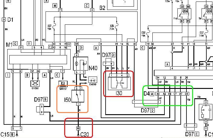

To eliminate the brake switch you could pull the fuse F37, that will give you no brake lights so that's just for testing in a deserted area or you could use the handbrake to slow down when there's no on around. Going to get a few beeps but hopefully no stalling out
A bit of a long shot, but if your inertia switch earth was lost at C20 on g force of braking then the fuel pump would stop, engine stops and hey ho low oil pressure warning light. So i would rig up a constant voltage drop test from inertia switch pin 1 to a good earth. It should of course be 0v all the time but if i suddenly saw 12v there with the engine dying then that would show a loss of earth to be the cause

But for it to start right up again afterwards is odd and for it only to be happening when braking means either something is earthing or open circuiting with g force or the brake light switch is affecting things
Could try off road and disconnecting brake switch circuit by pulling fuse F37 and see if that is electrically intefering when braking
A loss of earth on the ECU would kill the engine too but you'd get a "lost connection" warning.

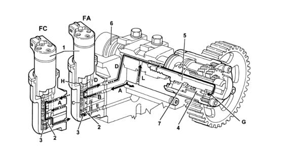

You have some bizarre stuff happening there. The level shifting by 2 1/2 litres is massive so something is holding the oil up and preventing oil flow and there's not much in the way apart from that new oil filter. I'd change that straightaway. They're cheap and easy to change and some are cheap and nasty.
But for the oil level to drop so much to cause oil starvation then I would think there would need to be a resistance in the oil return system to hold up the oil returning to the sump.
1.8 engines have a variator in the oil circulation system, maybe somehow your variator solenoid is sticking and preventing oil flow
