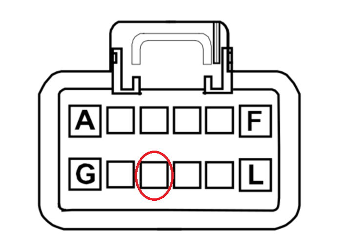

is this he connector under the fuse box ?
good
one side should have the same colour wire as going to the sensor
should be here
with the oil switch disconnected there should be low ohms between either end
and not register anything between either end and the engine block

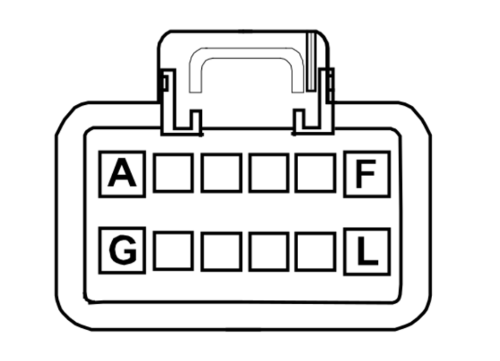

good
should be here
I believe I have checked it and it was 00.1 ohm, however I haven’t checked to the block. I will do it tomorrow.
its important to disconnect both ends when you test it. The oil switch is shorted to earth any wire with a path to earth will also measure low ohms
end to end low ohms
open circuit / no ohms between either end and the engine block
