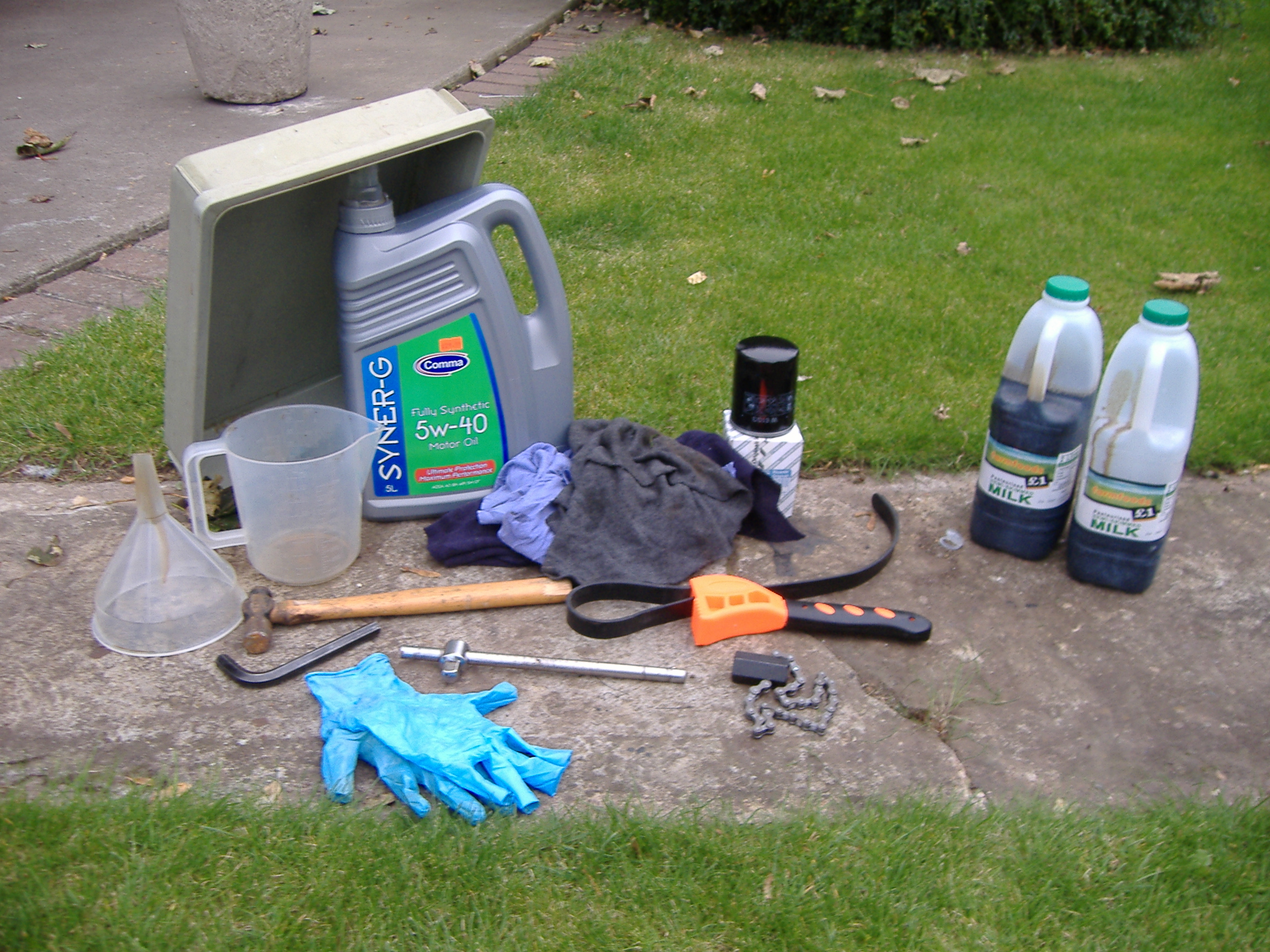

Equipment you need:
Jack/ axle stands/ or ramps
Funnel
Measuring jug
12mm alan key or 12mm Hex socket,
Filter removal tool or vice like grip
Hammer (if sump plug is stubborn)
Latex / Vinyl gloves
Rags / blue roll
Oil pan or large tray
Container for waste oil.
Fresh oil and suitable Oil Filter would also be a good idea too

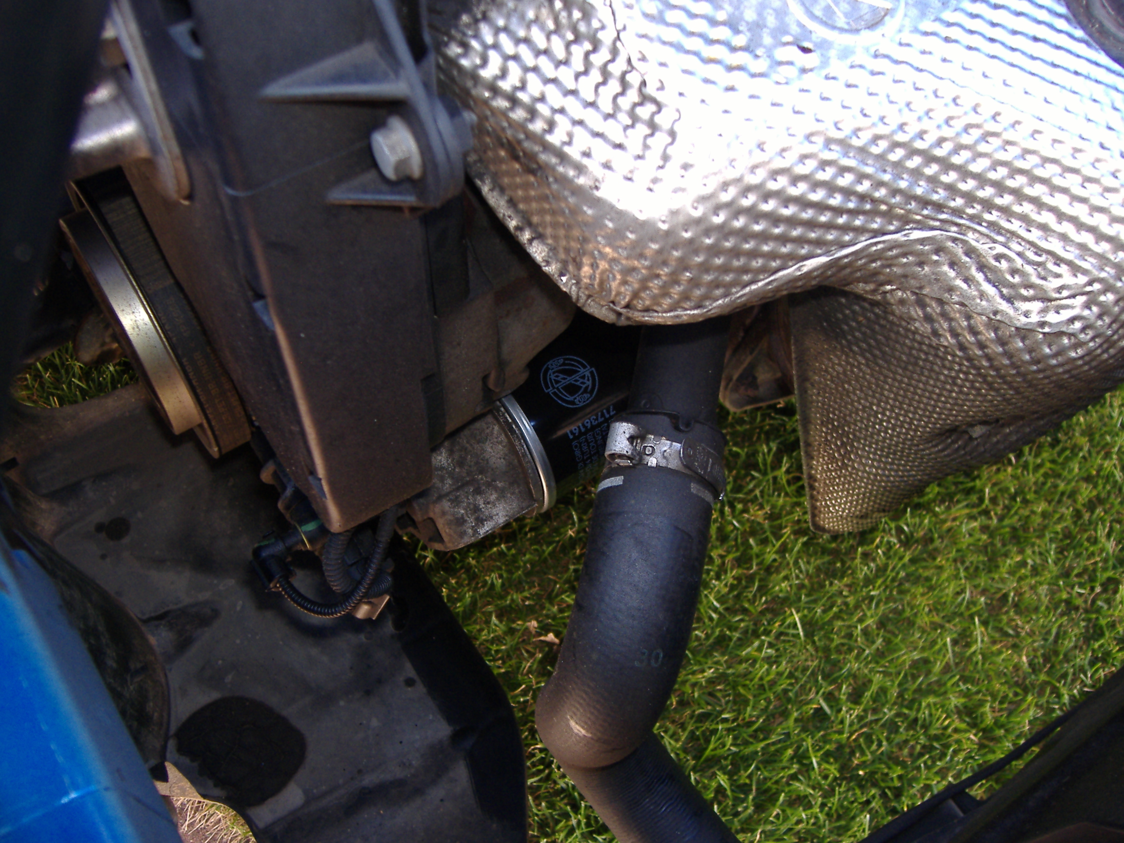

Now with the old oil draining away its time to remove the filter which is located on the Front of the engine between it and the radiator
(highlighted in Yellow)
Mine was removable by hand but you might need a oil filter remover ((it unscrews anti clockwise))...
