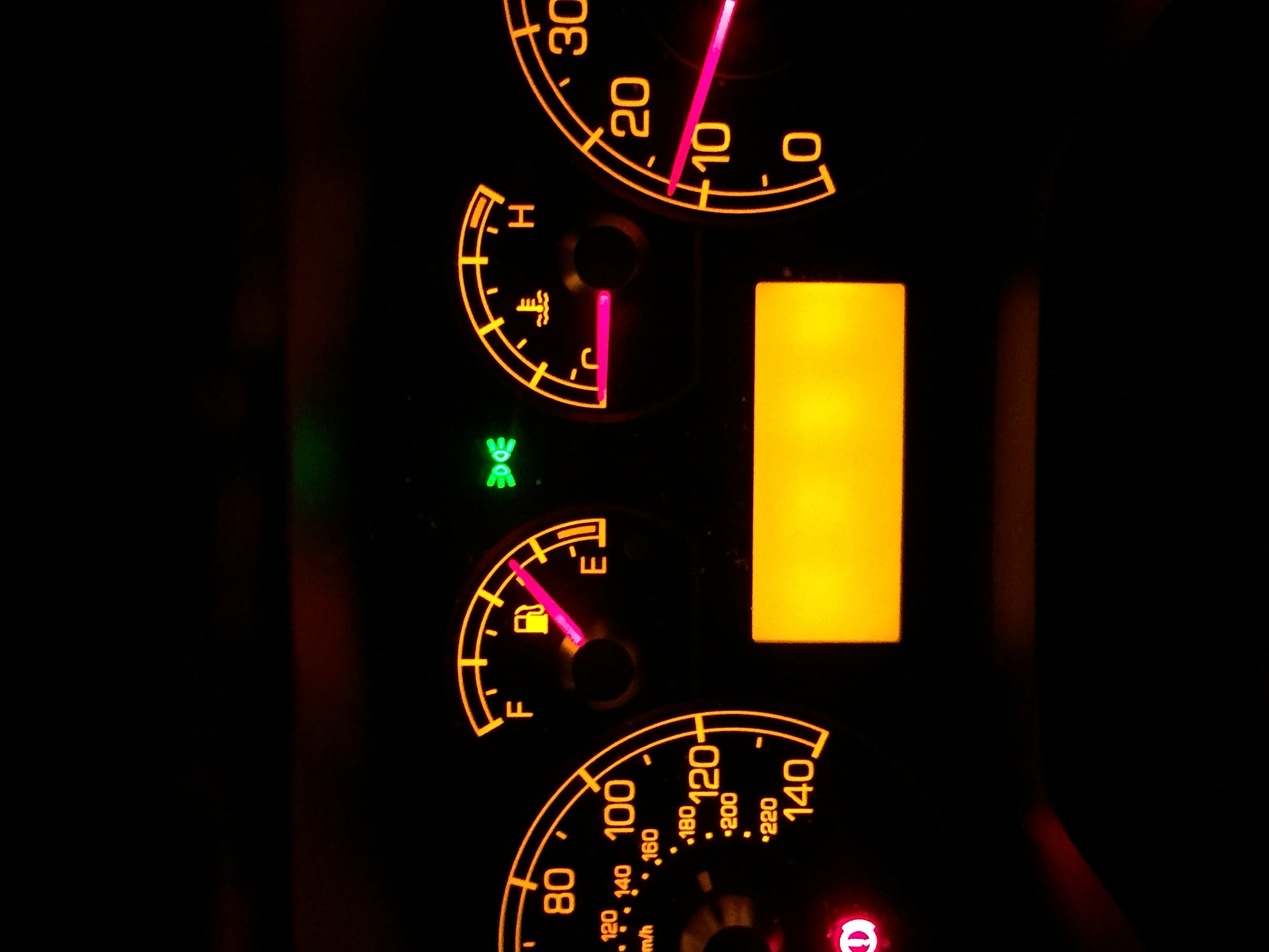

Please help, I have just put a new battery on my 2008 Punto 1.4 and the odometer/trip meter screen in the middle of speedometer and rev counter has gone blank. When I initially turn on the ignition a type of computer language writing comes on the screen but then goes off. The back light on the screen is still on but nothing else.
Any one had this issue?
Any help much appreciated?
Cheers
Dan

Tried disconnecting the battery several times and nothing. No when I press things on the menu i can hear the beeping but see nothing. The Bluetooth still connects but just a blank screen. I am wondering if I can just replace the LCD itself??

Thanks for all your input but I was correct, I have just replaced the LCD itself from a second hand cluster to mine. It turned out that the LCD had gone kaput!!!! Easy 2minutes job!!!!
