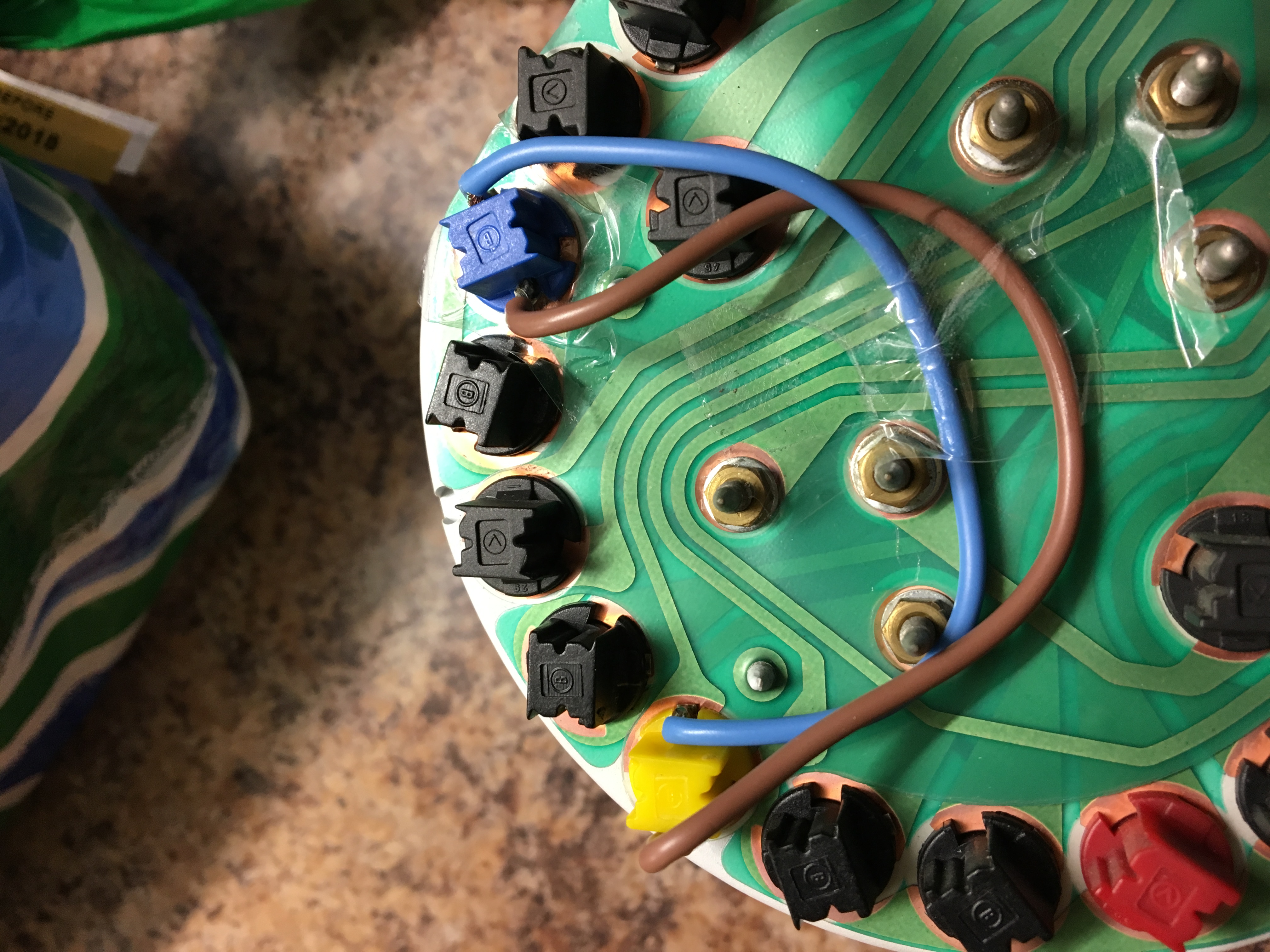

You can try this temp fix until you sort it. Solder two works from ABS lamp to airbag lamp then insulate airbag lamp from its connections in the socket. It worked for me.
I might end up doing that tomorrow!

The yellow one is for the air bag light that is giving you problems, the others without looking on the opposite side (face side)of the instruments I'm not sure. I don't know why separate colours were used other than for quick identification of problems by Fiat garages.
Temporary fix done for the airbag light
