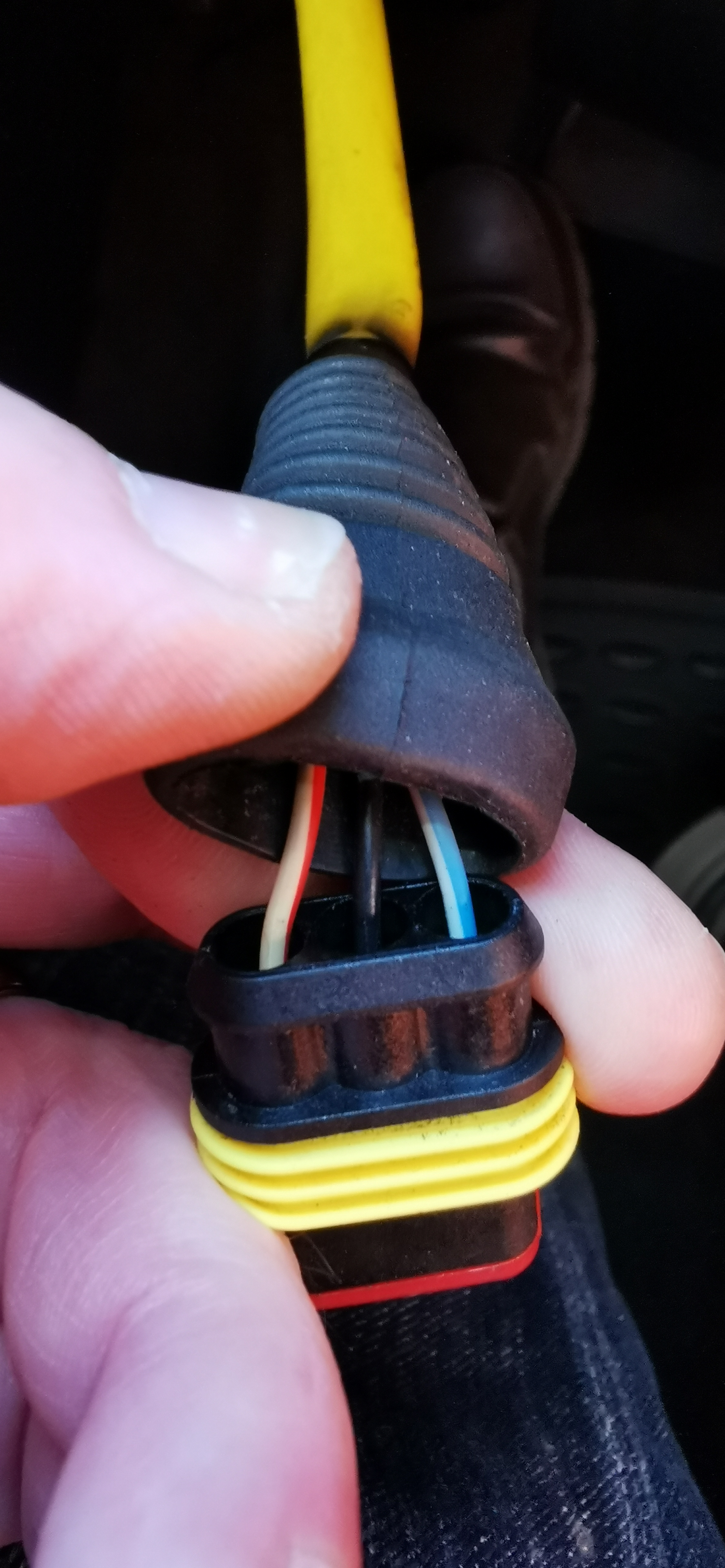

First find the cable.
On my B it was tucked away and located just to the right hand side between the centre console and steering wheel and cannot be mistaken because it is the only cable with a yellow covering/sleeve. (Definitely not the one found on the right hand side of the steering wheel in the foot well area which will be the Engine ECU plug and only has two wires fitted on a similar 3 pin plug) .
Once the 3 pin plug on this cable is located you can pull back the rubber sleeve a little to expose 3 wires.
(I have included a picture showing these wires if you want to see it)
They are......
(a) Red/white
(b) Black
(c) Blue/light blue

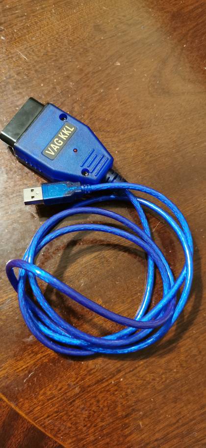

I have the adaptor and the odb2 cable, but I can't connect to the airbag module.
I conneced only to the ecu engine module.
