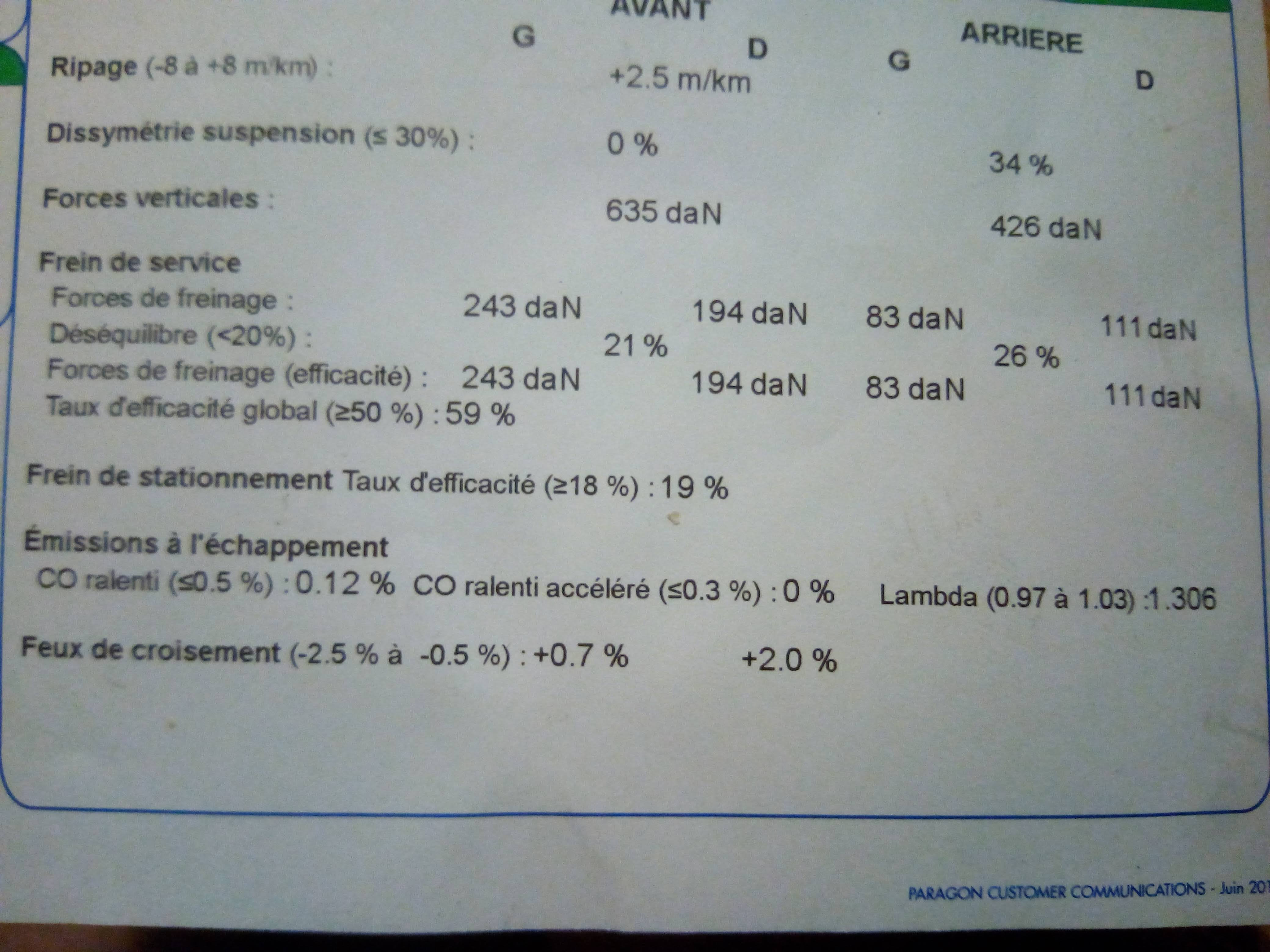

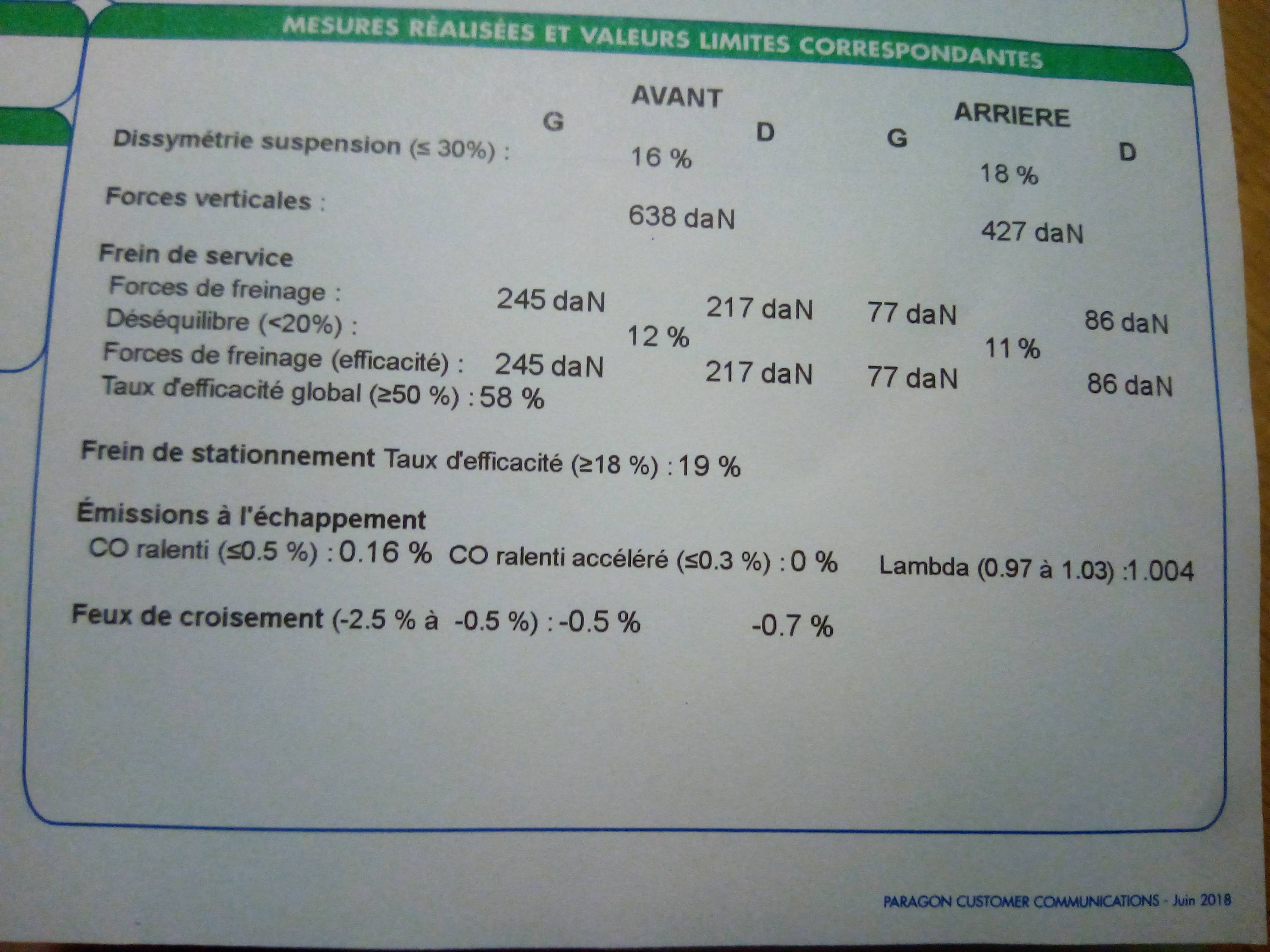

Varesecrazy - I am really sorry! I don't usually ignore people when they are trying to help me! I have been away for 2 weeks (Italy - best place to go!), and there was supposed to be wifi where we were staying but there wasn't! And I have no data on my phone, so it has been a rough 2 weeks! I also forgot to scan the figures before I left, but I have done it now and here they are. I have done the fail and the pass emissions - the fail was on the 3rd figure (lambda), and I got a new lambda probe and it fixed the problem for the test, at least. But there is something definitely wrong, because it has a horrible misfire, smells funny, the 'throttle sticks' - revs stay high when you take your foot off, and I have checked and it is not the cable. So any assistance or advice would be gratefully received!

Take a look to this post. I had some of your failures https://www.fiatforum.com/punto/298002-mk1-punto-idle-revving-high-idle-2.html
As summary,
-For high revs check the throttle sensor. If you replace it bear in mind there is a reset process to make the new one work
- for the smelling and misfiring look for air leaks in the air intake or in the exhaust manifold, both can be the root cause of the high levels of gases
