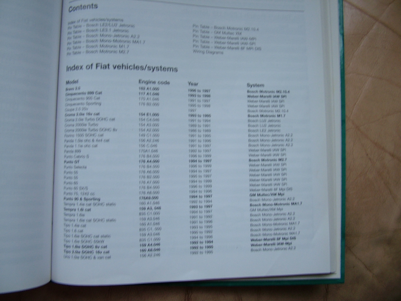

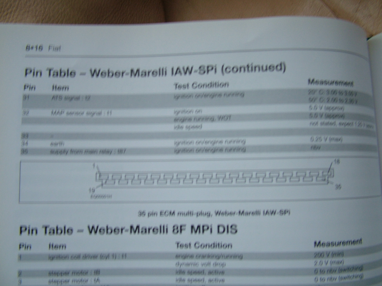

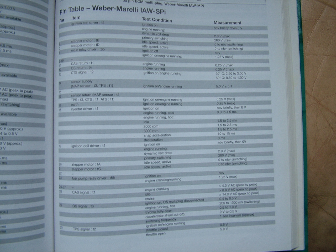

I do have a book with ECU pin outs including some early Bosch 1AW SPI though it ends about 1998/9 if you have a bit more information. It lists 176B4000.
What is the name of the book? Where can I find it?
It is Haynes Engine Management , two volumes first is Alfa to Mazda 3558, second Merc to Volvo is 3578.
They only go up to around 1998/9, if you are only interested in the Bosch 1AW I could give you a photo if you give me more info. Sorry about the photo.

Well, if you have any information about the pinout of the IAW 6F.SB and IAW 16F.E3 ecu's I would appreciate it!
It seems to be either SPI , MPI or DIS , on the previous poor photo was it possible to identfy with vehicle was nearest using engine code also?
