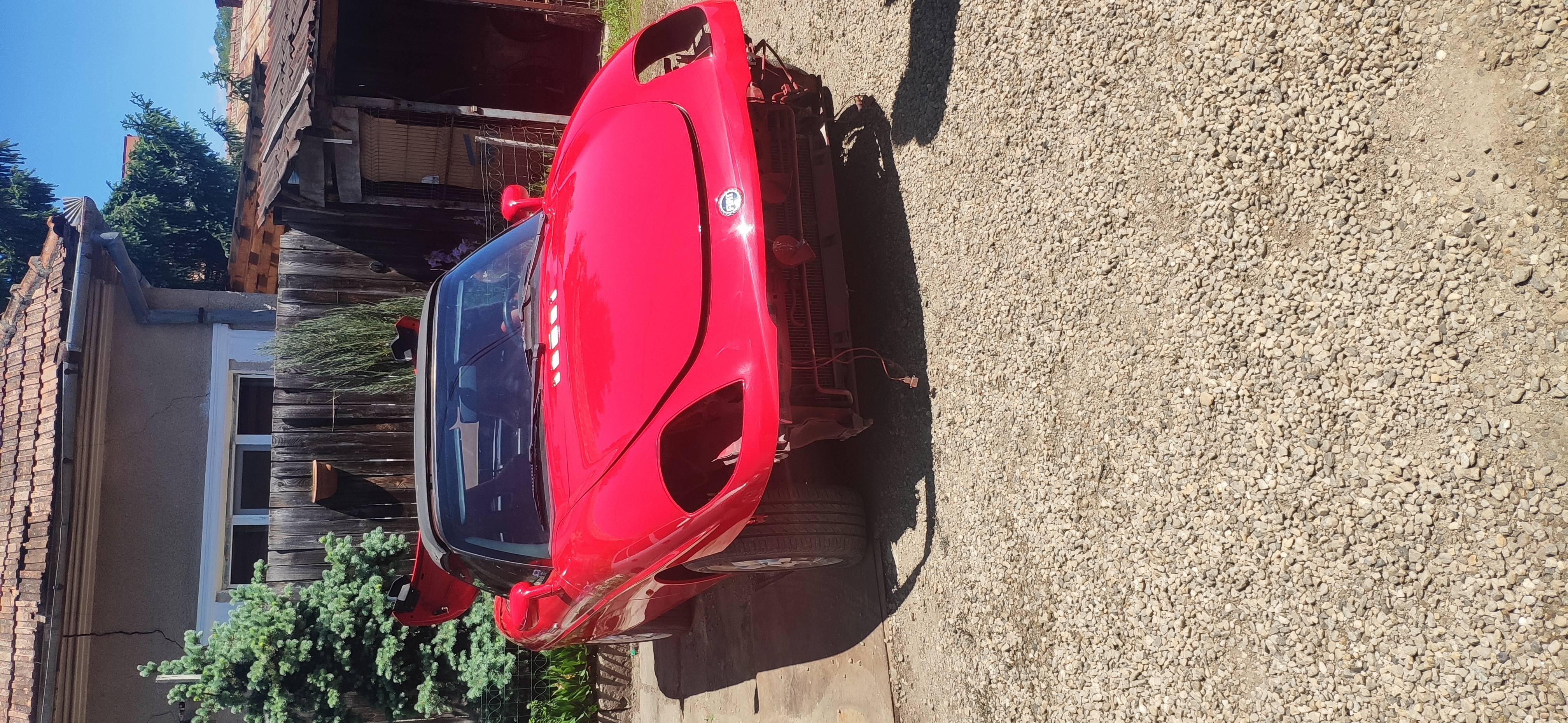

Hello everyone so my red barchetta is back from the painting and so the restoration is continuing. But im facing a problem, no power is going to the fuel pump(did a check on the cable if power is coming). I did check all of the fuses, checked the cable if its okay didn't saw a problem. So can someone suggest something, what to look over? I dont want this beautiful Barchetta to die ?
