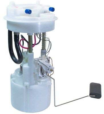

So is this what you fitted the seal to?
If so was there any sign of dirt or blockage to the fuel filter part, or is it possible you damaged the pipes inside it?
Is there any contamination inside the fuel tank?
This looks like the same pump.

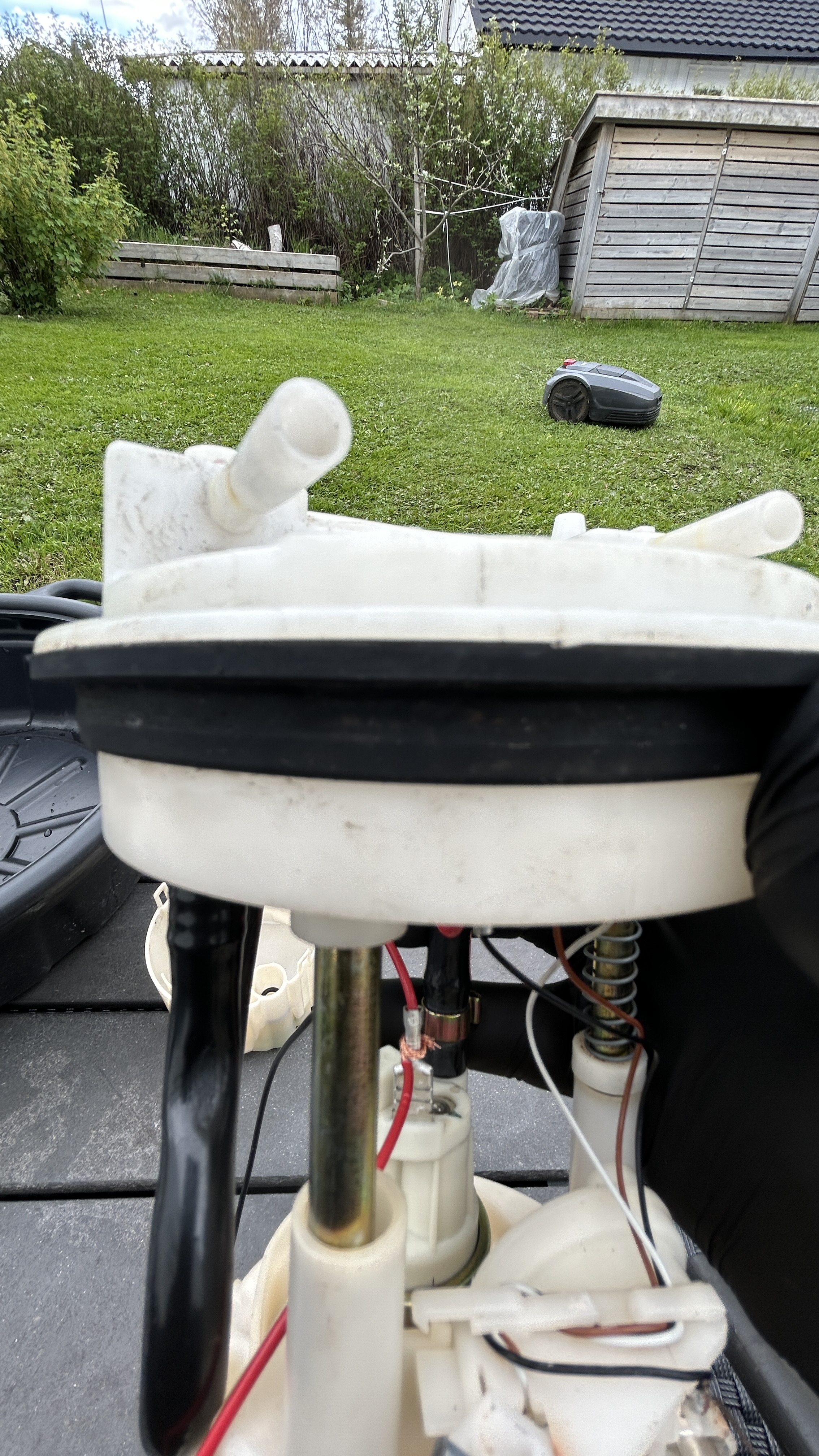

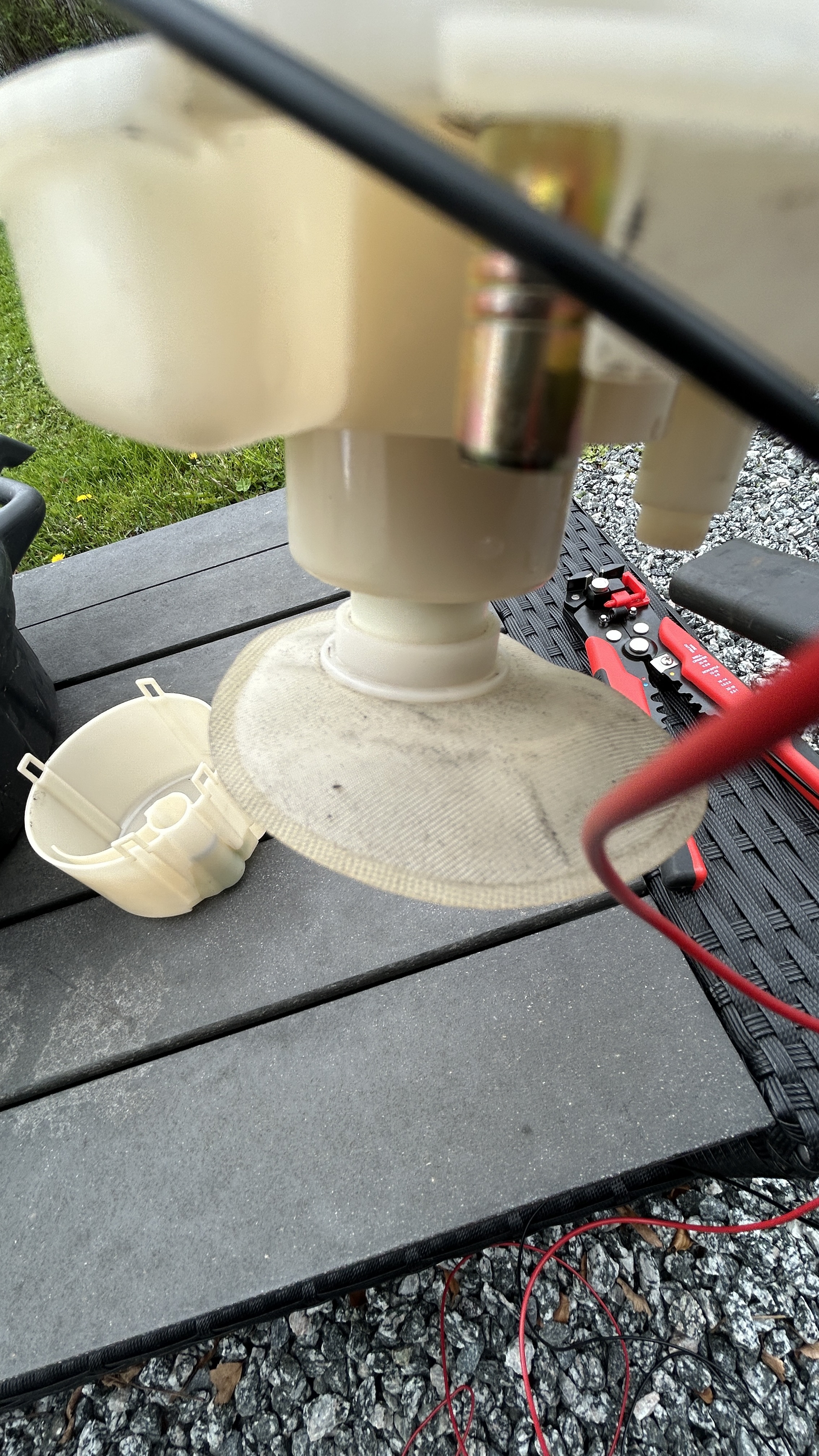

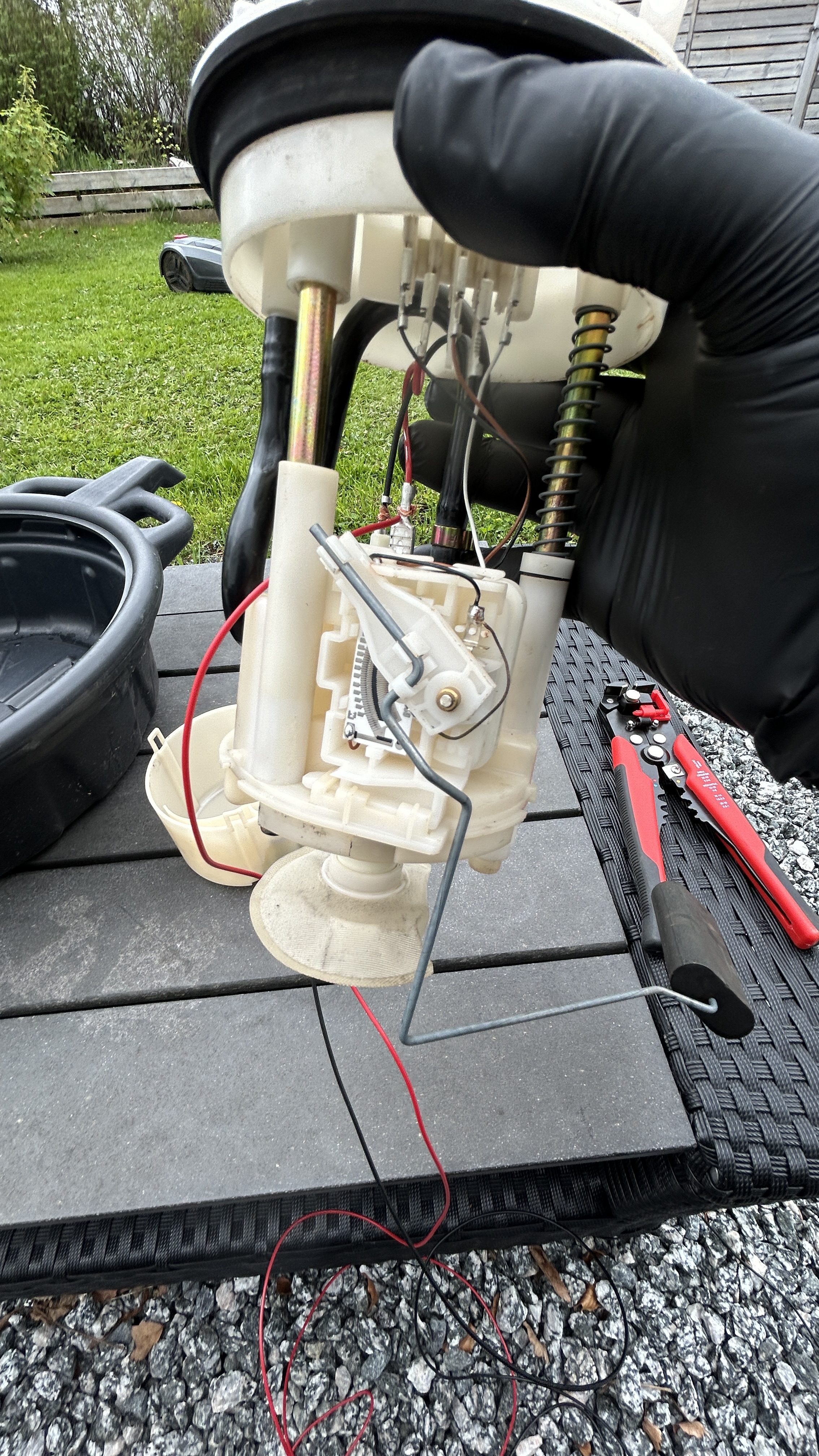

I took out the pump and cleaned the filter.
As the picture show, this I the old gasket. The new is wider 21mm.
As some u mentioned, it must be airtight around the pump and tank. But, is it vital for the pressure or the amount of liter the pump delivers? When I testet the pump outside, it pumped 1,68 l/minute or 100,8l/h. This is with some air in the intake, as I just tried it a small plastic container.
