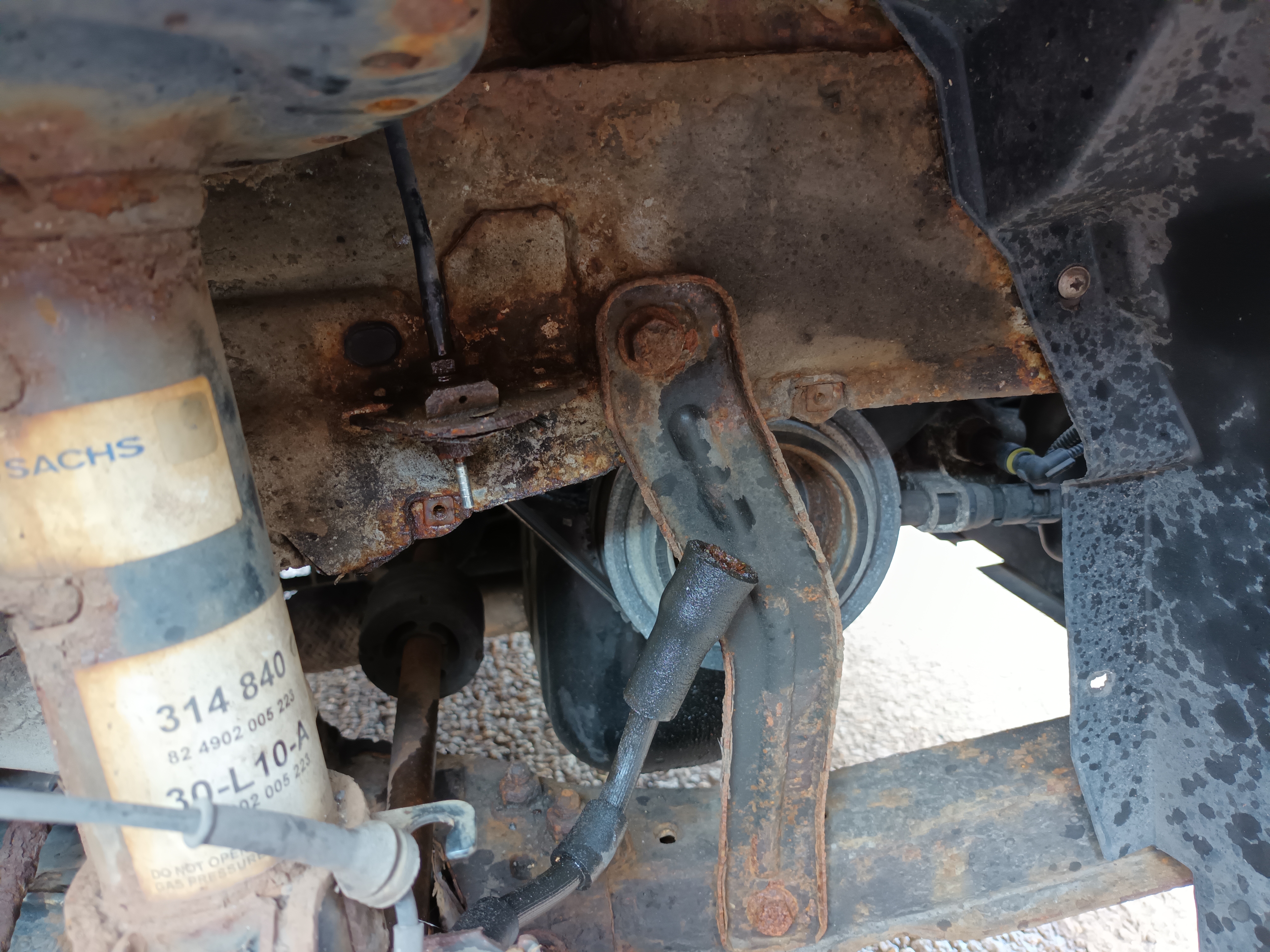

Driving along today after several trips today, press the bake pedal starts braking then flat to the floor! Haven't got recovery but only 2 miles from home was an interesting trip back but light traffic and good hand brake.
Only just noticed the cover is missing (after fiat did the cam belt) anyone know where I can get a new one? Failure is obvious in the picture
The extra rubber sleeve over crimp of brake hose is a bad idea by hose manufactures and has been seen before - scary. Very glad you are ok.

The bleed valve moves the flexi to caliper also, my issue will be the brake pipe to flexi, have doused in plus gas, my thought is flare spanner on pipe( arriving by Amazon tomorrow, typically have only even sizes) and impact socket on remaining part with impact driver, already have new flexi, clips, bleed valves etc, oh and pray, also have glove over reservoir under cap to stop it dumping all the fluid out of the open pipe.
