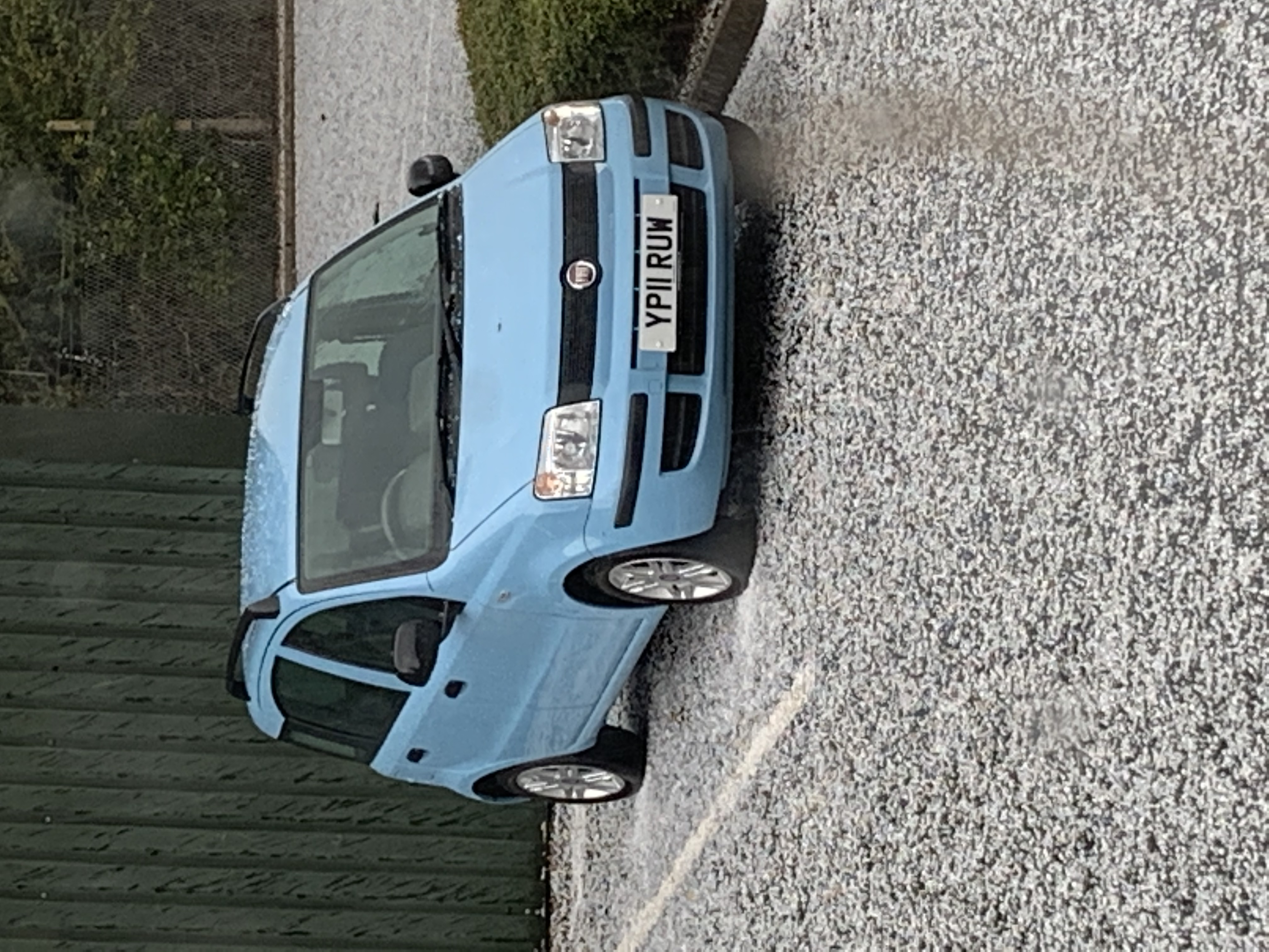

How do! New to this forum. Owner of a beautiful 169, gifted by my wife’s Gran who has decided at 90 it’s time to hand up the keys. Garaged it’s whole life she’s owned it and with 27k on the clock from new, Its like new. Looking at sim pathetically changing the interior for more driver comfort.

A quick search shows the OP's car is a 69HP 1.2 Active registered 10 June 2011; so Euro5 and not a cambelt-safe engine.
In the absence of documentary proof of when (if ever) it was last changed, I'd do so at at the earliest opportunity, together with the water pump & tensioner. If it does snap, you'll ruin a lovely car.
I was looking at the wheels, roof rails and grill panel and thinking to myself "that's not a 1.1". So, as you say, being an '11 plate and a 1.2 it's going to be an interference engine right enough. I very nearly bought one when we were looking but we ended up with Becky instead ('10 plate 1.2 60hp euro 4). I was quite attracted to the fact that the one we looked at didn't have air con! An advantage in my view! I don't think these Active trim euro 5 engined models had air con as standard? you had to go to the next trim package (Dynamic?) up to get it. Now I'm very happy with our euro4 engine Becky, even if she does have the air con!
PS Welcome to the forum RBG. Do let us know how you get on with your, very nice looking, Panda. Oh, and I thoroughly endorse our moderator's advice to get a complete cam belt kit fitted (so including water pump) if you have no definite evidence it's been done recently. I've just - yesterday afternoon - had to inform my neighbour that the cambelt in her SEAT Ibiza has almost certainly failed. This too is an interference engine and repairs will be pricey if it's collected the valves (which it probably has as there is now no compression on the engine.) We have a panda and a Punto with FIRE engines, like yours, in them. Our Panda is non interference but the Punto is. My "trigger point" for starting to think about doing a belt change on them is when they pass 4 years/40,000 miles and I always fit a complete kit, with water pump, because the water pump is part of the drive train so if it fails the belt is likely to fail or jump off the pulleys anyway. If you are doing "stuff" yourself I can confidently recommend Shop4parts although I recently (couple of years ago) got Gates belt kits inc water pumps, for both vehicles at around the £57 mark from Autodoc. I'm absolutely scunnered to see they've got them on offer for a ridiculous £38 just now: https://www.autodoc.co.uk/car-parts.../panda/panda-169/17628-1-2?categories[0]=3096. Almost worth my while to buy a couple and keep them until they are needed a couple of years from now!
