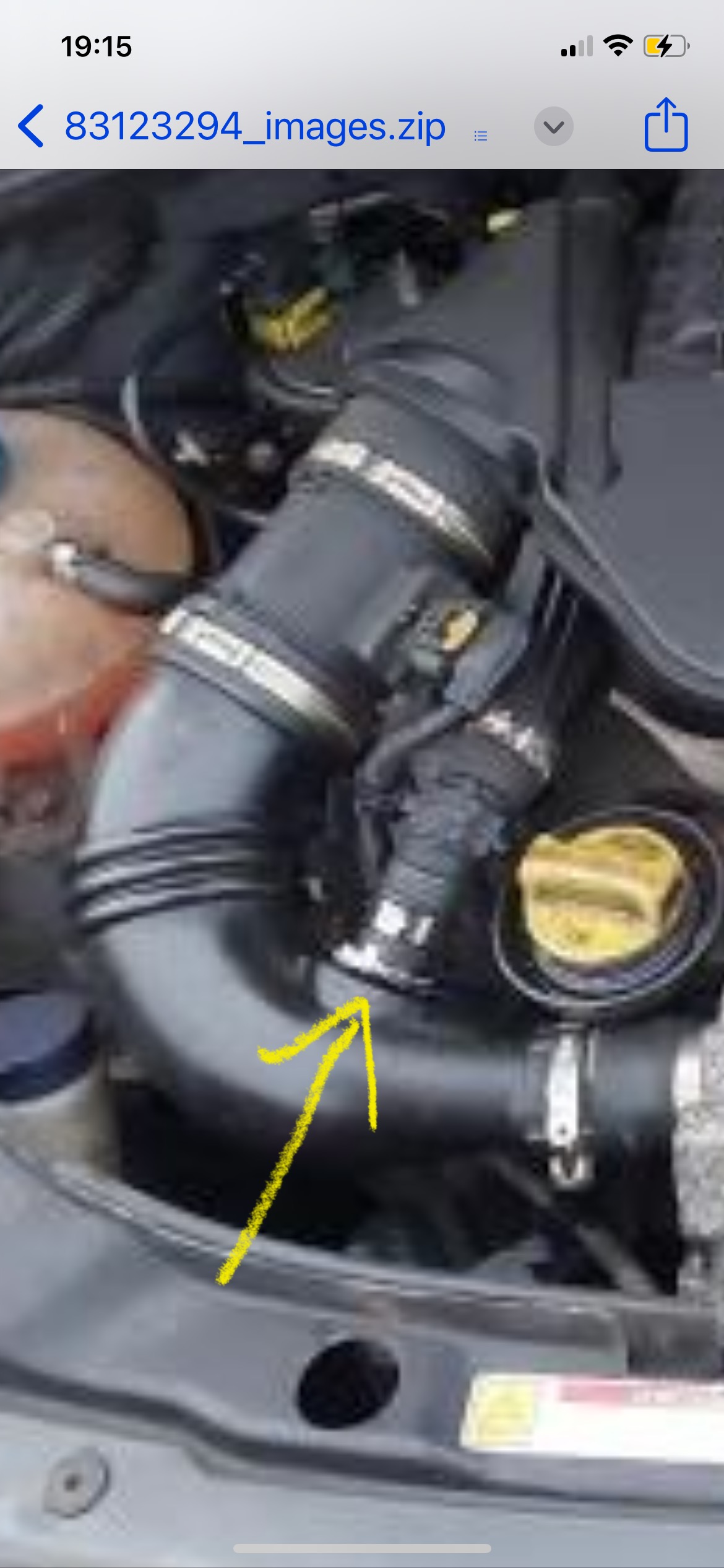

Bought a wee 2010 500c multijet non starter
Turns over fine
Mes only shows a cylinder 3 glow plug error and when cleared it comes back on cranking
Have put a jumplead earth to the engine but still nothing
I did find a break in the intake pipe (see pic) the wee pipe coming off is totally off, could this stop it from starting? Sorry not sure the name of some of the parts on deisel engines
Im going to take this pipe off and clean and glue it back together. And change the glow
Plugs and fit a good earth

I’m new to playing with deisels
This is a 1 owner full service history car but I bought it blind from auction
So I’ve
checked the earth and used jump leads
fixed the breather pipe on the intake
changed the battery
Sprayed in easy start
Taken the full pipes of at right hand side of engine 1 at a time. Turned on ignition and deisel poured out
Captured the fuel and checked it wasn’t petrol
Checked oil level in sump
Next is to check compression is this done buy taking out injectors or can it be done through glow plug holes when I change them?
Can I use mes to check other Paramus? Fuel presssures etc
Mes says engine in start state?
