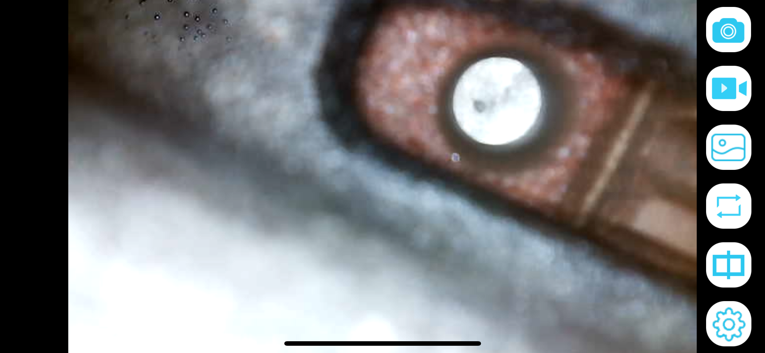

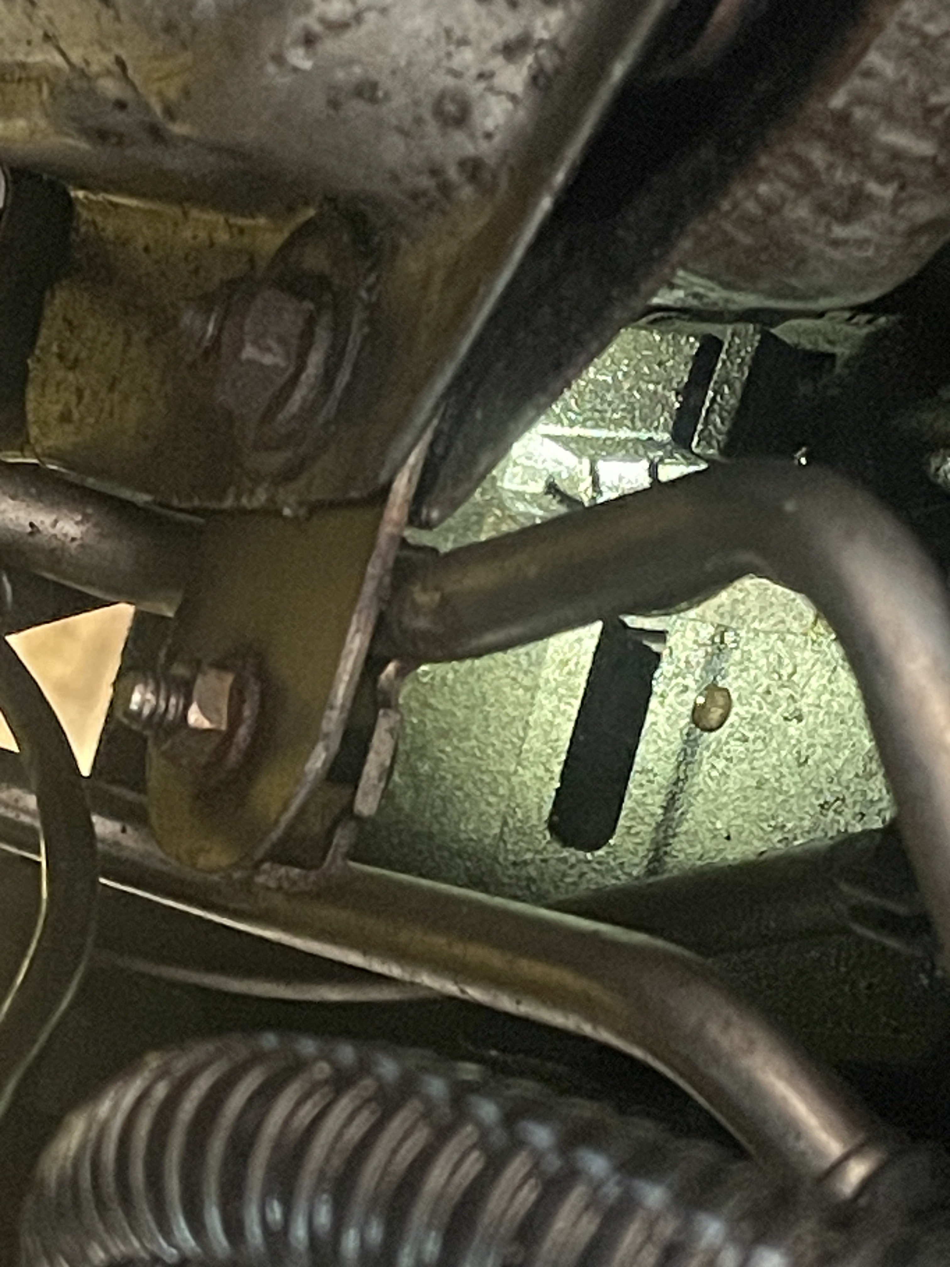

I finally found the flywheel locking hole
Its on the front of the gearbox ( i was looking underneath) photo attached
First pic looking down from above from passenger side and second one a closeup with the scope camera
Just need the locking kit to arrive today then put it all back together
Did the full job with engine in the car and a lot easier than i had expected
Total time so far 10 hours over 3 days
If i did it again i could possibly do it in half that
