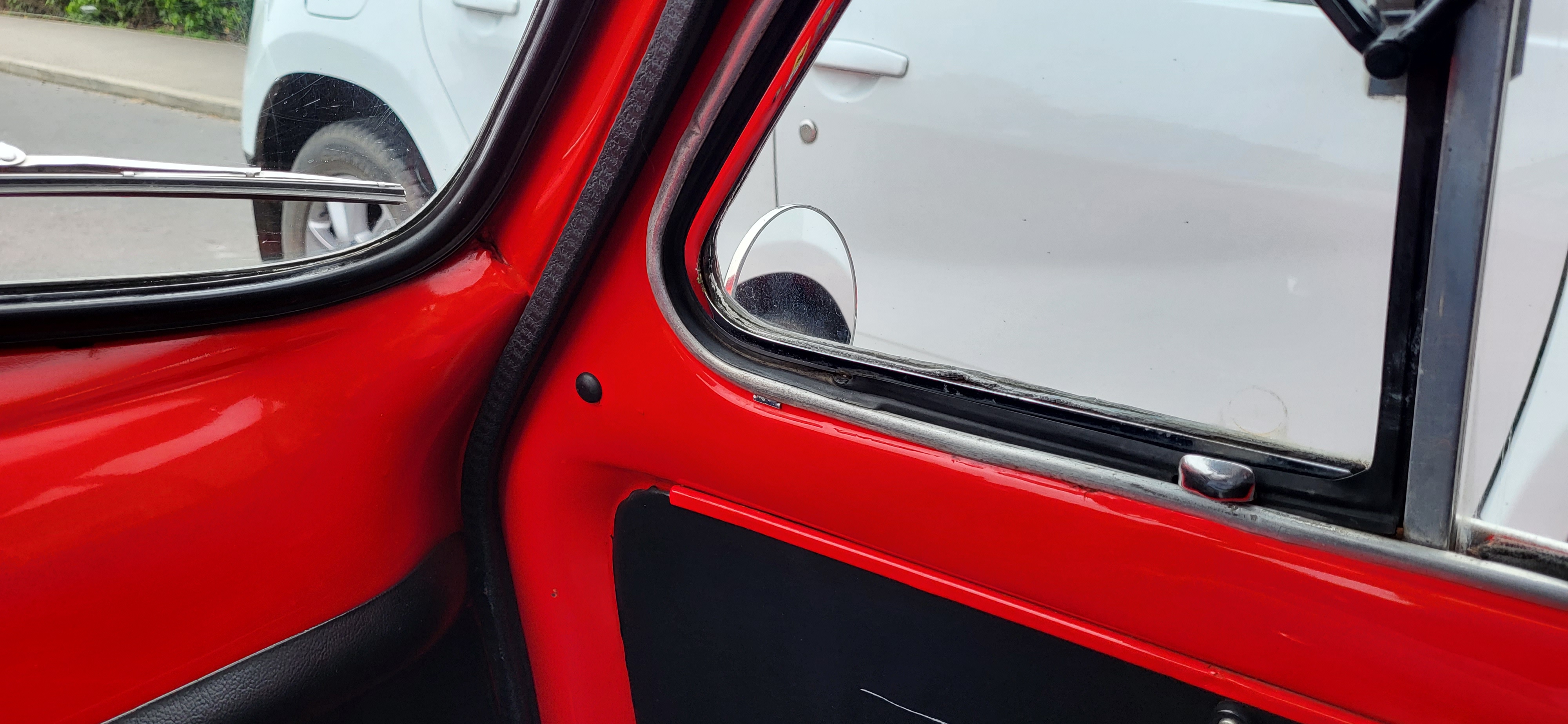

Is there a way to make the door mirror less useless?

The door mirror I think will be an aftermarket one bolted to the original holes n the door, which means its low and useless... ask me how I know.. haha.

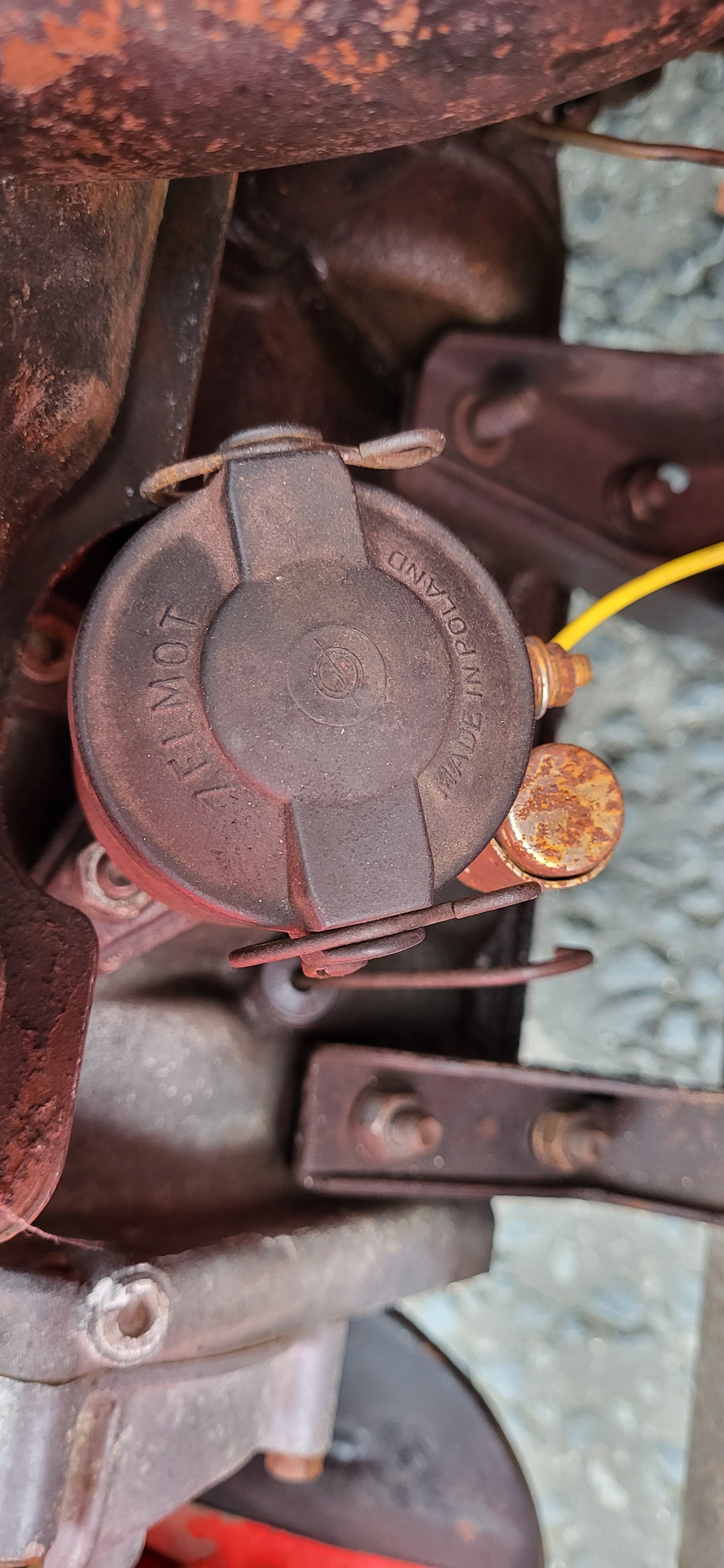

This is the distributor that is fitted. It apparently still has points and a condenser. Does anyone know what it is?

Hi Smart, what you have there is an 'Elmot' rortorless distributor they first came onto the 126 cars as an upgrade in May 1985. The original was a 'Marelli' the polish variant is the 'Elmot' it only uses low tension voltage through a standard set of points to a separate coil (mine is a dry twin coil) on a 'lost spark' system. I have the same system and provided you keep the points in good nick and use the best condenser you can it will give no problems.

I agree with Ian (Bleeding Knuckles), fitting a GOOD condenser is essential. There are 2 that can be mounted away from the distributor (and therefore away from the heat of the engin's 'cooling' air)---they are "Swiftune" and "Shacktune". Both of these condensers have long 'power' and 'earth' leads, enabling them to be mounted away from the distributor and up by the coil. Most modern 'normal' condensers are very cheaply built; a source of a GOOD 'normal' condenser is "Distributor Doctor"---their '484249' condenser, with a bit of tweaking of the mounting bracket, will fit fine, and is made (in the UK) to a high standard

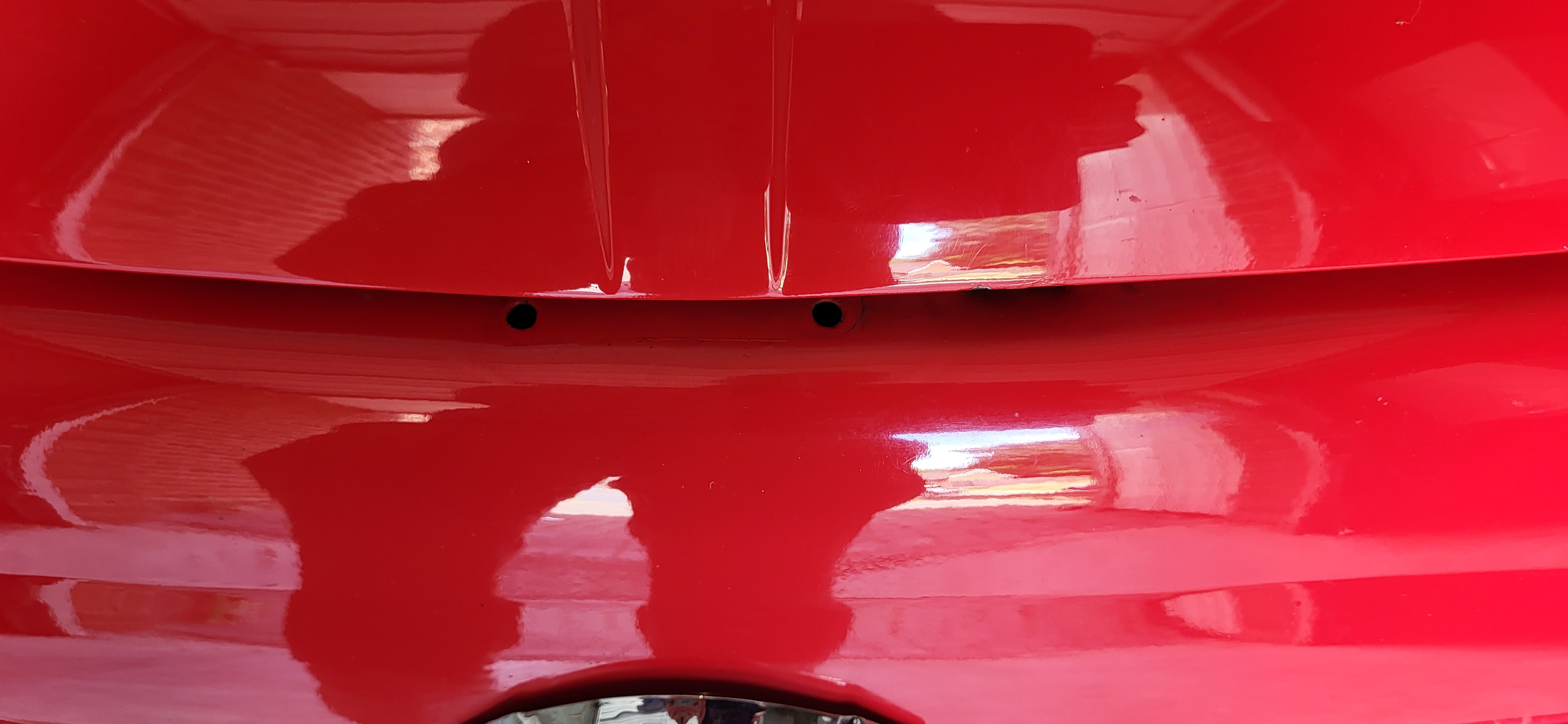

My car is now back. Woohoo! I'm going to order a few parts to bring it up to standard. What is missing from the front panel where the bonnet closes here:

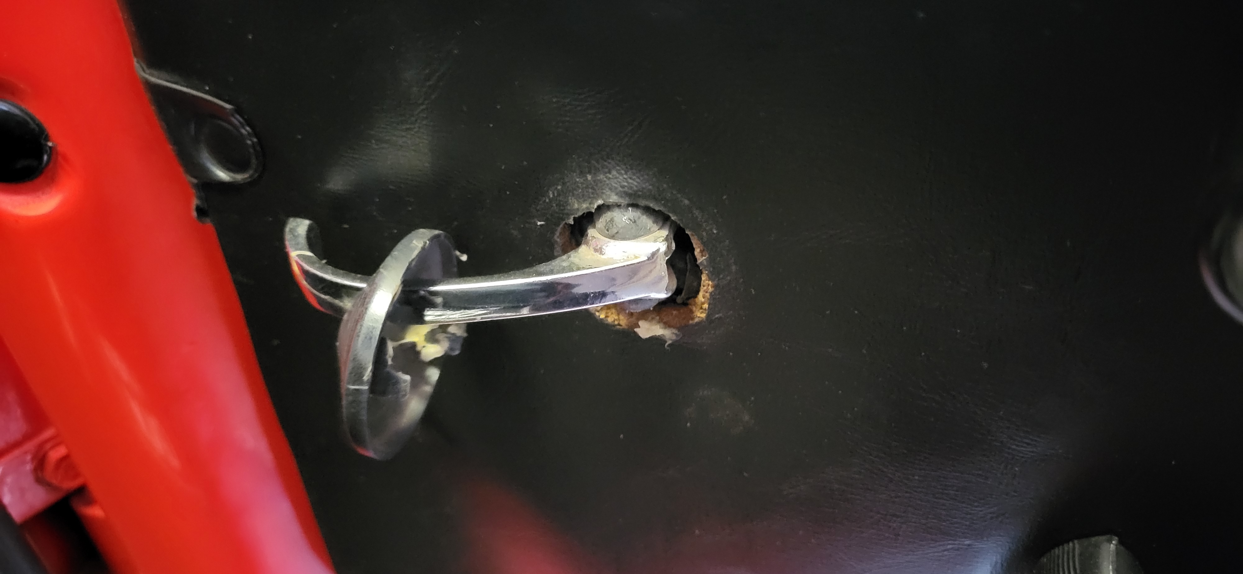

Can these trim ring be replaced by themselves?

Yes, the door handle trim can be purchased separately.
You are missing a rubber 'cone' that help provide positive pressure on the bonnet catch, plus a small rectangular bumper which prevents the leading edge of the bonnet rubbing against the top of the front panel.
