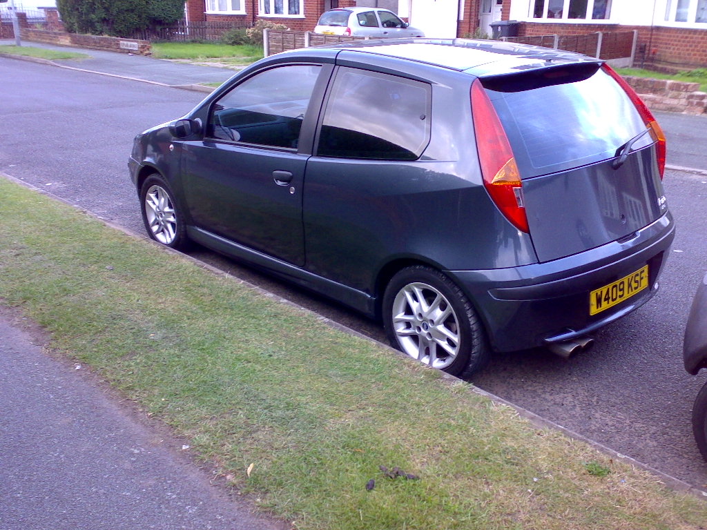

ok here are the pic's of my new baby! second problem tho, my satnav will not play any cd's from the changer? i can here the cd's being loaded by the changer but on the HU it just says searching??? any idea's?

After all, my car is 2001, yours..99 right? And it's abbout time to change the rubber things (dont know the word) and do some cleaning (y)

OK it's not 99, saw that some other place, but I still think the same thing :D
what rubber things? cheeky fu!ker it aint that dirty!!!!
