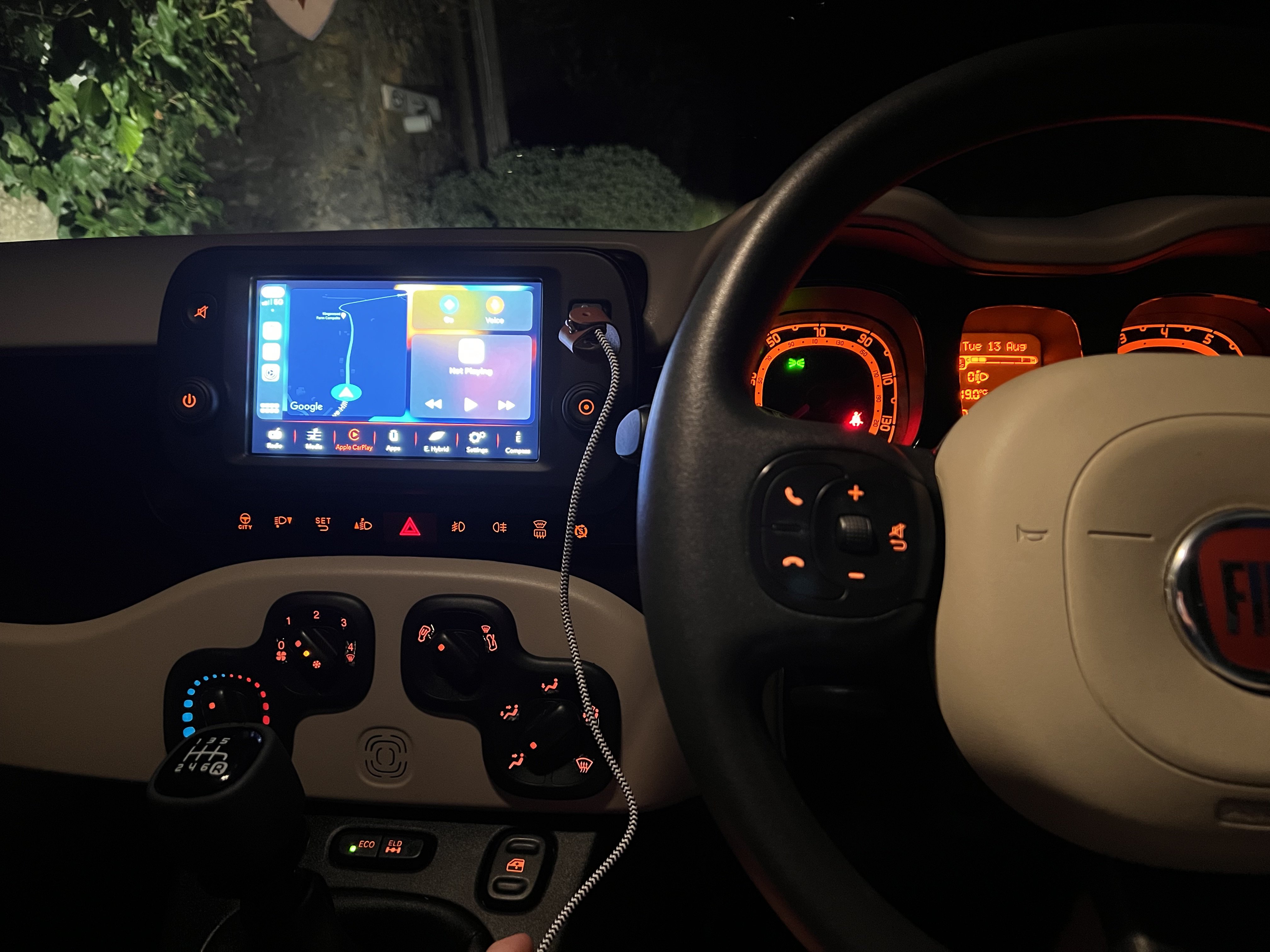

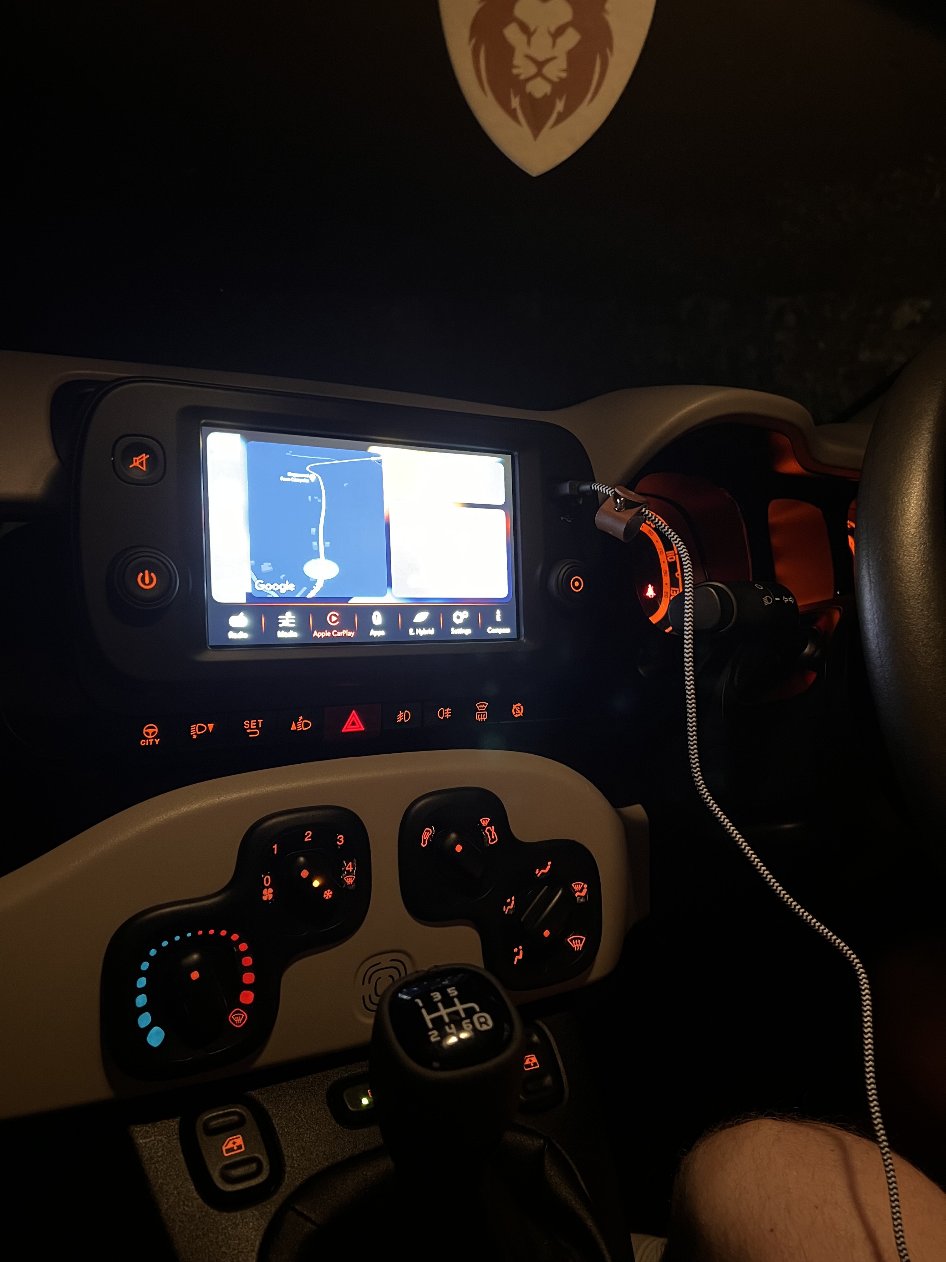

I have read quite a bit on this forum that you can’t change the head unit on 2013-2015 to the Apple car play version in later models. Lots of info that it can’t be done because the unit is coded to the car and you can’t put another fiat one in. Well I thought people might be interested to know that I have tried it and it was 100% possible. Completely plug and play- took less than 5 mins and I paid €160 direct from Italy. It may have fallen out the back of a truck somewhere in Naples but I’m not going to ask any questions. To say I’m happy with it is an understatement! I was at least expecting the flashing mileage to pop up but nope, not even that.

It will be plug and play on all models except the ones that have the smaller screen (non car play) version as that has different connectors. The only bit that is not plug and play is the mic because I want to use the integrated one so I need to move the wires from the old blue and me system - haven’t done that yet. Depending on where you buy from you can get them with a new mic.
I found mine off facebook. I joined the group Fiat Panda 3° serie club Italia and you will see loads of people selling them. I think they all come from the same source and all come from Naples. I was a bit worried that it was a scam but it was actually genuine. If you don’t speak Italian then use google translate.
The stereo does cover the front vents but I am 6ft so angled up they still blow straight in my face. If you were shorter they might not be so great. They still work perfectly for me.
