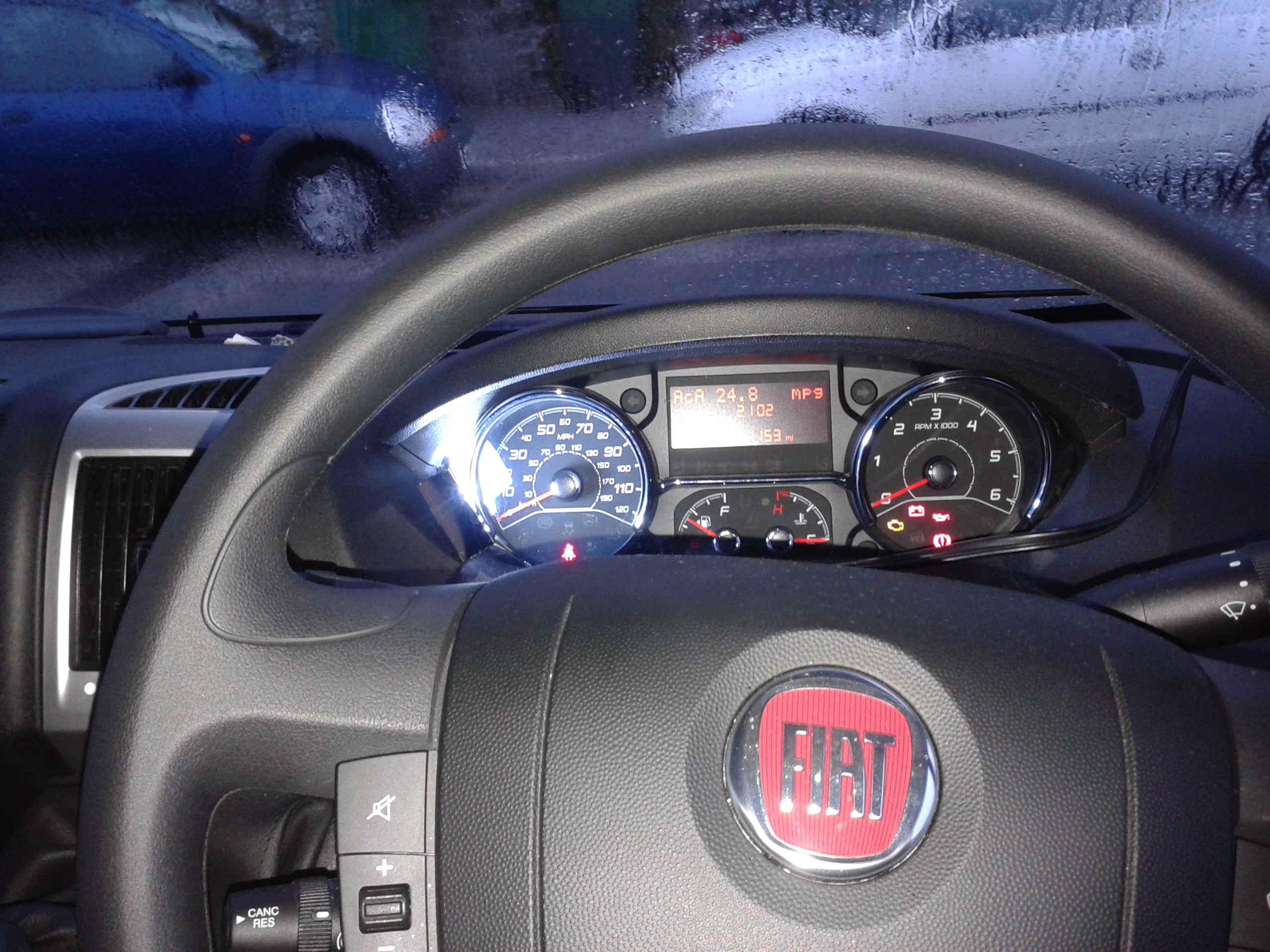

no, I didn't actually take a photo because I looked a† the view on the digital screen before I took a photo and the image it showed was really bright with absolutely no shadowing, but I will try again and actually take a pic without the flash on and see what it comes out like.

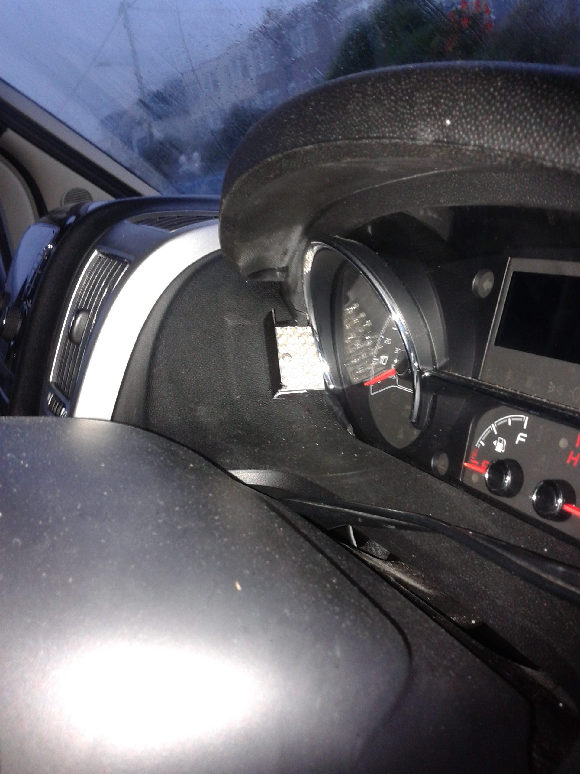

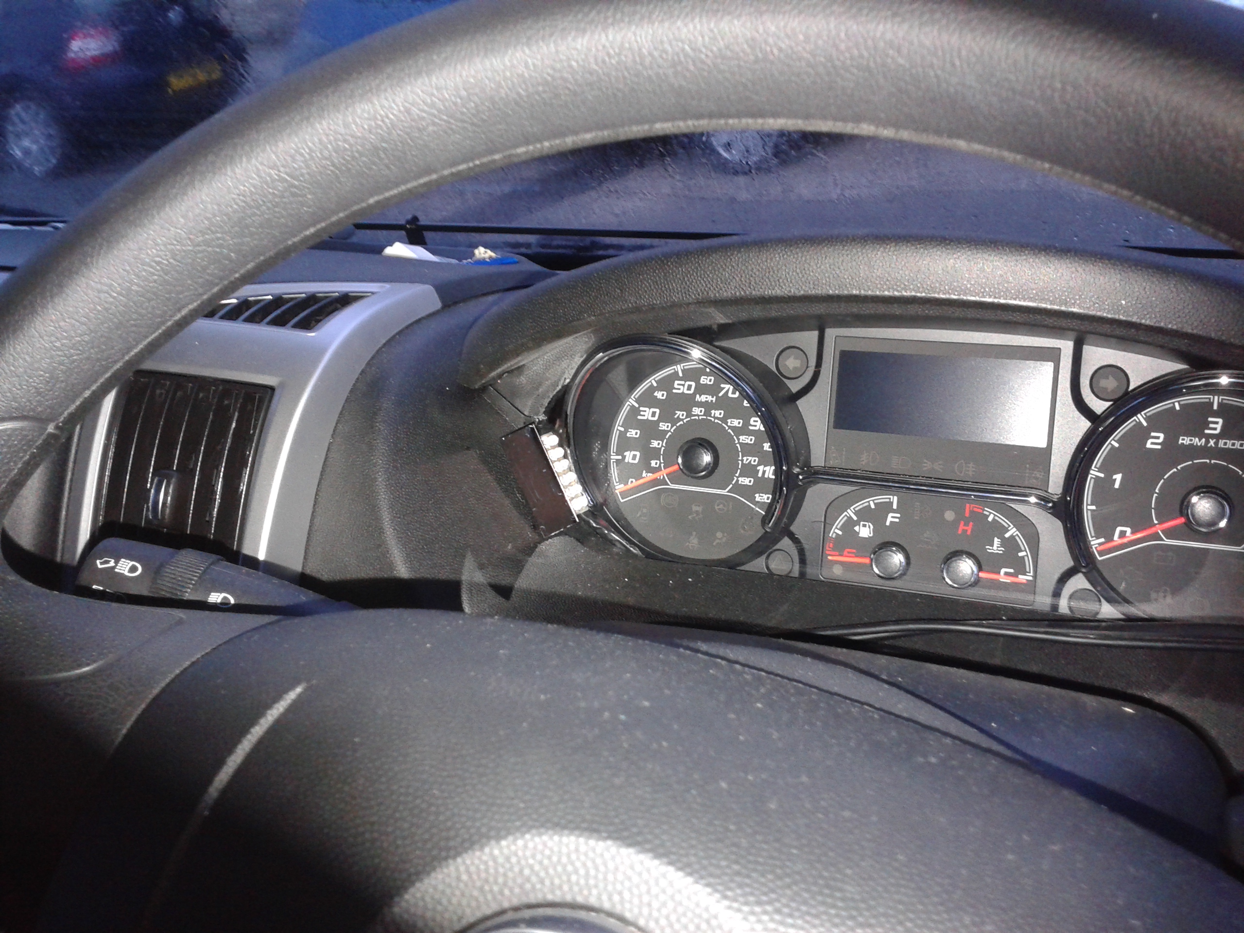

Yes I am now realizing that so am rigging up some small LEDs beside the speedo and that works beautifully, even if it is not the way the Gods at Fiat intended!!!
I got exactly the same letter from VOSA. Makes you wonder what these people drive, thats if they actually do drive ! They obviously don't have a clue about the level of concentration thats required when driving a large vehicle on todays roads which is bad enough without having to try and do head aerobics in order to "TRY " and see what speed you are travelling at.
I don't know how many of this model Ducato have been sold in the uk but I bet it runs into many hundreds, its just a pity that more of these owners have not complained about it, or maybe they have but only directly to Fiat who would obviously keep it quiet ! What we need is for someone to start something up on Twitter, I don't do Twitter so I can't do this myself.
Appart from the speedo problem I like this van and would really like to find a solution. Your idea of using the leds seems like a good idea, could you tell me exactly what type and size leds you used and if possible show a photo of them in situ
Like you we love our van too.
I have taken 3 photos of the instrument panel, none are very good but they show a panel of 24 small leds (from China ebay) screwed with one screw to the side of the speedo cowl, it really does illuminate the dial and reflection is not too bad either. They are wired through a piggyback fuse holder (ebay) to one of the live (when ignition on) fuses under the dash. Neg to any body part.
Hope this helps

Thanks for this info,the pics were fine. Like you say £48,000.00 and we have to revert to diy to be able to safely drive it. Grrrrrrr
I will follow your idea and fit the LEDs and hope that Fiat come up with a more permanent solution sometime in the future, but I'm not going to hold my breath till then !!
