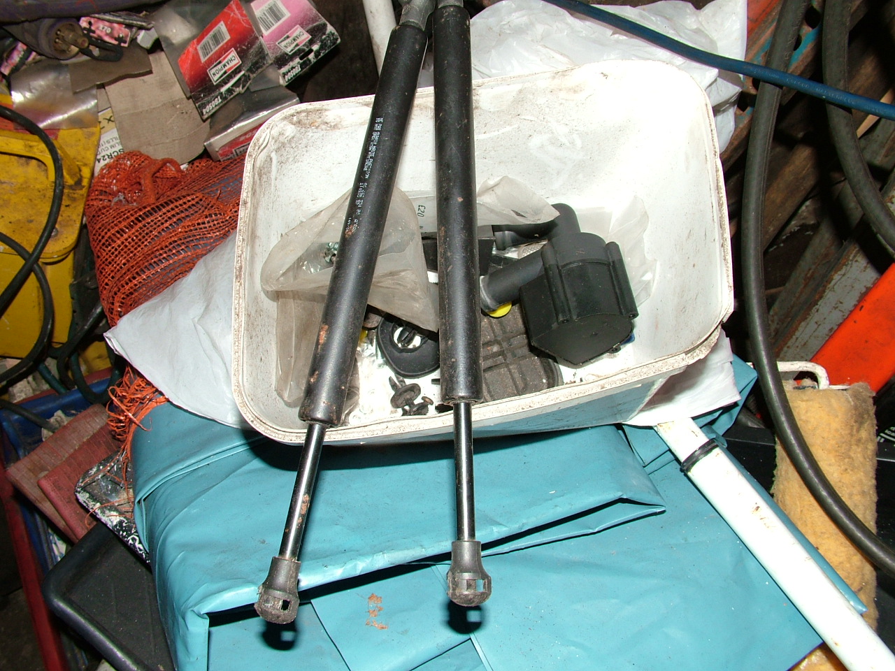

Just found two of the old ones from that C3, don't know about yours but from memory some of these were pull rather than push.

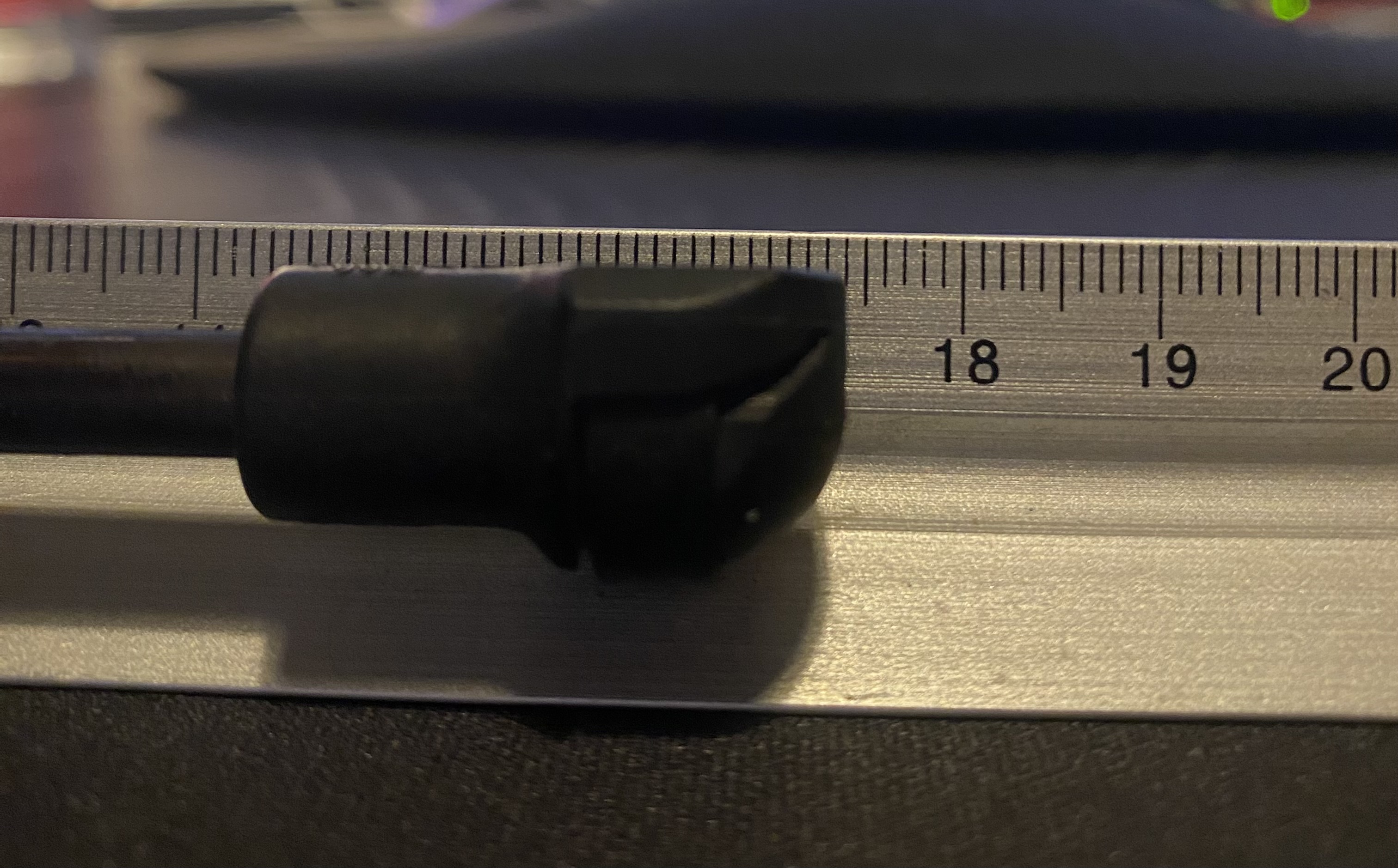

Just to highlight how small these struts are, they are 17cm long and have only 4cm of travel. so compressed 13cm
The barrel of the cylinder is only 15mm so super tiny

It is just for holding the boot open. The car was designed by Bertone and built in the Bertone factory, so I suspect they would have used an off the shelf part. A little digging and I think it maybe the same gas strut off a mk3/mk3.5 golf cabriolet, with both cars coming out in 1994.
The golf part is 174mm long with 40mm travel, which is almost exactly the same as what I can measure on the one I have in front of me.
If you ignore the increased angular size caused by the viewing angle of the camera, straight on it is exactly 174mm
Doesn't look like the previous owner was too generous oiling moving parts, looking at the rust in the cups.
When servicing vehicles I always oiled the door lock and hinges, including any swivel points like tailgate struts etc.
I know the argument can be some of these are plastic and self lubricating to a point, but even a little rust there means the joint can't swivel as freely putting strain on the strut seals possible. Though I admit those gas struts are not for longevity.:)
