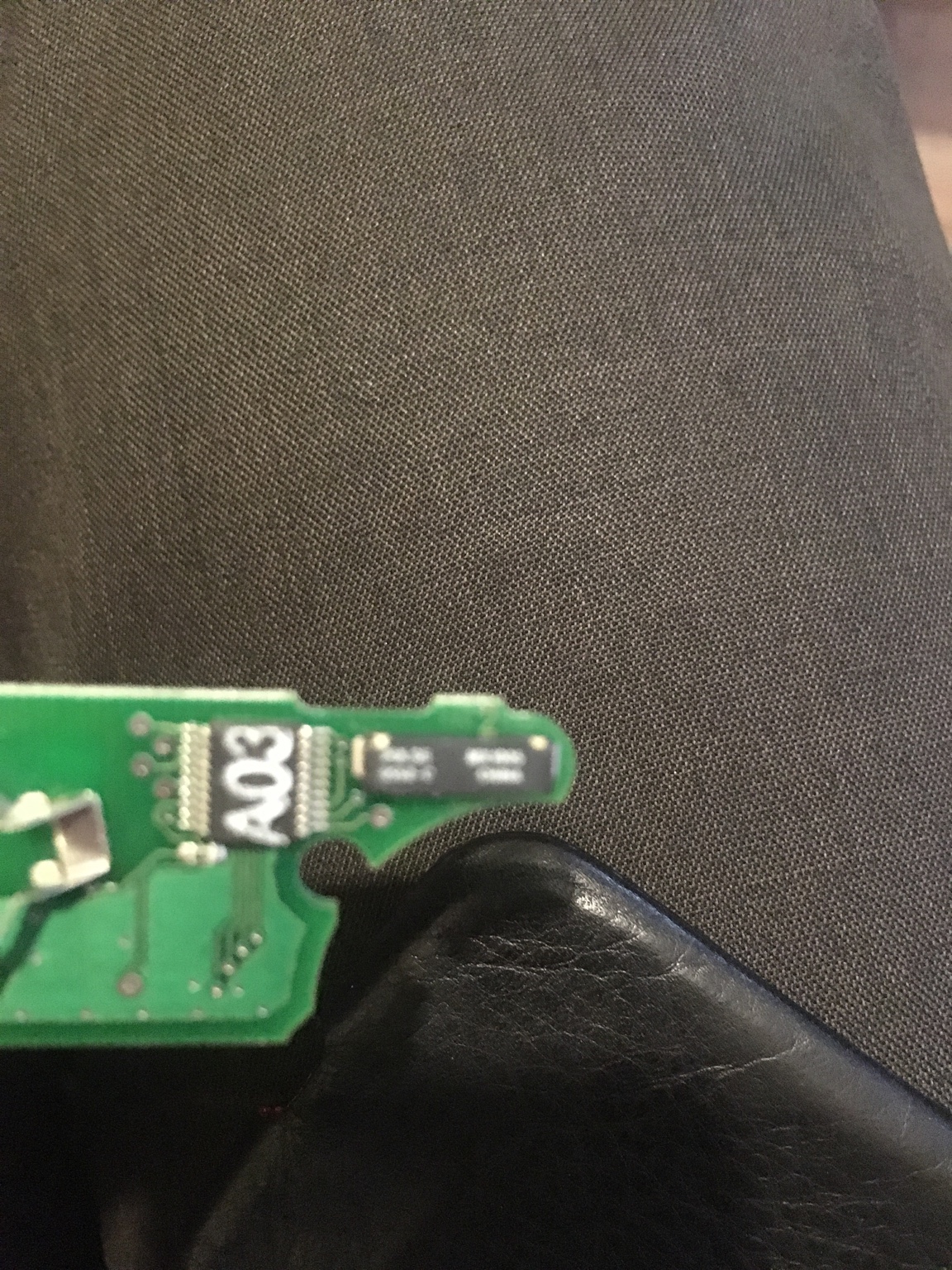

Thanks all for the info, much appreciated. Looks like I have a few options to explore! I have looked at the transponder bit on the key and the soldering looks okay to me. Attached is a picture of the part I think is the transponder, is that right? Also have found that by banging the key around several times eventually it will start the car.

yours sounds like a solder issue. Lead free solder is cack.
