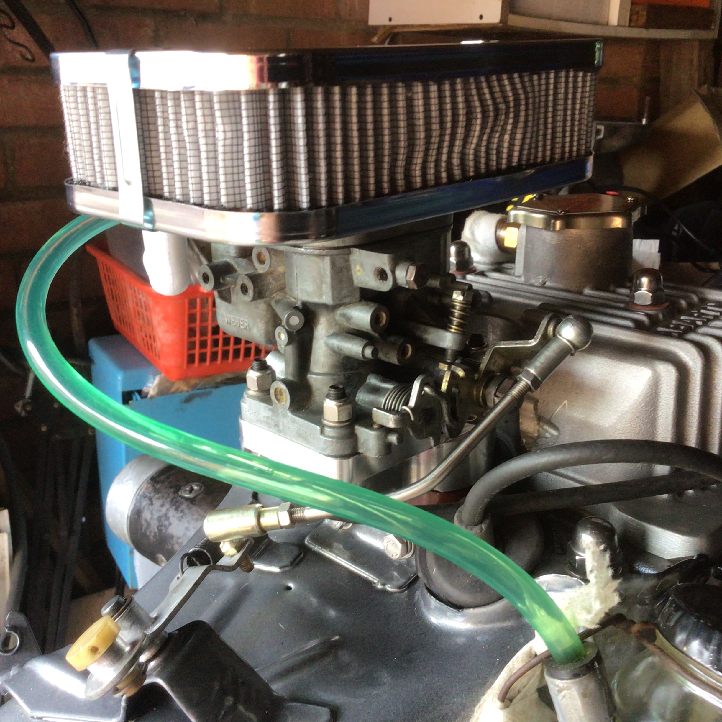

Thank you, as for compression ratio I really do not know. I put my faith in the original designers of the 540cc which came with high compression pistons so the head has got some mild porting but not been skimmed. The exhaust note seems to have quite a crack to it which is louder than I had expected. I wondered if that was down to the compression ratio as it seemed a little louder than the 795cc which was the last one on the bench. Yes it did feel quite an achievement building that from scratch entirely from parts I had here but I did have to do a bit of searching and I bought a new thermostat when the four I had all turned out to be faulty. Although at the weekend whilst searching for another part I discovered a brand new thermostat at the bottom of a box & still in the original packingWell done Dave, good job indeed - it's always satisfying to make something from all of your spares. What C/R will it run at???
