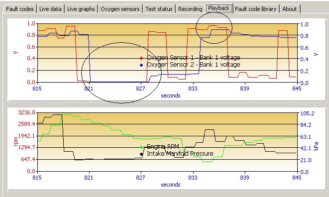

Yours is wild and goes off the charts with 0v on both sensors here and up to 1v at times. That's totally out the window
So try disconnecting that No.1 O2 sensor just to eliminate it as it's output is vital for a good closed loop tickover

On this trace you did earlier both O2 sensors show a period when they are OFF, not just showing lean which would be 0.1v but completely switched off and unable to take any kind of oxygen reading. All you've done with the car or engine is started to slow down gently at that point
