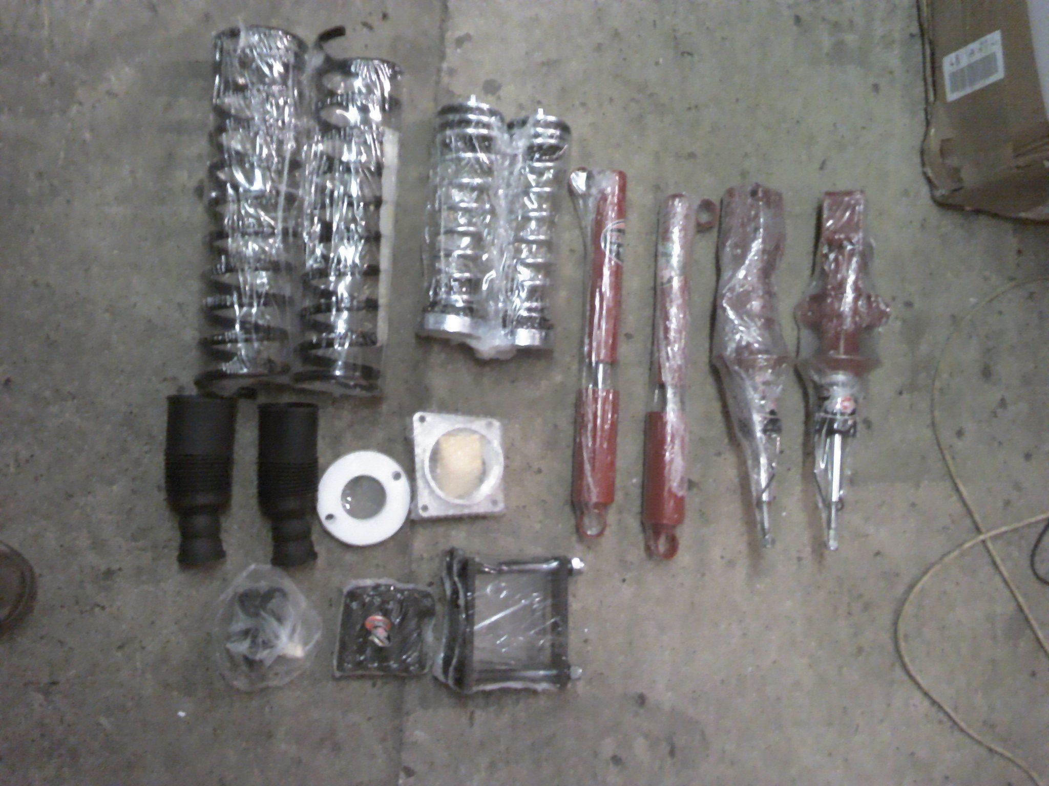

I'm still waiting for my fiat parts dealer to get back to me with proper part number for M12 bolt for strut to hub .... as fiat ePer shows same for 2wd and 4wd - we all know that they are different!!

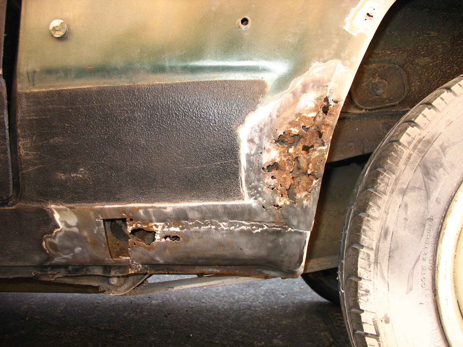

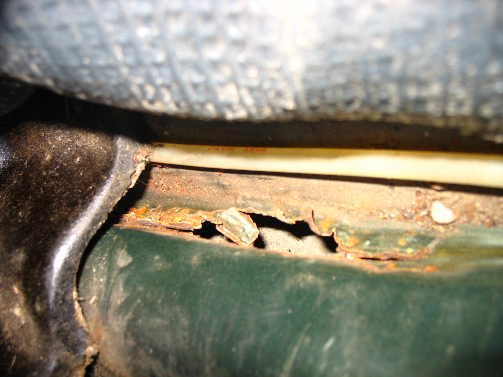

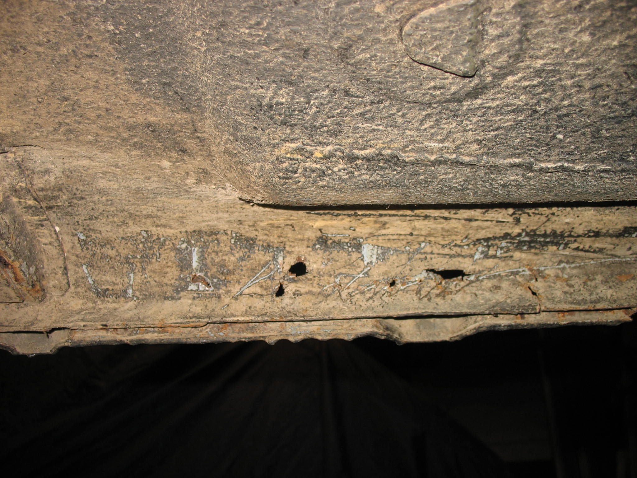

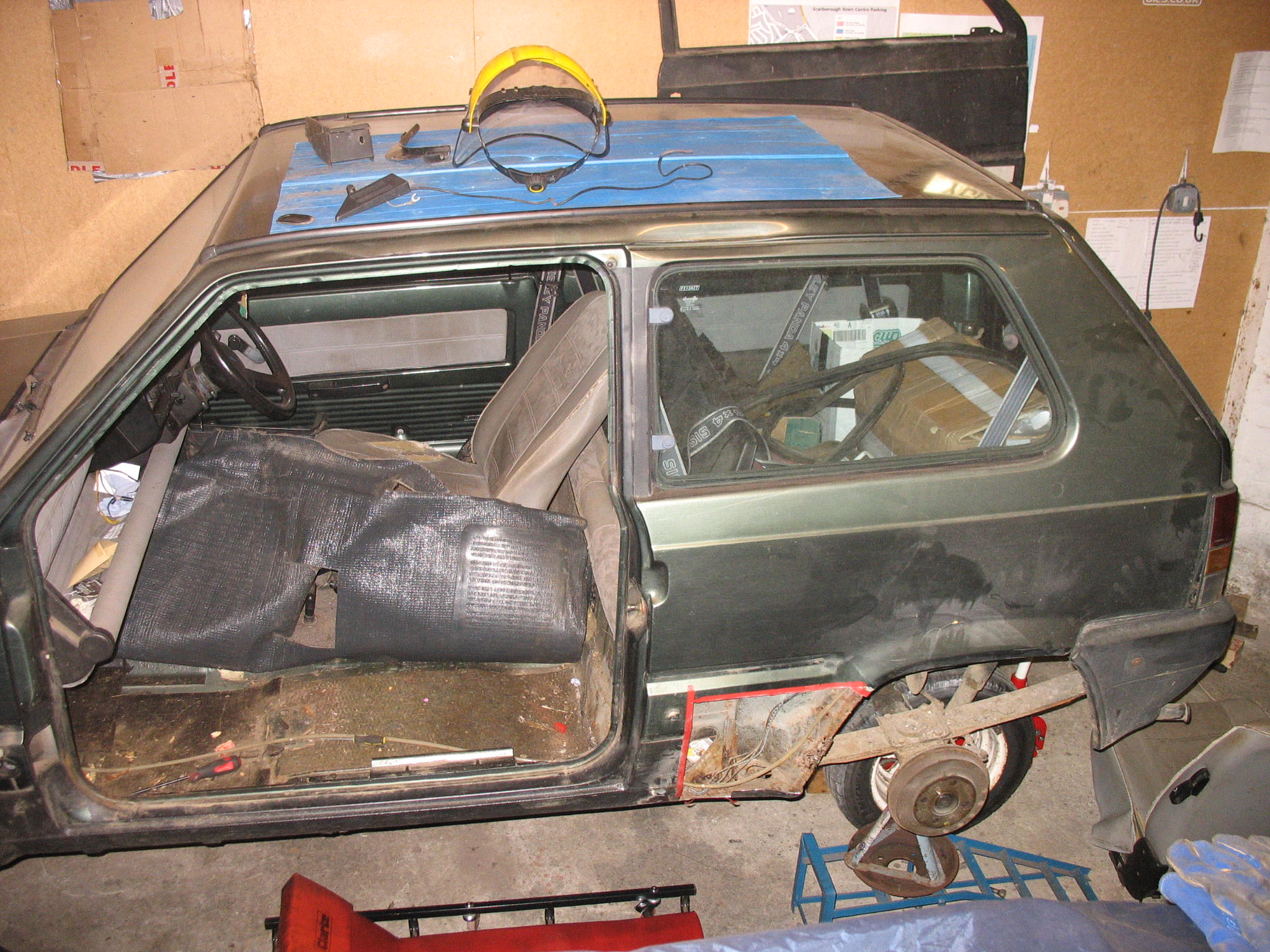

Had a go with the Sisley's rusted sill ends.
This is how it looks after some brushing out,
As you can notice some repairs benn done in past - yes, it is front part of o/s sill welded on n/s back end... does not give my much confidence in the level of previous repairs.
Spend at lest 30 mins poking around with a long spike and decided to go fo it...
RUST PORN
PS. i don't have any repair panels so end effect will not be show room condition but at lest its going to have some strenth
Coser look on
As the bottom edge of outer sill is loose, the palne is to cut allong and have this sorted as well
Aperently the fllor and outer sill is in good condition, inner sill in approx. 8-10 inches lost his contact with the bottom seem.
Will keep me bussy for a while, opposite end does lokk better from outside - i'll just patch this up, i don't want to look inside - for now.

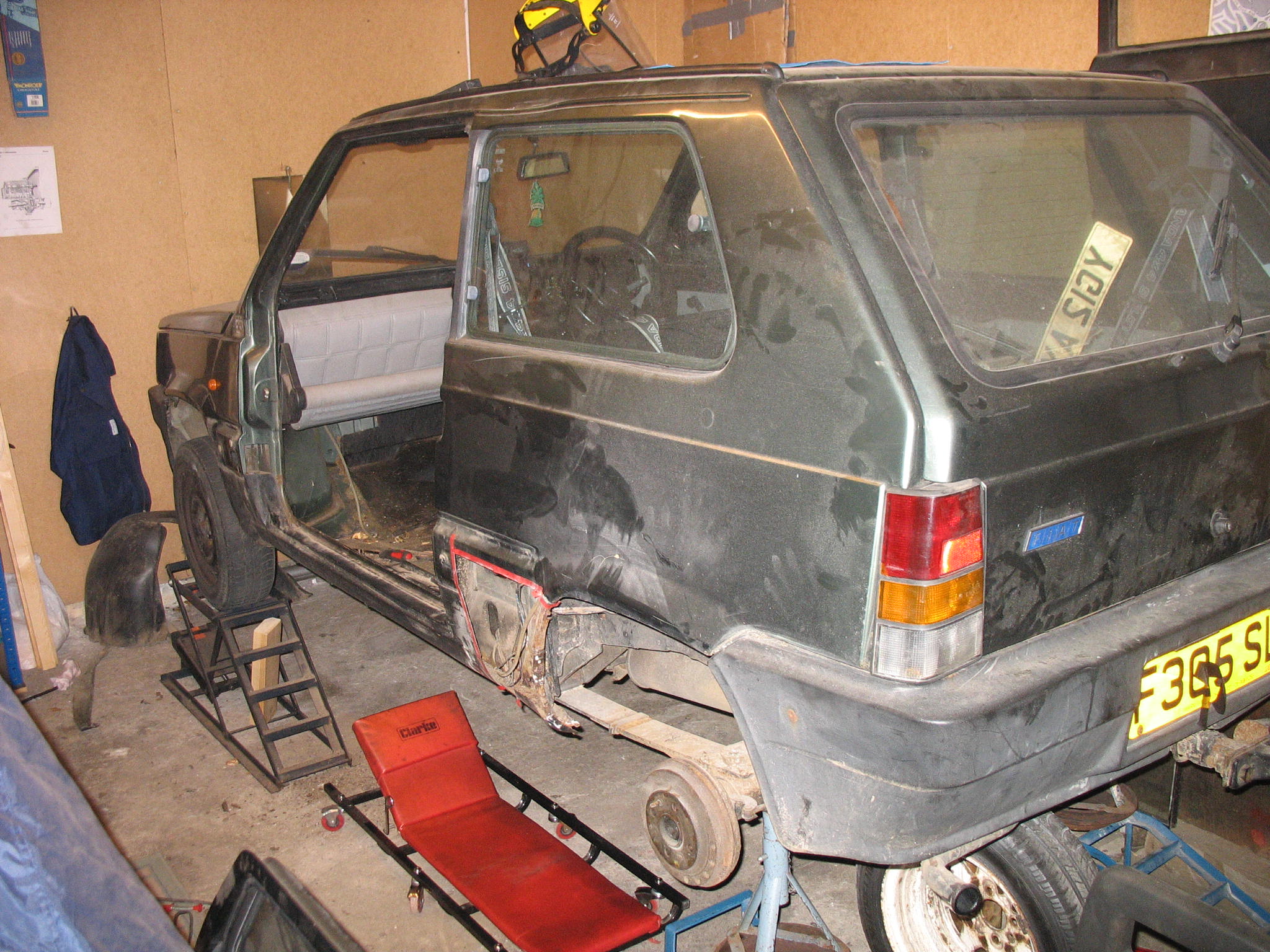

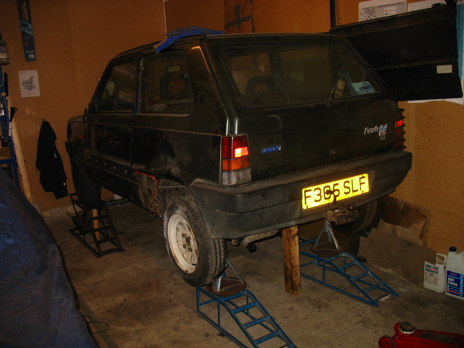

Spend some more time getting the full view of wich areas are badly affected.

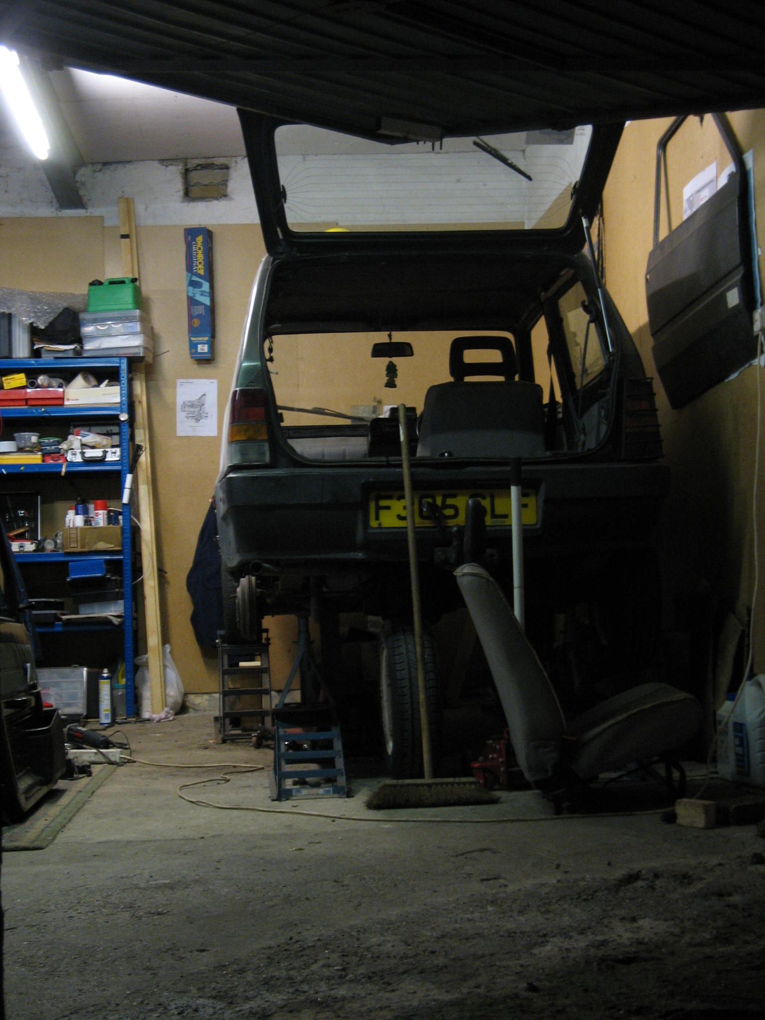

Started with lifting the car to reasonable heigh to work on
Ended up with this

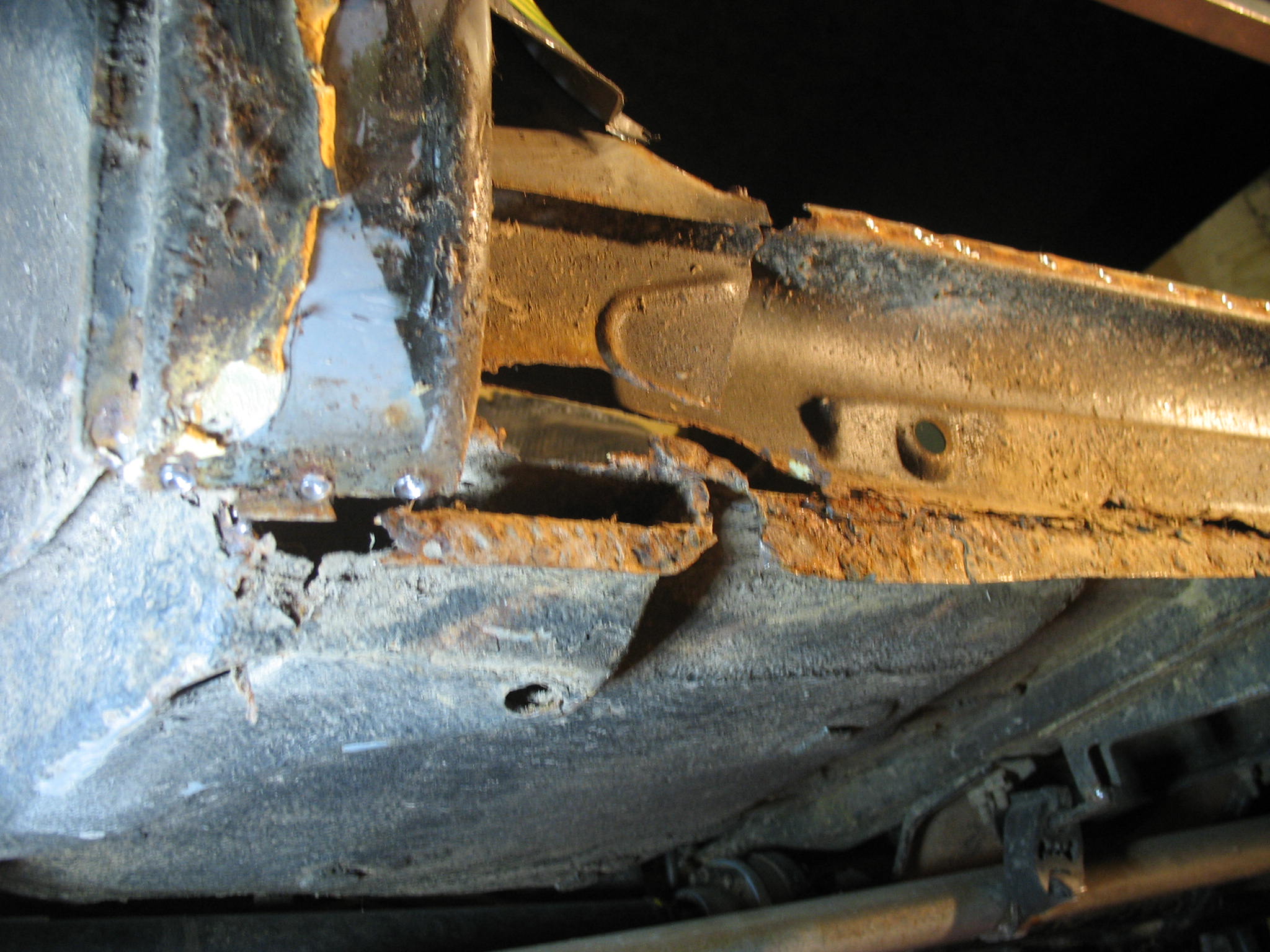

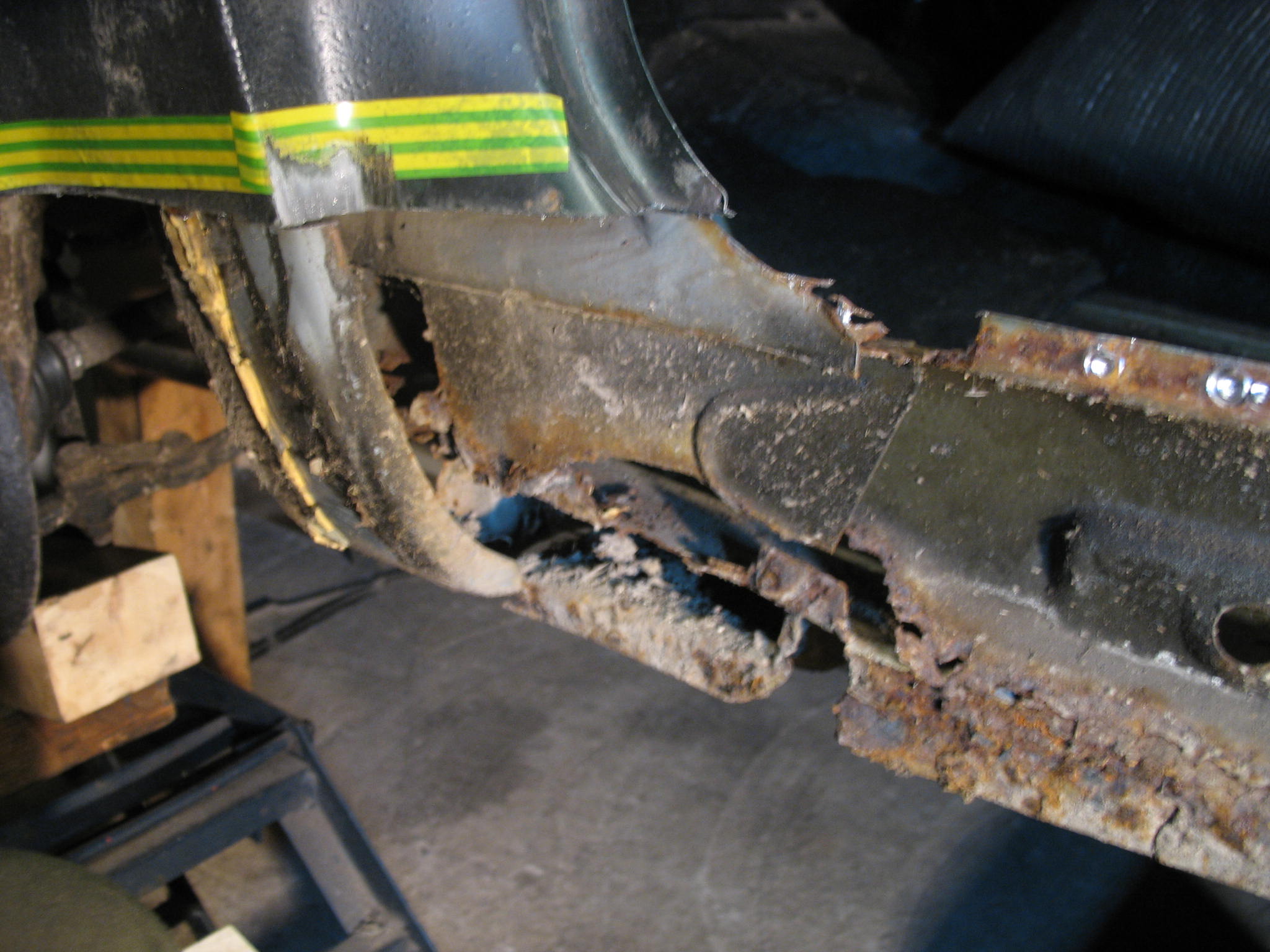

Points of concerns are as follow:
- whole front sill corner,
- front half of inner sill,
- jacking point cross-membrane,
- funny bracket bolted to the floor from underneath,
- small part of the floor,
- all not listed.

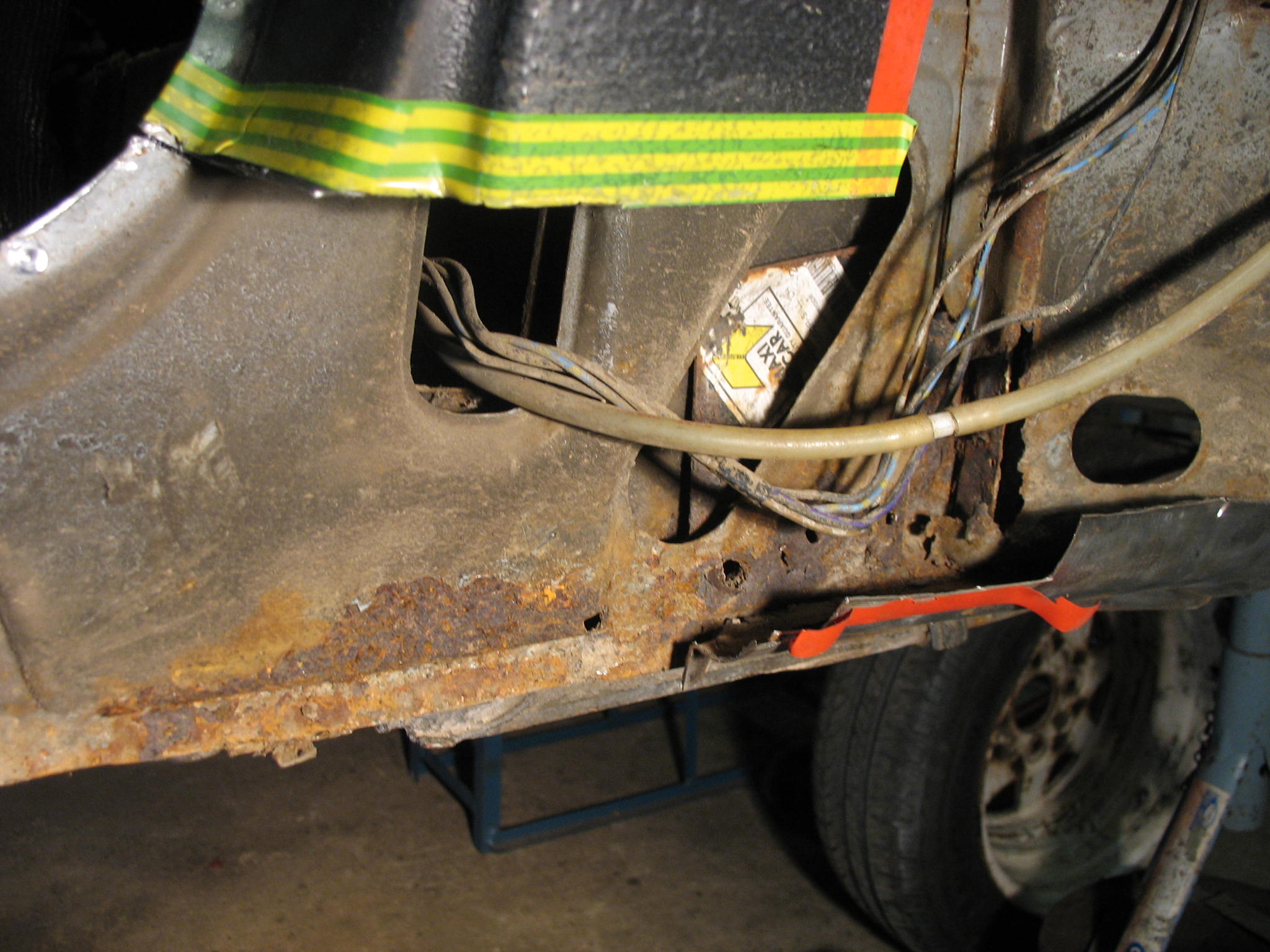

Front corner
Front floor

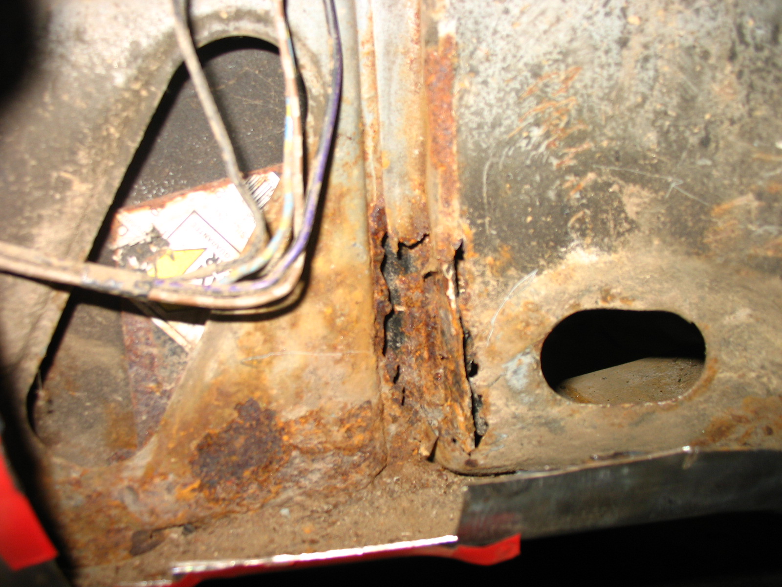

Cross membrane

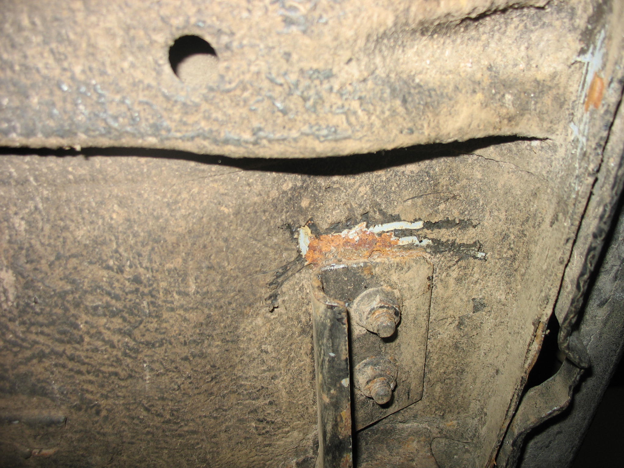

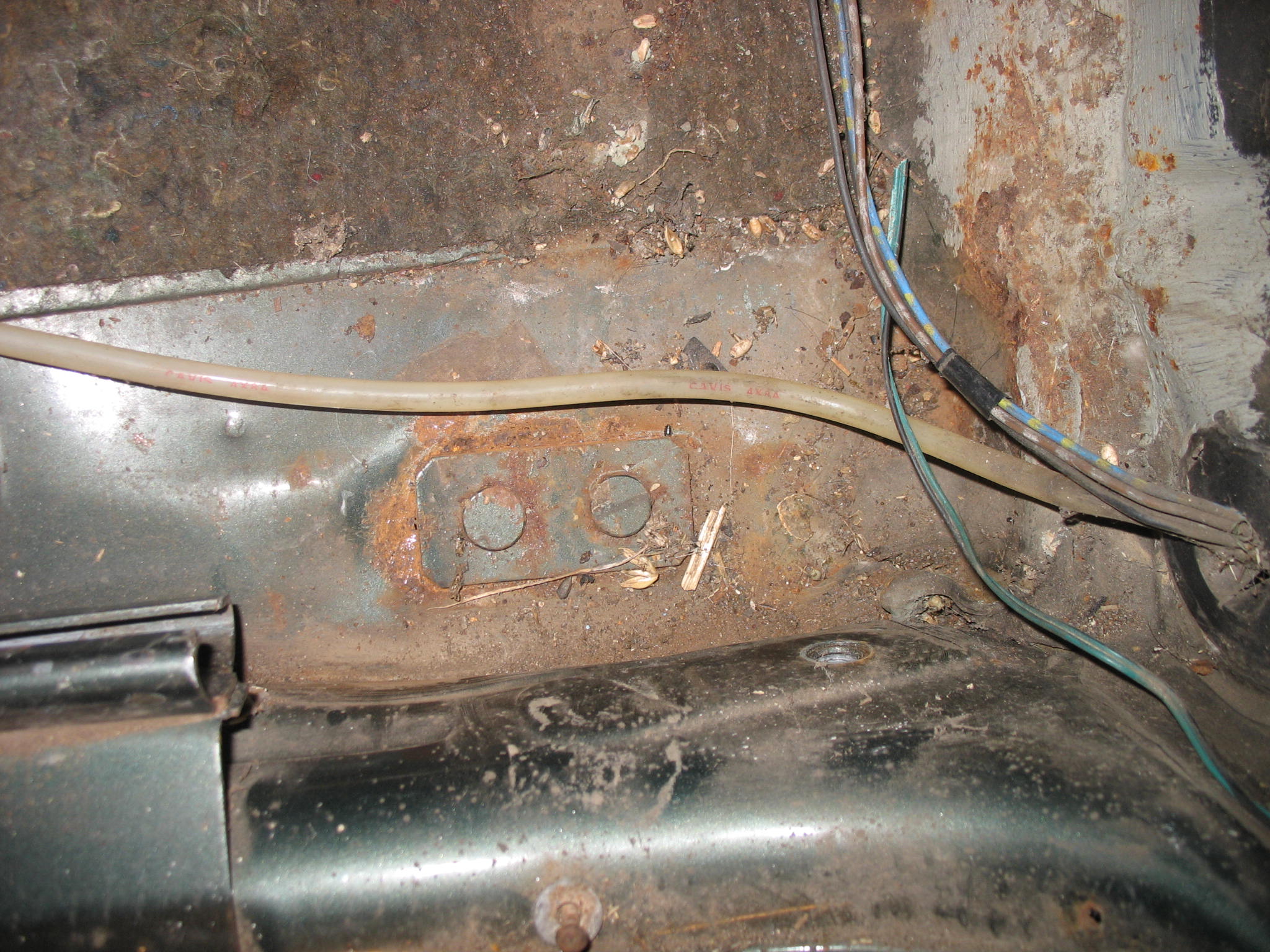

Funny braket, ther is tiny hole thru just next to the plate.
Question: if i'll undo those bolts - does the plate inside gose loose or is it welded to the floor?

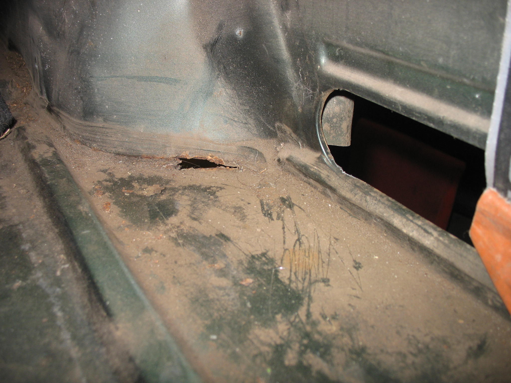

Floor pan - rear, some bodge job been done thre already - some rust under seatbelt mounting point.
Top inner sill - easy.
Inner sill - front

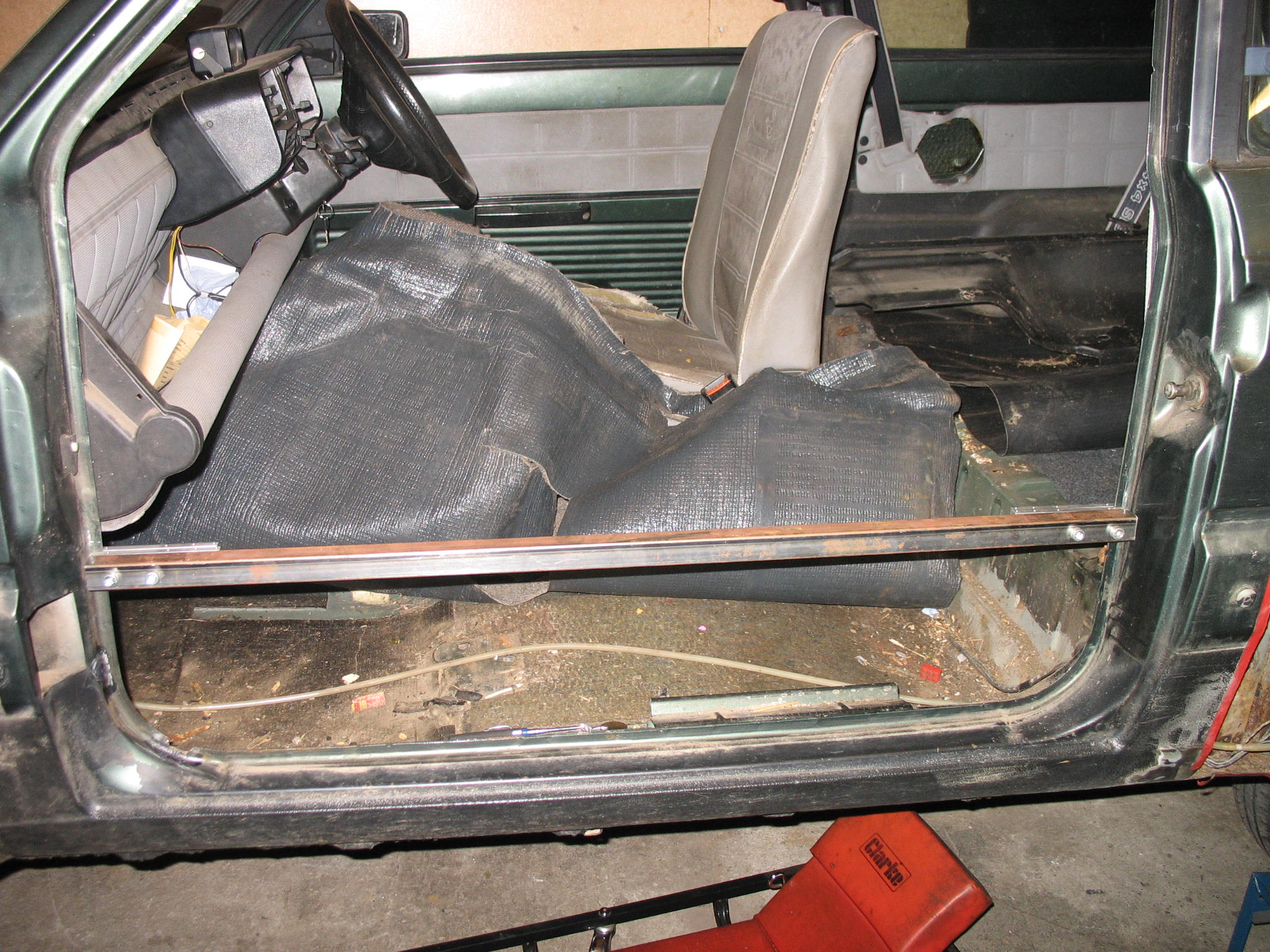

Lost to do, i'll be bulding temporary door brace.
Still to decide: cut along outer sill or remove spott welds from top edge/seam and take the whole lot off.
PS. this car was last MOTed December 2013- passed with just few advisories.

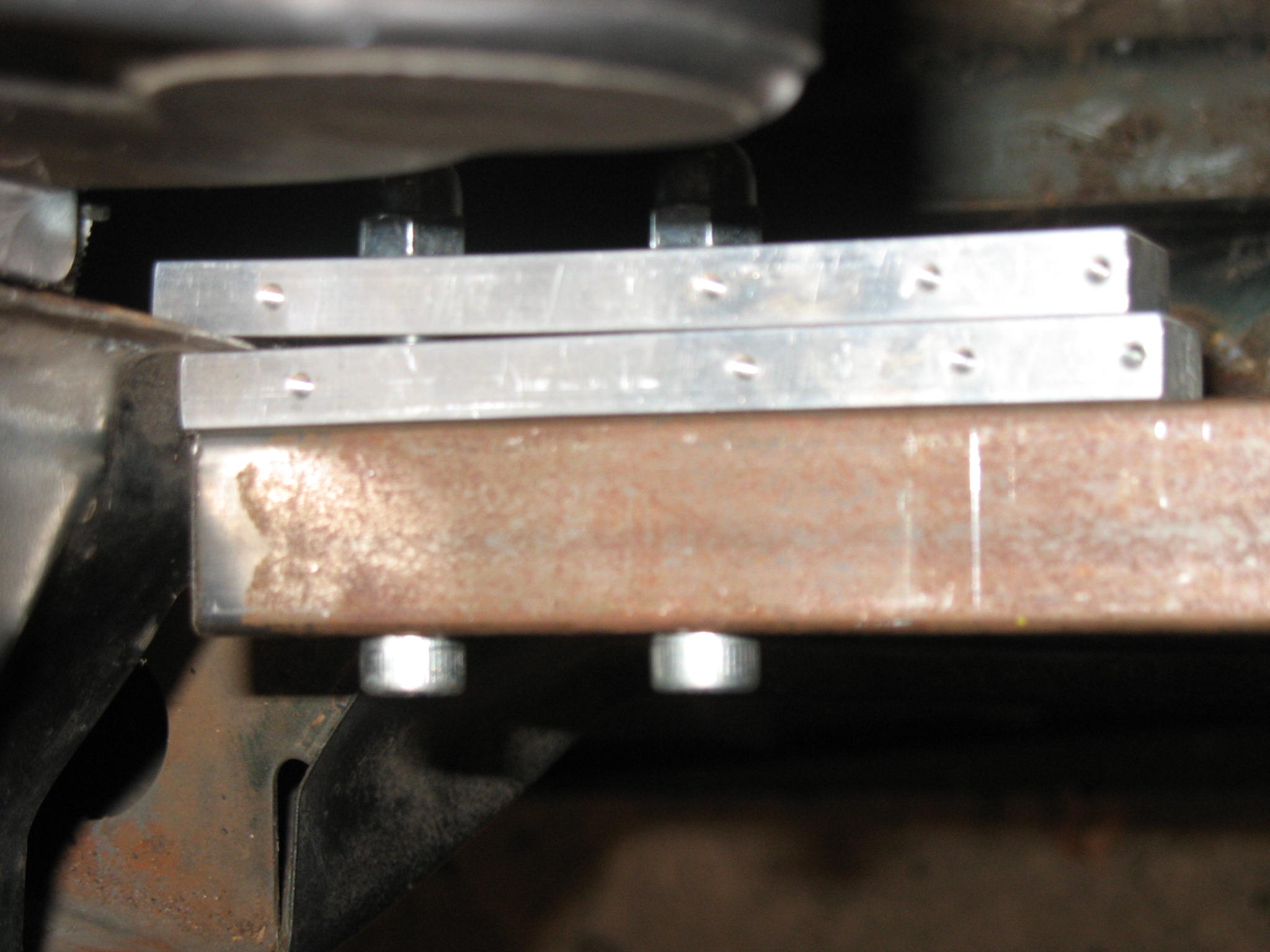

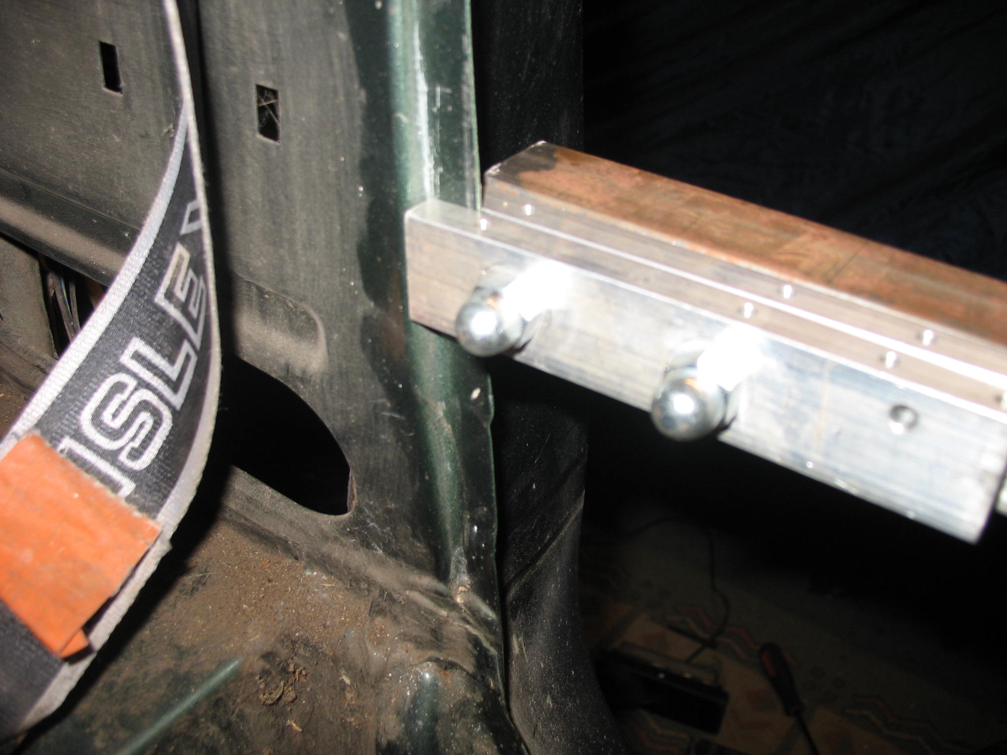

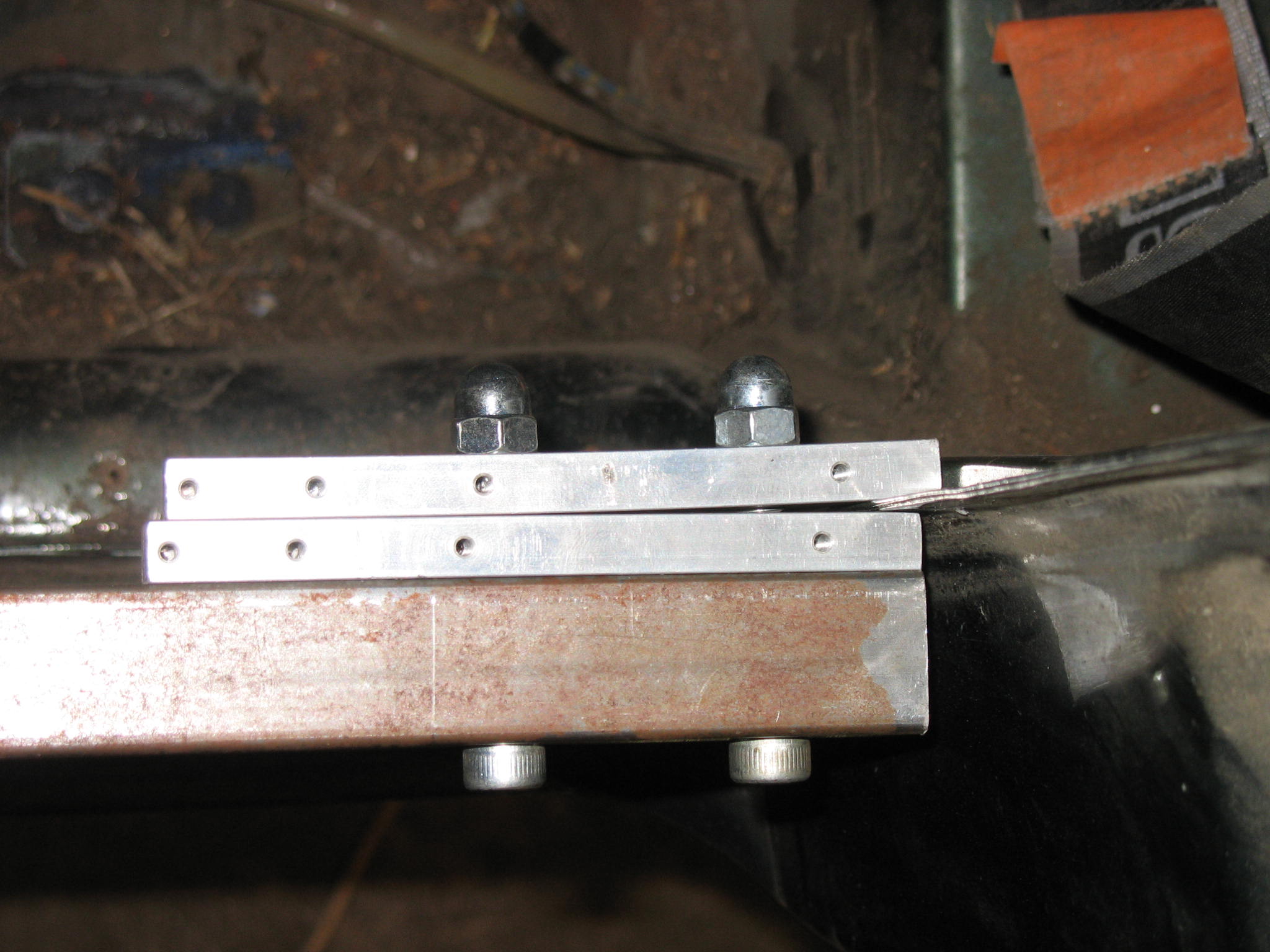

Door frame brace mounted in position.
As the longest piece of box steel was actualy to short few cm, i've gone for fully removable type one.
Four bolts, few pieces of alluminium and you can actualy rock the shell pretty much. Enough for it's original function.

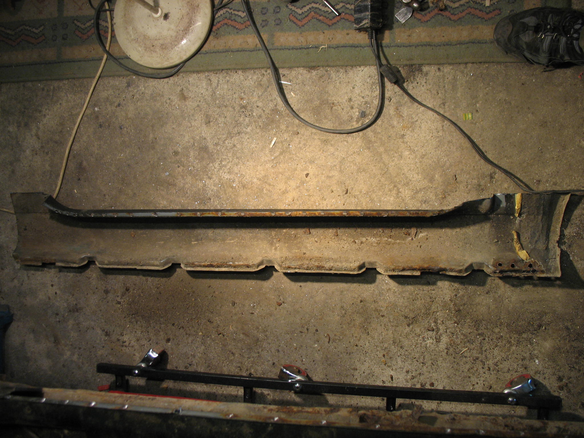

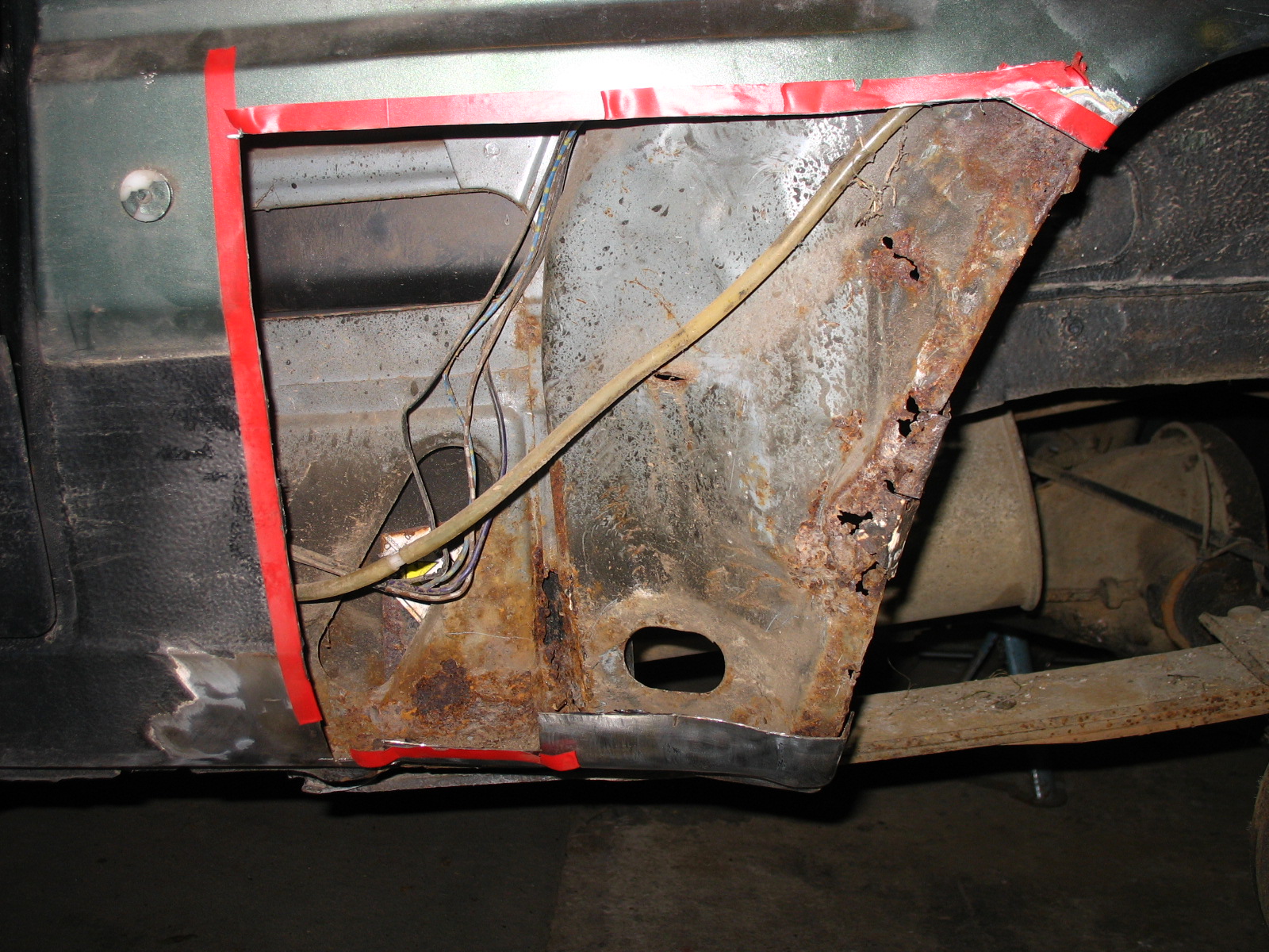

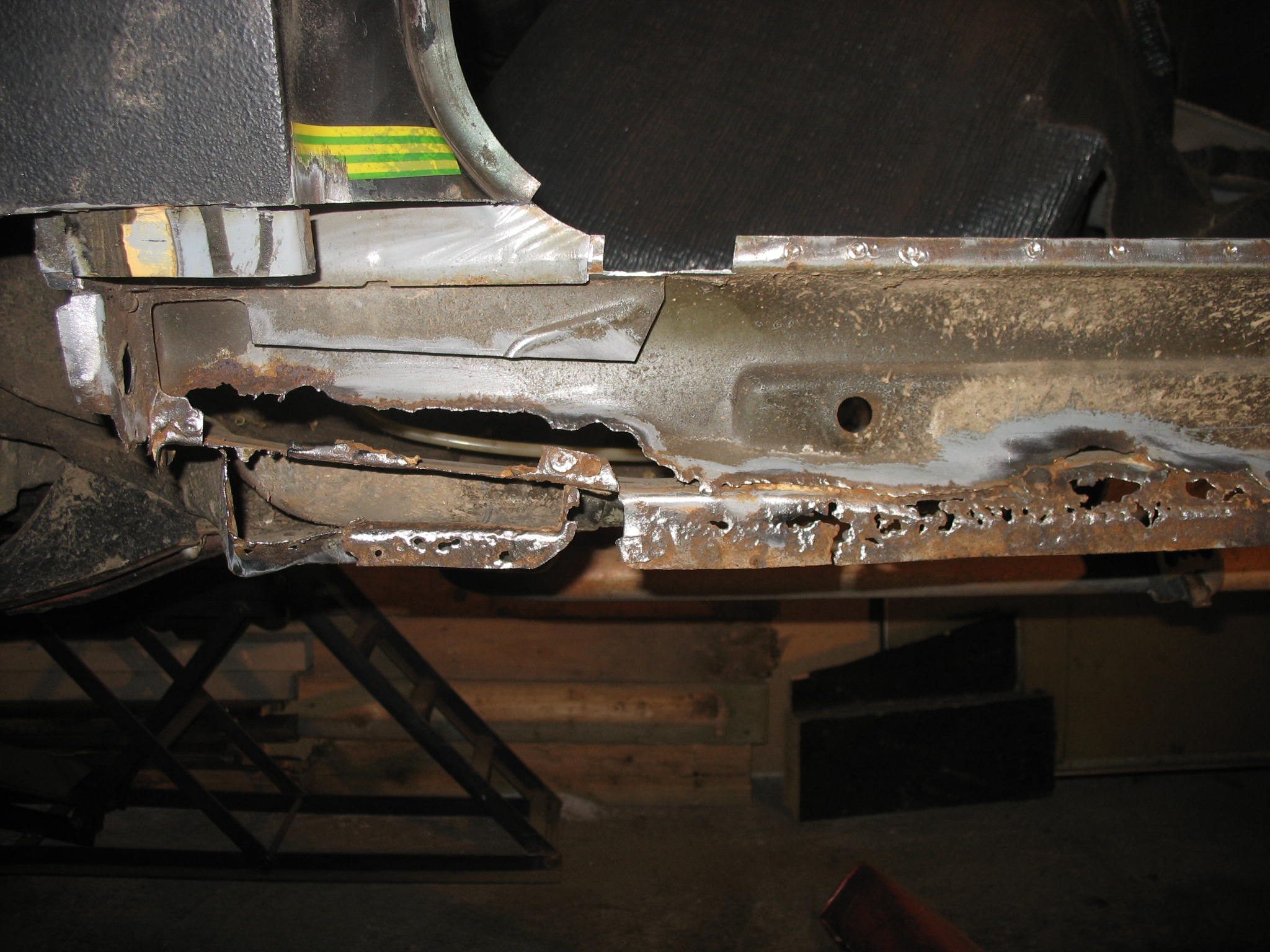

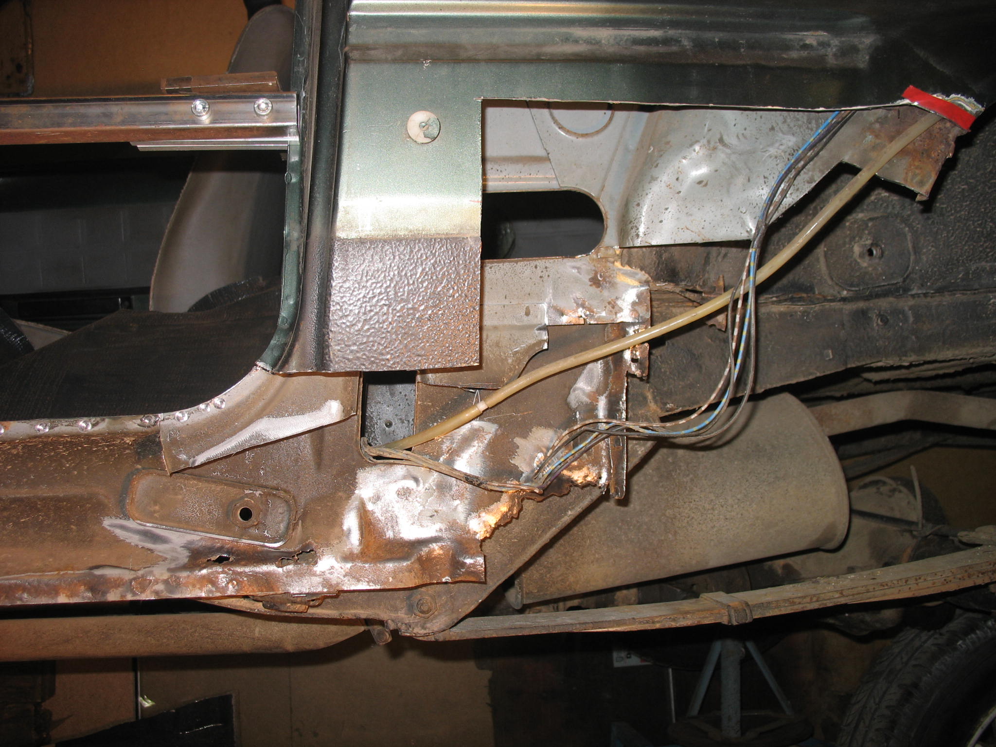

As I'm under full steam now - those are results of todays well spend 2 hours.

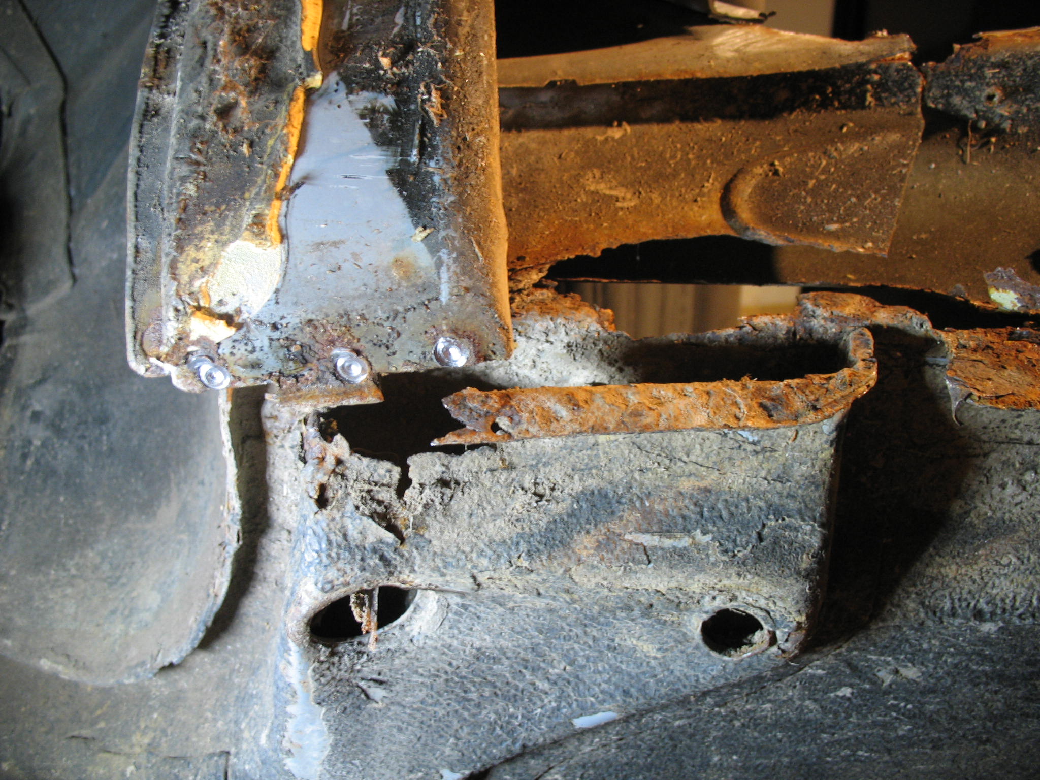

And full scope of what was hiden under the sill.
( comments are welcome - is it bad?)
This plate will have to taken off as there is already 5p size hole next to seat belt mounting point.
Other then cosmetics outer sill looks reusable.

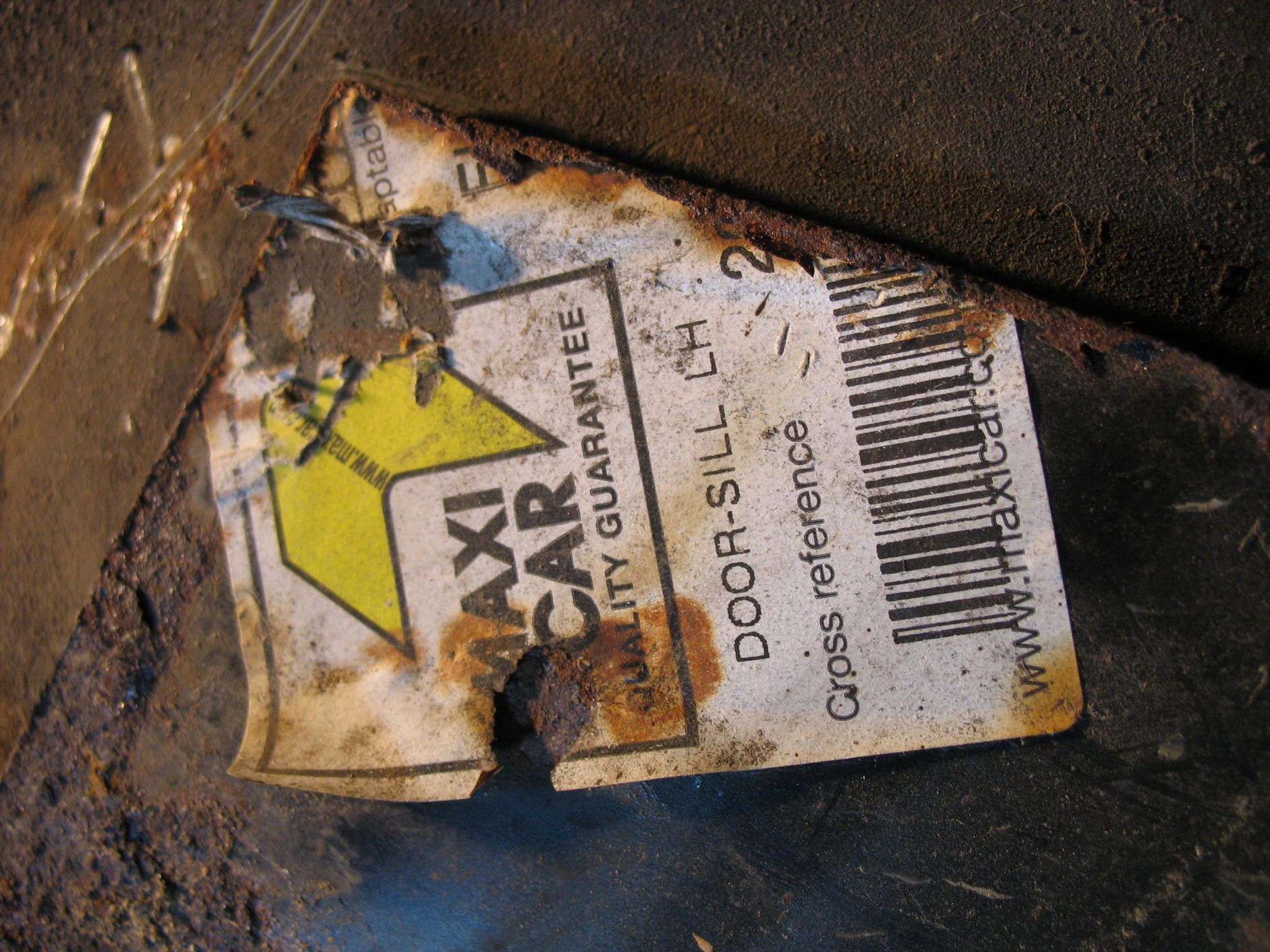

Based on what i've seen and MOT history it looks like that the inner sill repair panels were available in early 00`
Unless somebody did matched this section from other make/model panel but it had exact same shape and was a pressed out from one piece.
I'm just about to start cutting out the rust bits, it might sound easy - but you definately still need a plan to do that right!
and rear section

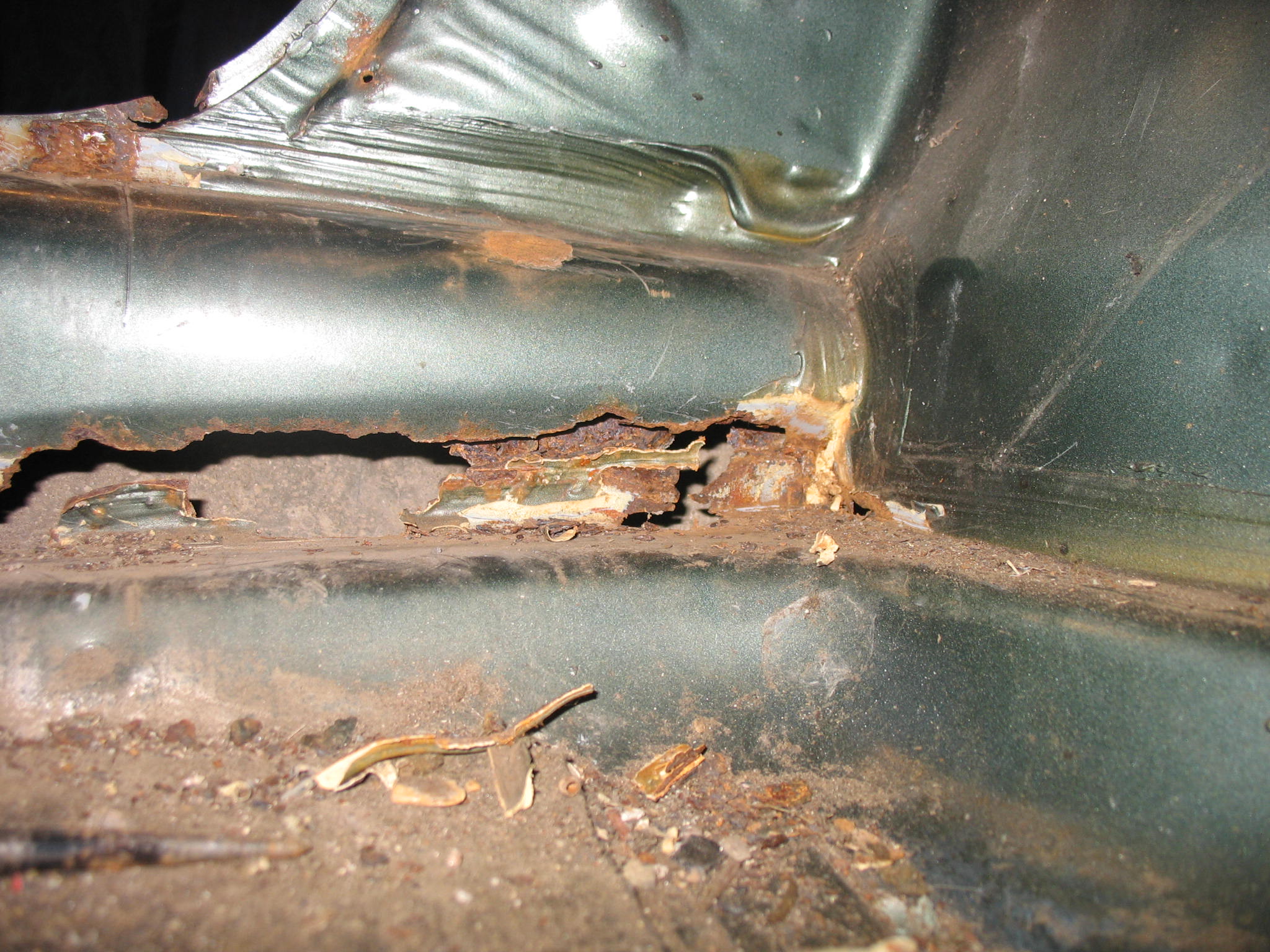

Still need to decide how to tackle this one, it's not only the hole thru.
Chassis leg/ floor/ inner wheel arch seam three inches towards the rear is "infected" as well
