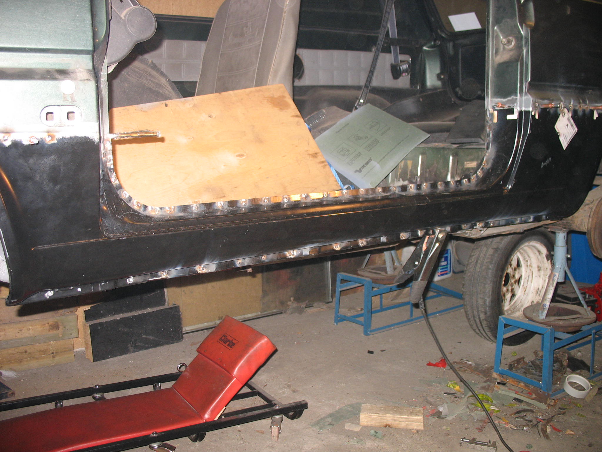

Rear scuttle next to chassis leg end fixed up,
Driver side rear inner sill end bodged up - hope it's will be fine for mot purpouse.

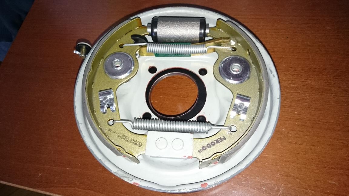

Handbrake might be to do with that two-part elbow that goes into the drums, if you take the drum off and disconnect the cable you will be able to see if it has play in it. I need to replace this part on mine for the same reason.
Cheers Andy, hope this time it'll be fine with just good service. @Bartpanda any advise on where to look exactly? replacement part? IIRC you've sugested 126p moded to fit panda?
Ill get the new shoes fitted as well, this might add the missing few mm for the over all diametter to cut in.
I'd also be interested in a replacement part for this :)
It may be worth putting a new cable on if you can get one in time, anything to get that extra few millimetres ;)

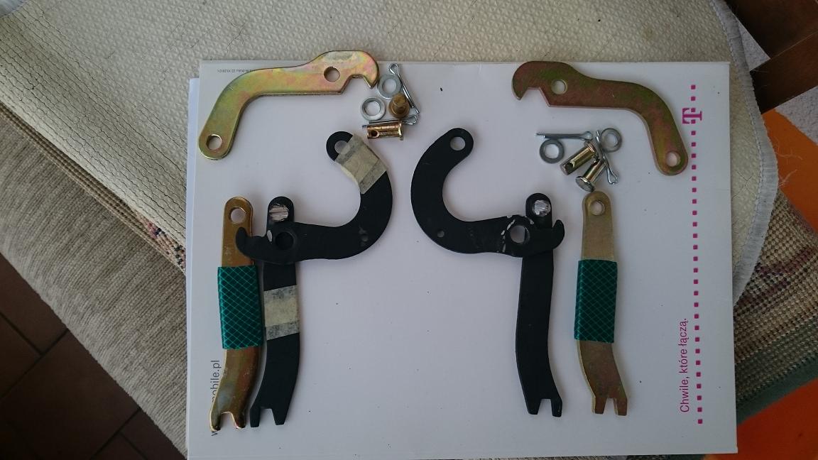

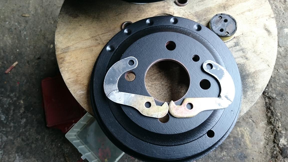

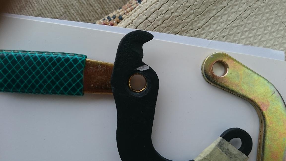

126p parts are 100% the same except the angle of the arm outside the drum, I could not find original panda parts, so bought set{ left and right} from 126p and cut/weld part from the original panda 4x4 arm, I did not replace the whole part, because there was 1,5mm play in the hole for the pin connecting this parts.
Black is 4x4 set after acid bath and painted, gold galvanised are 126p parts:
oversized hole for the pin
welded arms:

It failed!
Apparently the welder left 20p coin size hole somewhere close to rear susp front leaf mount at driver side.
Verdict- not bad, retest tommorow so i'm shortly off to the unit tohave a look and give the a ring to confirm the location.
