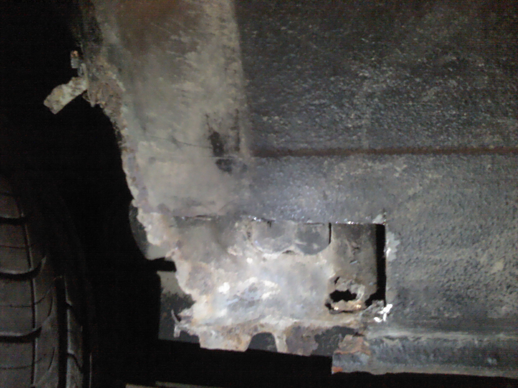

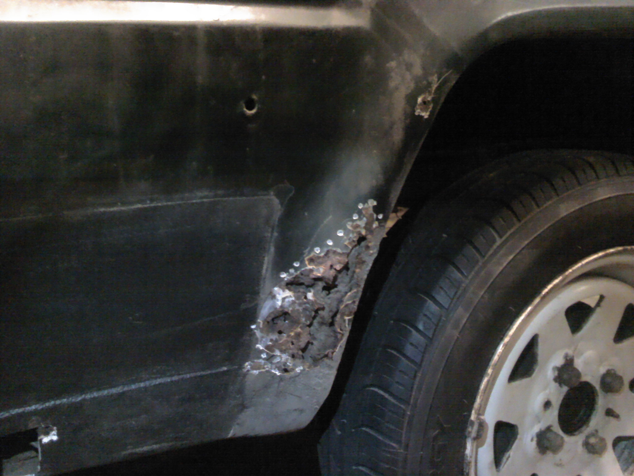

Sisley is currently on SORN, as there was not much point of attempting MOT with holes in both sills.
That was during "first look" just after buying the car, not its a bit more serios.
As usual after taking the trim off the panda rust porn was seen
Almost invisible with the trim on, just to mention the plastic bunk/plug from inner rear sill was missing (as you can expect due to previous repair)
www.maxicar.com Inner LH sill - can't find any references to repair panels on google, according to MOT history both outer and inners sills were done in 1997.
Oposite site is coroded a bit closer to end of the sill.
Probably I'll wait with the repair till Trac tyres, lift kit will be available as the sill ends might be modified to give bigger clearance.
