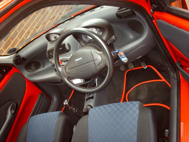

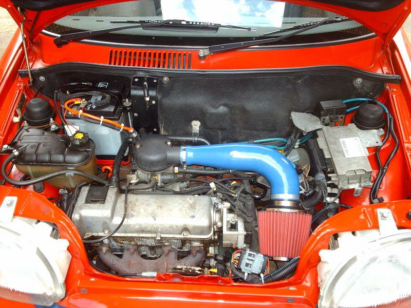

If anyone else with a Sei could point out anything that may be abnormal in the pics, and the characteristics of their car, then I would much appreciate the feedback.

Right. Some bright spark has cross threaded number 2 spark plug thread. Grrrrrrrr. In the meantime I've just put the new plug in with force and lots of lube, get the thread repaired when/if the head comes off. The old plugs, they were rusty and looked extremly old, it really wouldn't surprise me if they were originals.
Also replaced the air filter and put some injector cleaner in. Halfords have a fuel filter on order for me. The slight miss at low revs has gone now, yippee! It still seems to idle rough though. I think I may be able to hear slight bottom end knocking too :(, not 100% on that one though.
The coolant cap is leaky, can hear it hissing when the engines off and it's warm. I'll get a new cap.
Had a look at the petrol cap, I have no idea how to see if it's leaking, but when I filled it up from empty, there was no hiss. Where do I get a new one from?
No puddles or leaks from the fuel tank, can't see any damp patches or evidence of leaking either. Just turned 50 miles and the gauge is about 4-5mm from halfway:eek:

Can you tell me, if you rev the car to say 2000rpm when it's warm, can you see coolant in the expansion tank being disturbed. Ie. it looks to me when I do it that water is splashing in through the pipe that looks like it's coming from the throttle body.
Also, do these cars have two lambdas? I thought I read in the Sei section someone talking about a primary and secondary.

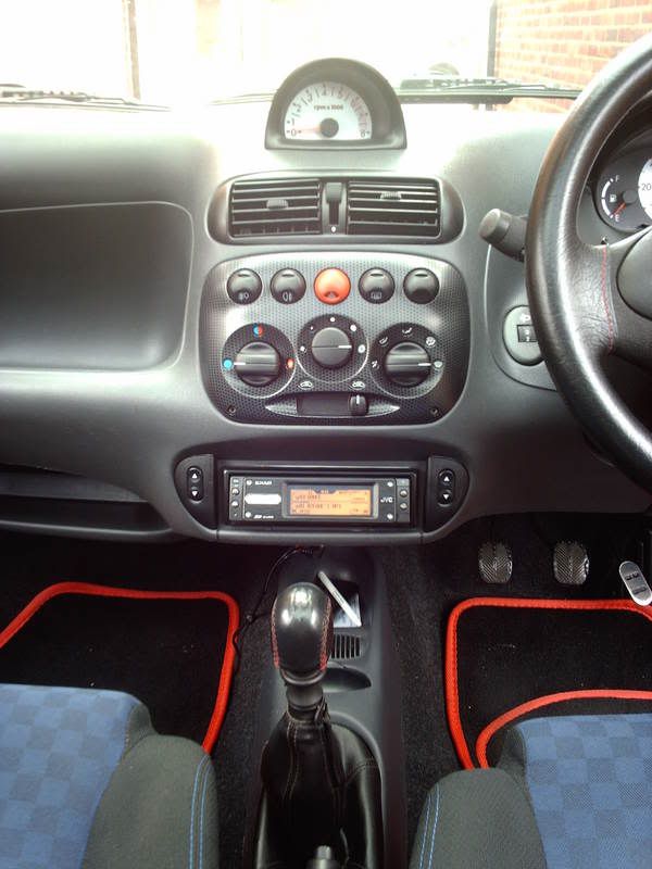

It now has remote central locking thanks to the alarm I fitted (woohoo, so simple yet so nice to have). ICE is progressing nicely also.

-JVC KDLHX552
