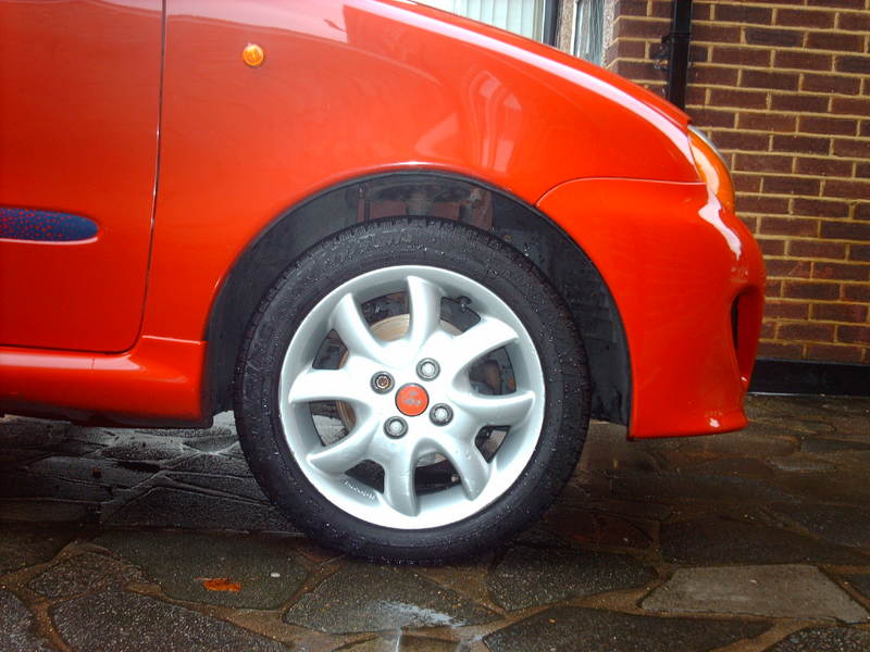

I T-cutted a few parts of the paintwork, most notably the roof the immediate area around it. After a polish of the whole car it's like a whole different red!
Also fitted a GSR cam cover, bought oil and filter today, need to find some engine flush. Then I need to get the clutch cable replaced (as a precaution, got some serious mileage coming up) and sort this engine mount that I have a thread on in the Sei section.
Car now ready in maintenance terms for it's trip to Lancaster (through the Peak District), done the following in the past few weeks:
- Forte engine flush, used and abused for a tank (crap that came out with the old oil was testiment to it's powers)
- Engine oil drained and changed with Selenia 20K, filter replaced.
- Complete cambelt cover fitted (the numpty who had the cover off before had cut a substantial part of it away to make it easier to fit back on :bang: Don't blame him/her though, was bloomin' hard getting the new one on!
- Replaced clutch cable (with excellent help from here)
- Fitted a nice loud airhorn, noddy-horn no more!
- FIATForum stickers, wooo!
Plans for the future are money dependant (insurance mainly). Peter has plenty of ideas for me :D
Immediate next plan is most likely going to involve a Supersprint system including sports cat. Am liking the idea of a PGT braking system change too, insurance don't want anything for uprated brakes :D

:D Reminds me of what both my Sei Abarths looked like from standard then the serious modding fun begins (y) it looks very tidy and the red is also a nice colour, although red is abit normal for me! GSR stuff looks tasty too!
