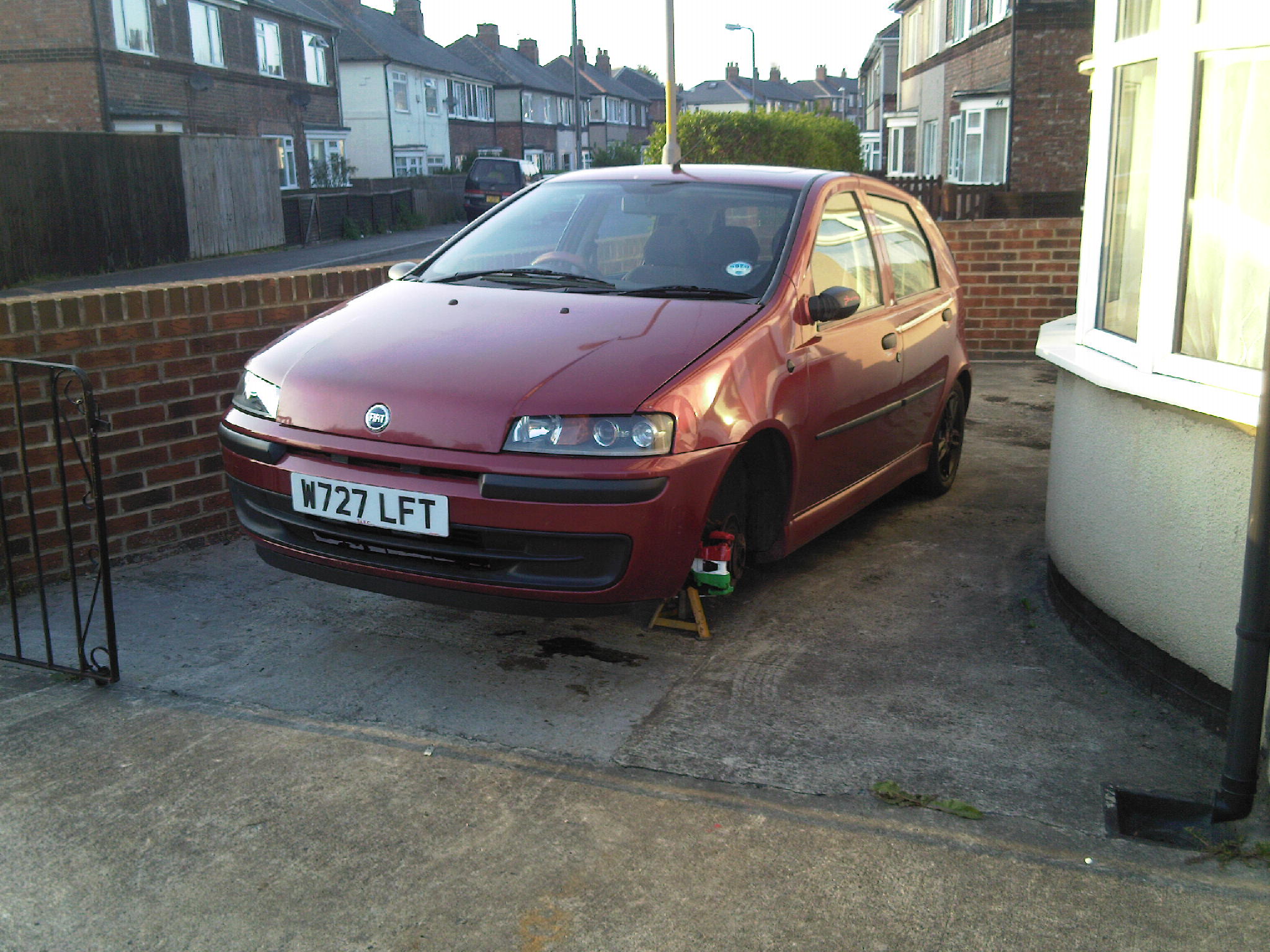

Ok heres my punto when i got it 2 years ago
i bought it for £500 off my dads mate who said he needed a cheaper car for his son, Its a 1.2 16V engine 5 Speed gearbox wish 55k on the clock wish FSH and new clutch, coilpack and HT leads soo WIN! lol BUT it looks too old aged month later the headgasket goes!:cry:

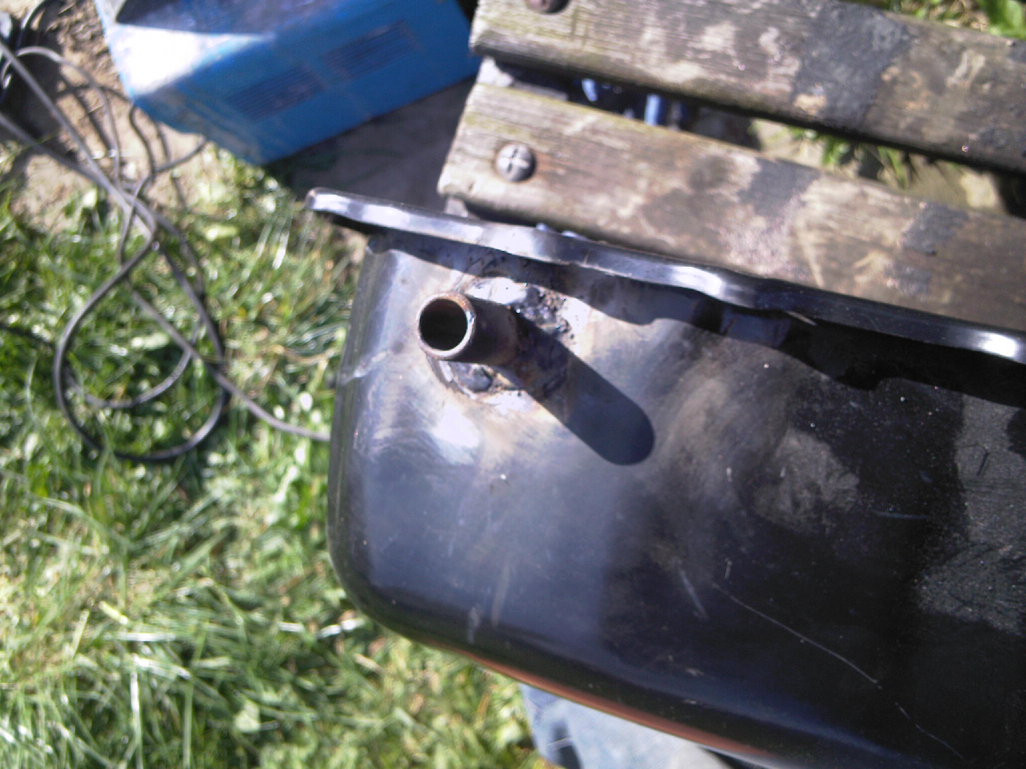

My oil breather was split anyway so i used some blue pipe and cut a hole into the intake pipe :) this made the car sound very throaty! i like it alot!!!

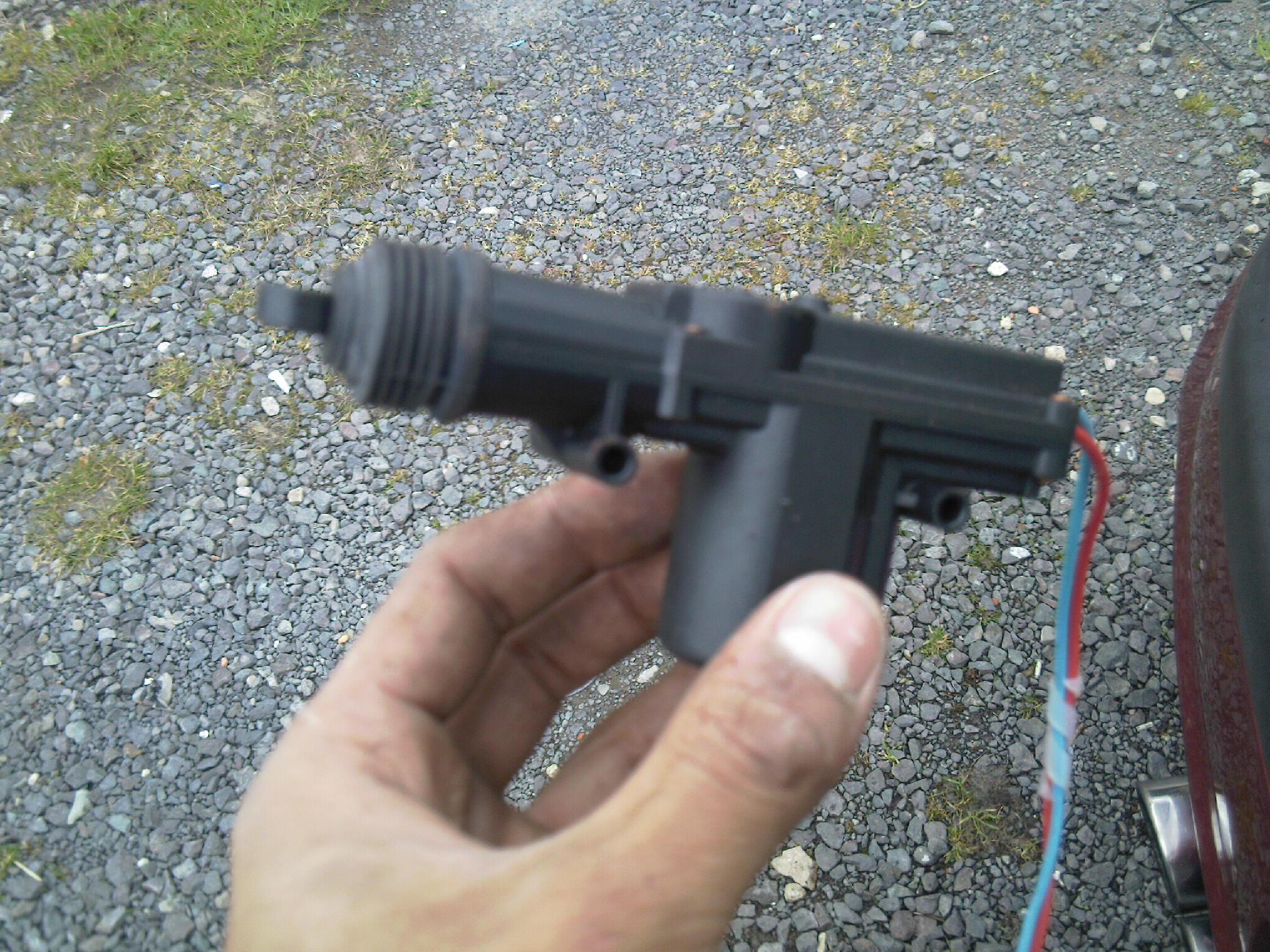

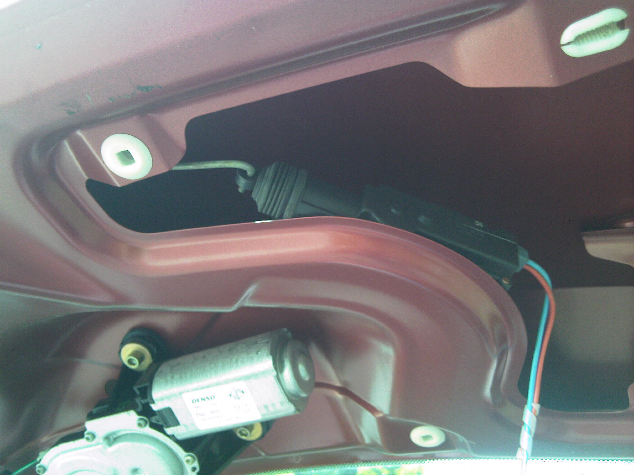

this is for a aftermarket alarm system which has the boot opening function.

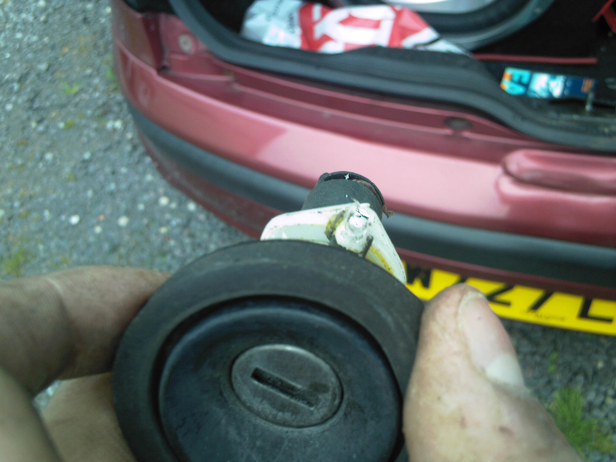

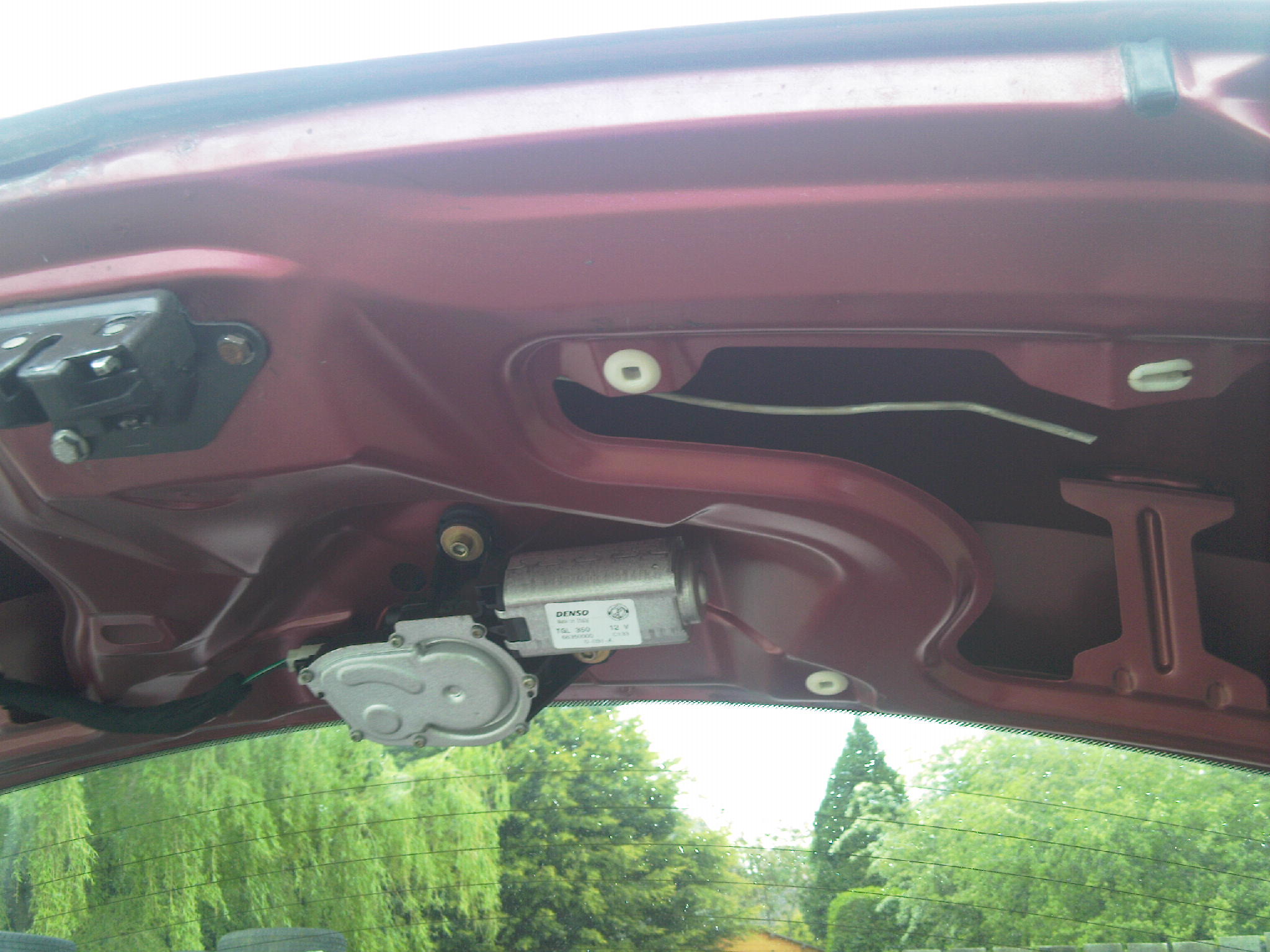

first i took the rear lock out and drilled a small hole into the white plastic clip
then attached the lock, i managed to find a old mr2 door with the metal bars so i cut them and plased one end into the hole and bent the end of the bar so it wont slide off.

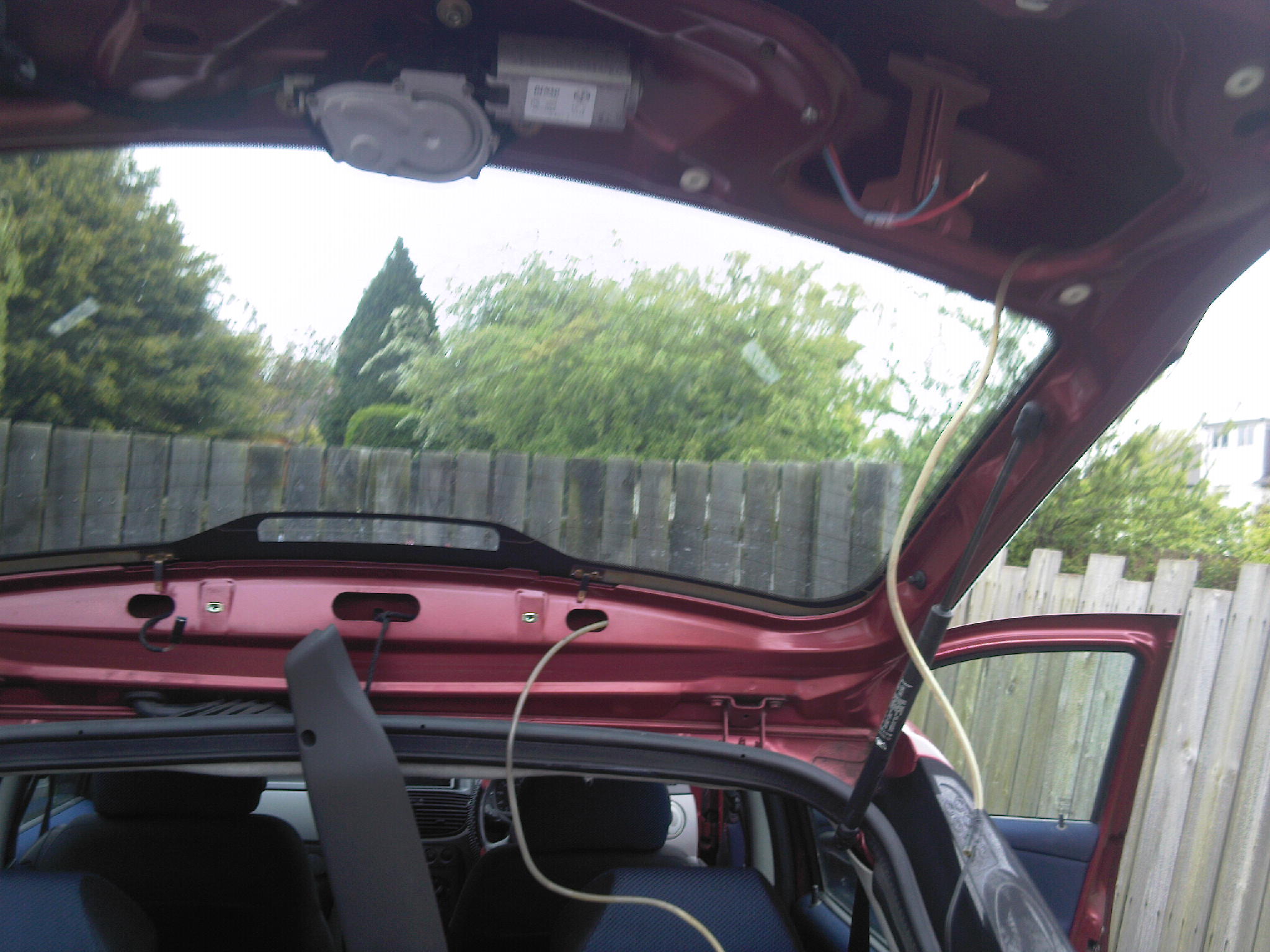

offered up the motor and drilled holes and screwed it down, this is where it should be
used a pipe to thread the wire thru
wires cable tied down and pushed thru the rubber between the boot and body of the car!
in this case my alarm uses a negative pulse so i connected a wire to the perminant + and the other end to the alarm pulsed negative!

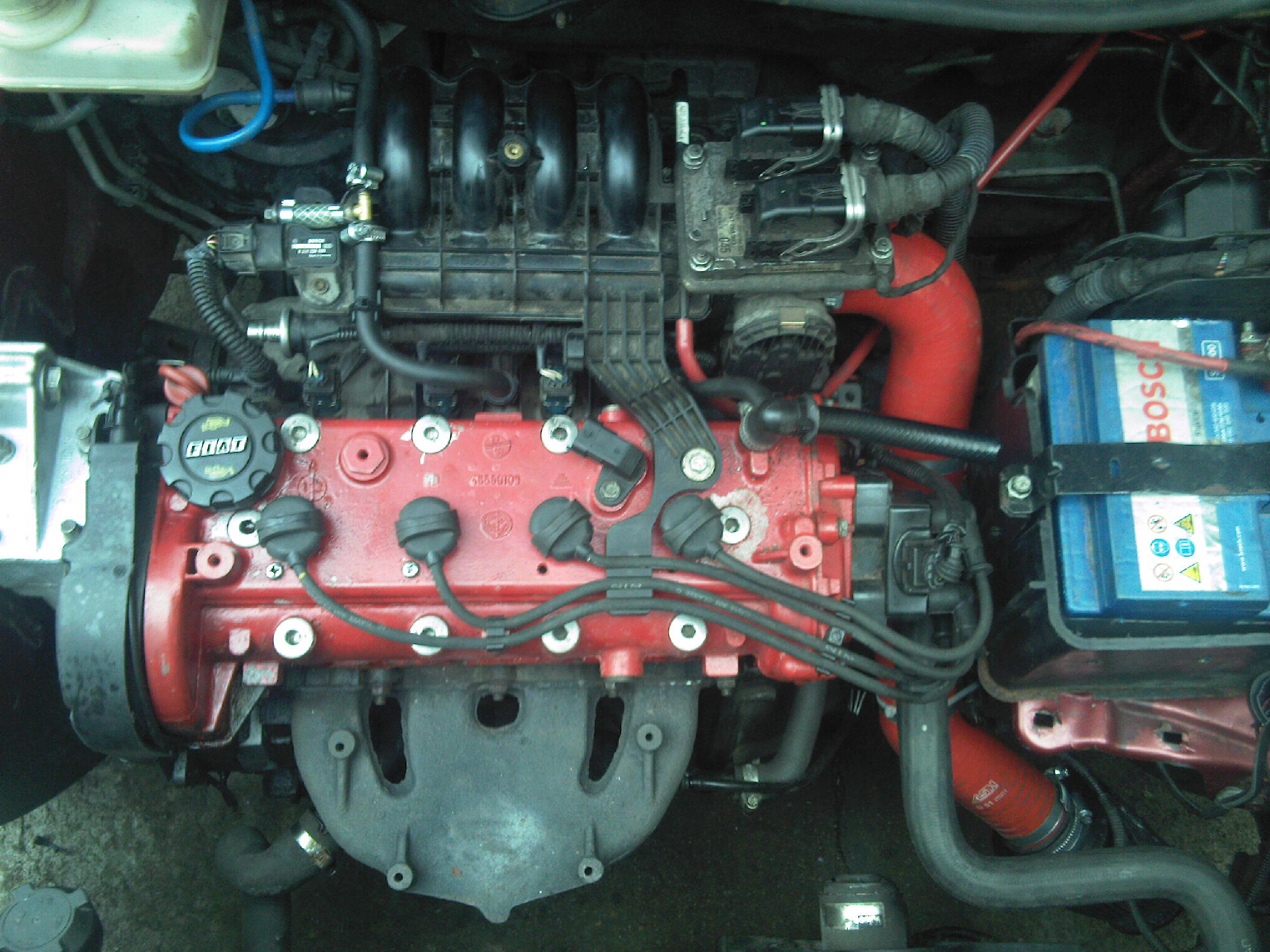

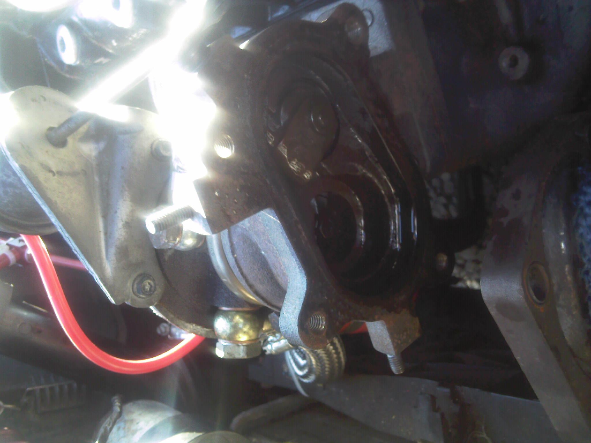

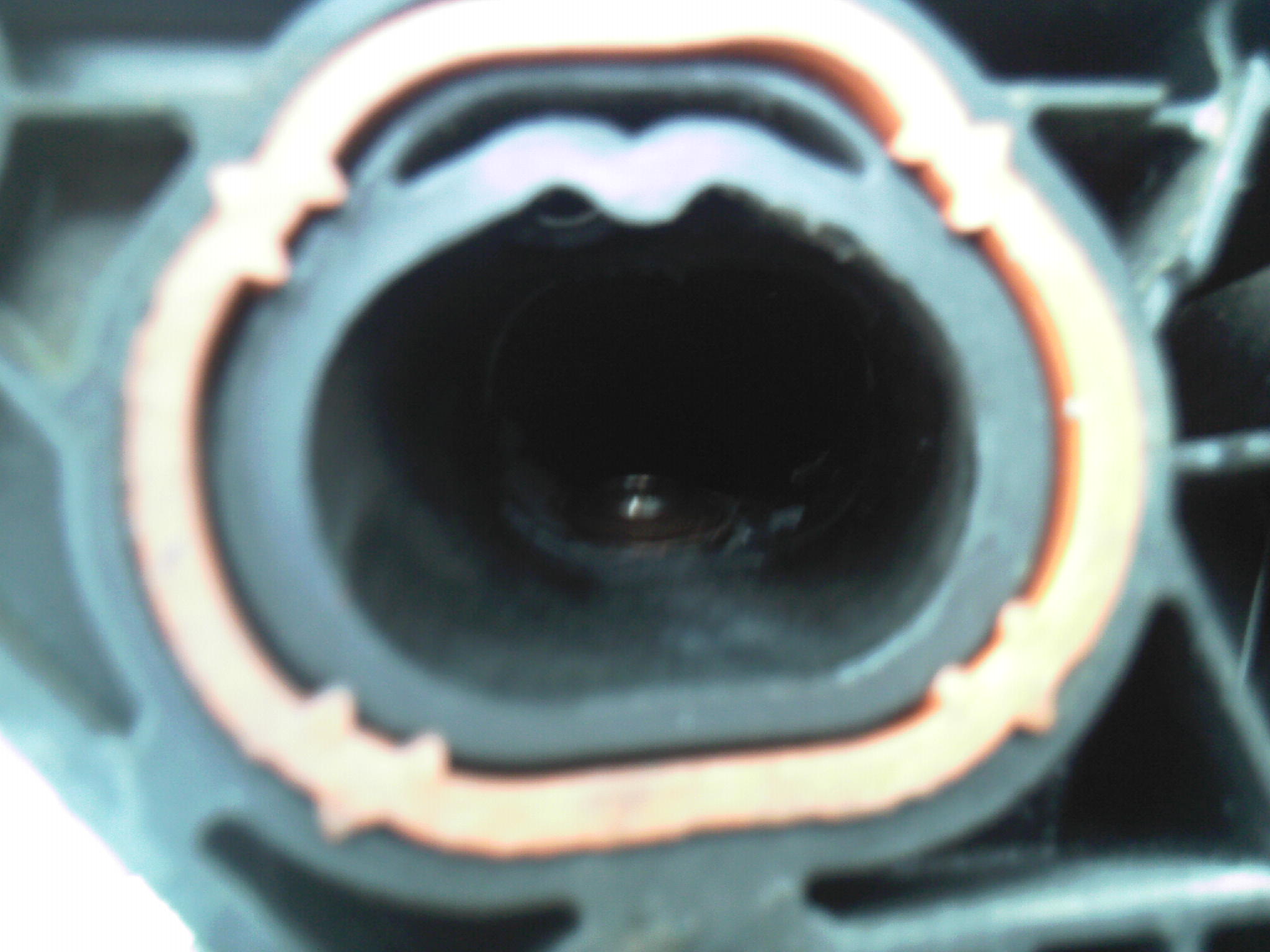

was going to keep this as a suprise but here you go everybody, leaking oil from rear crankshaft seal, bought a new one from fiat and its still leaking
soo much smoke its unberable!
need help bigtime guys
the timing was out by a tooth in the 2nd vid, the 1st and 3rd vid has timing set up properly

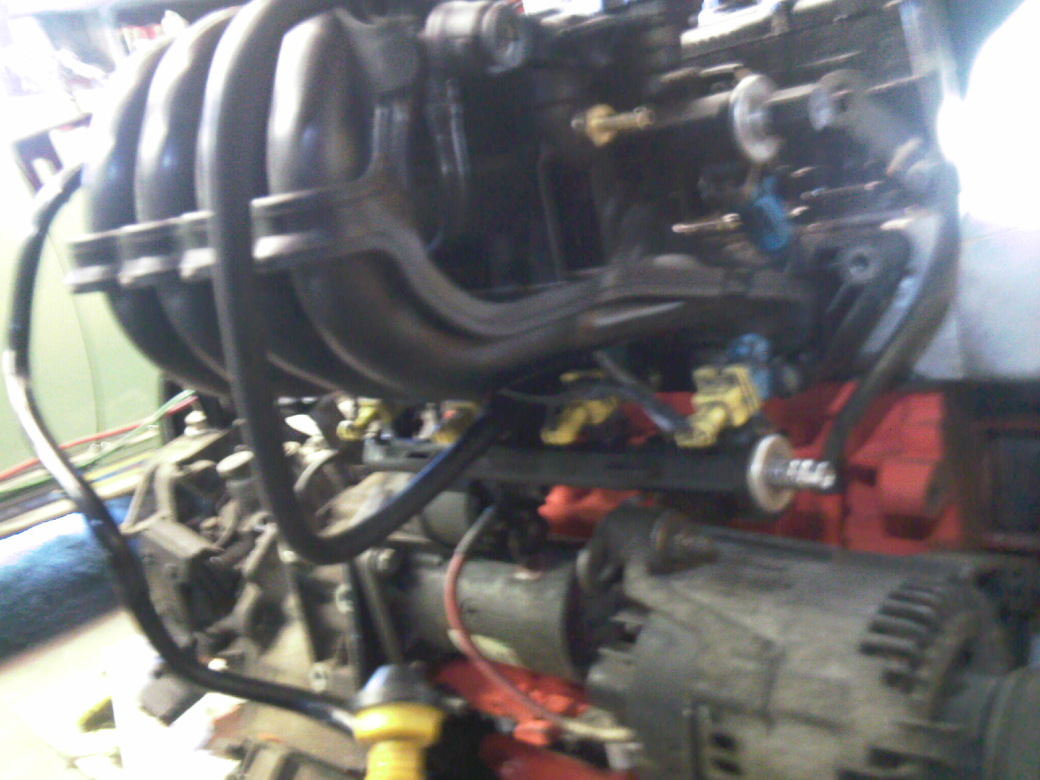

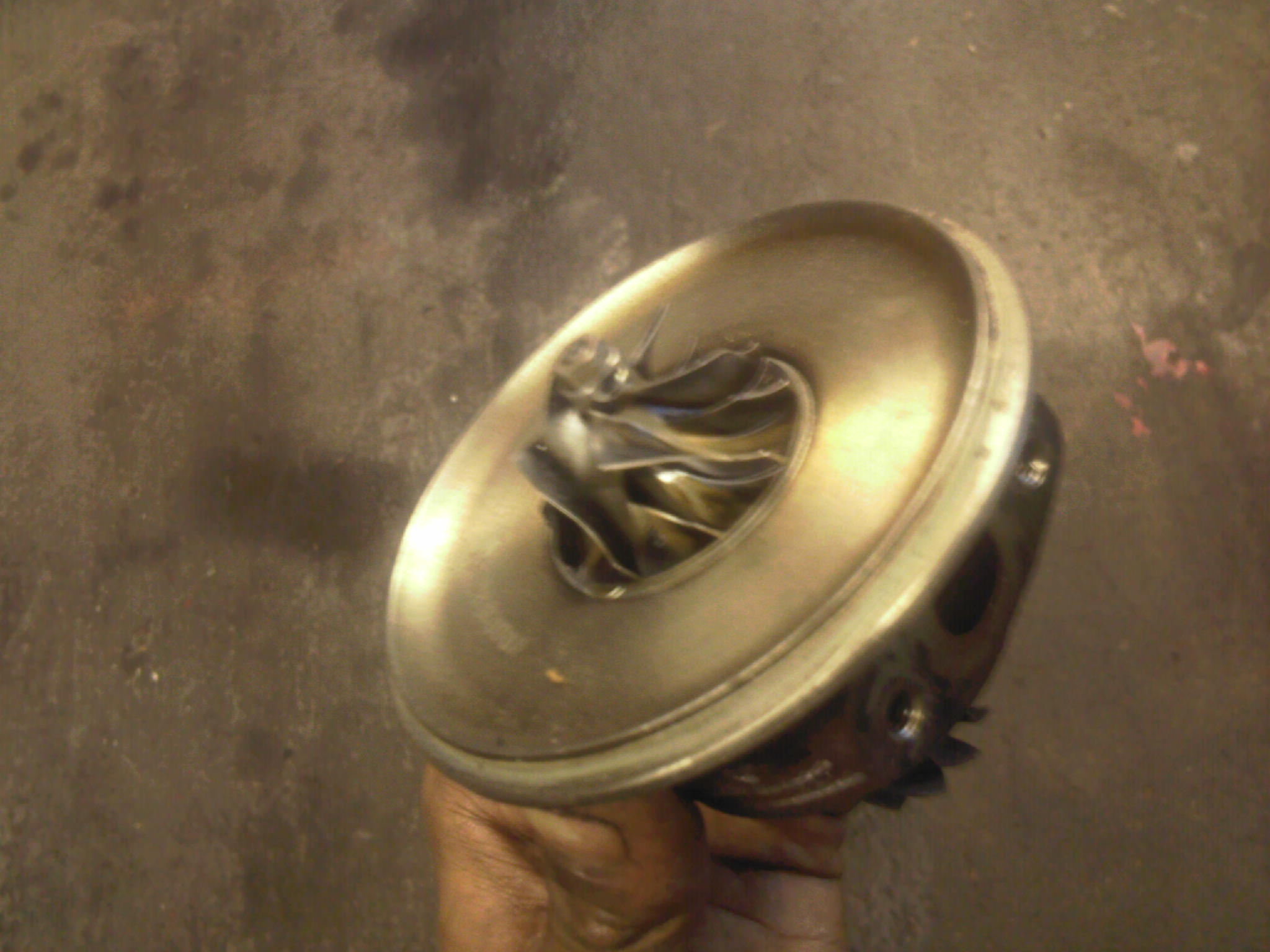

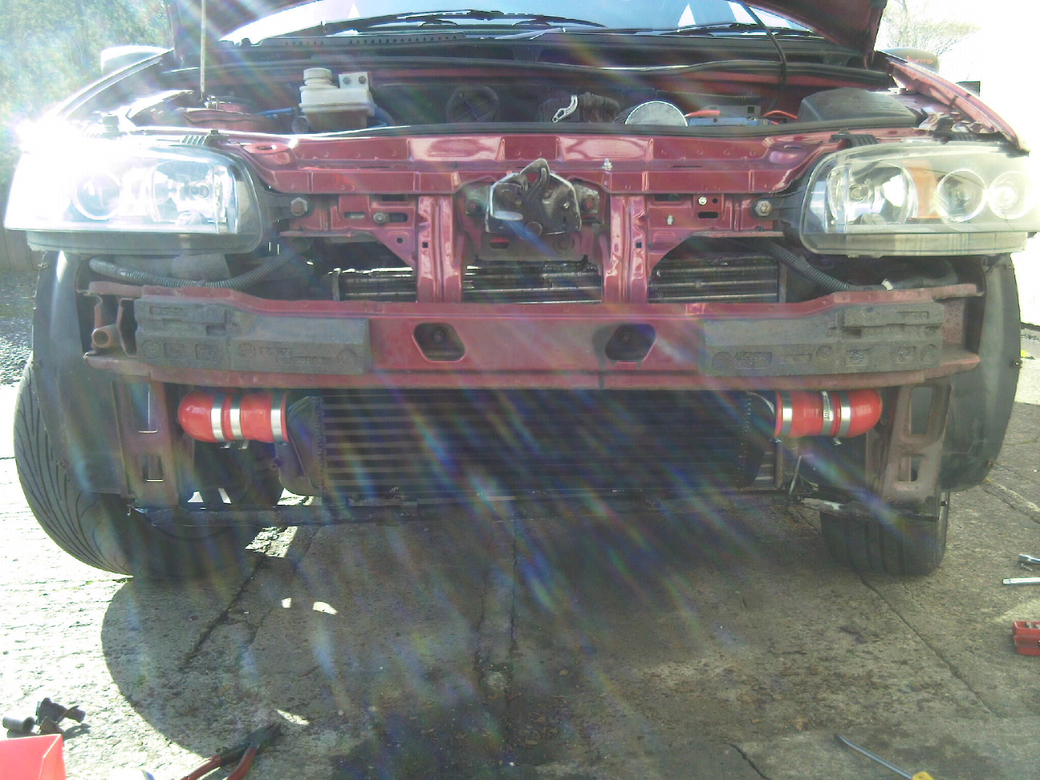

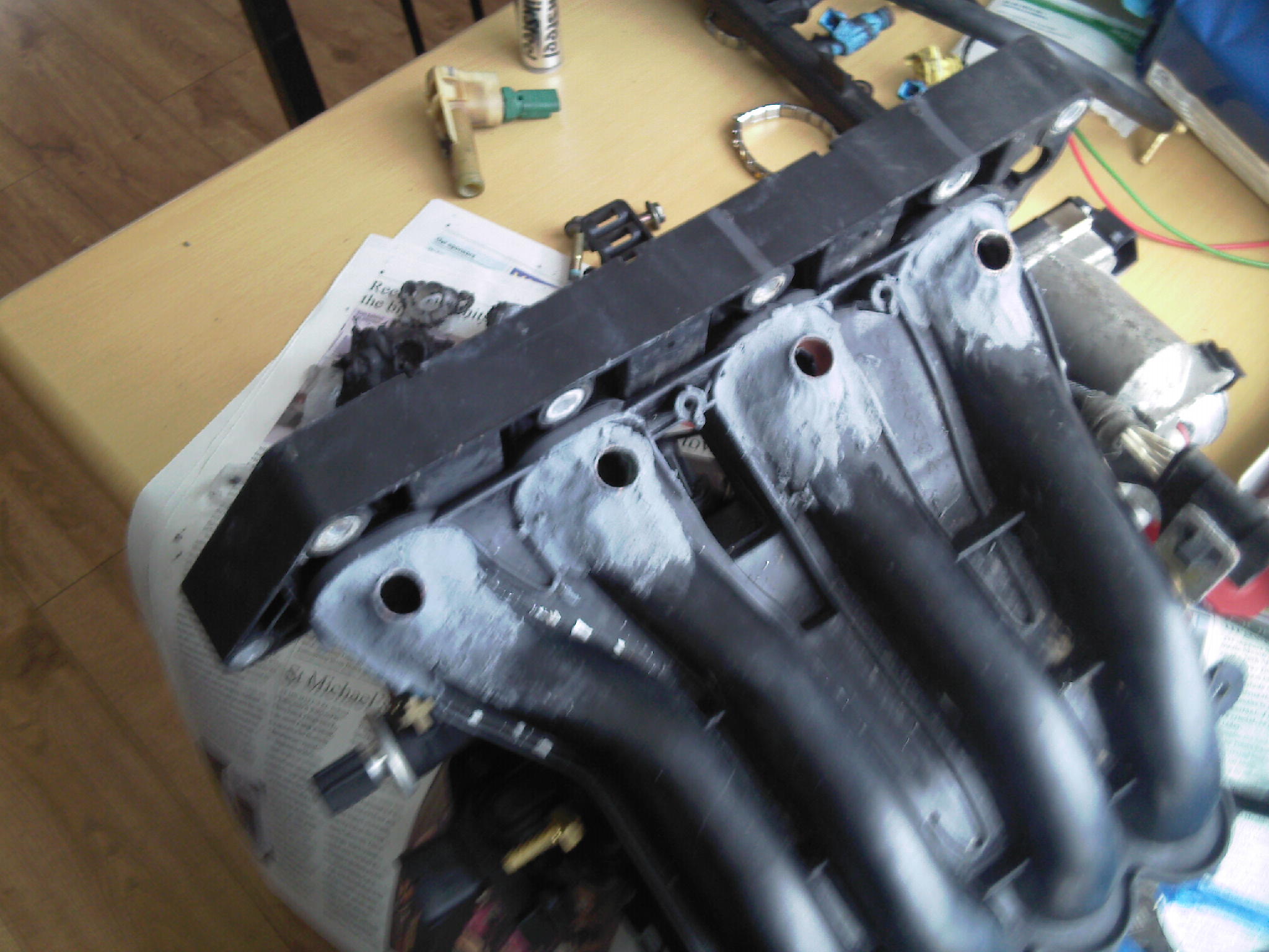

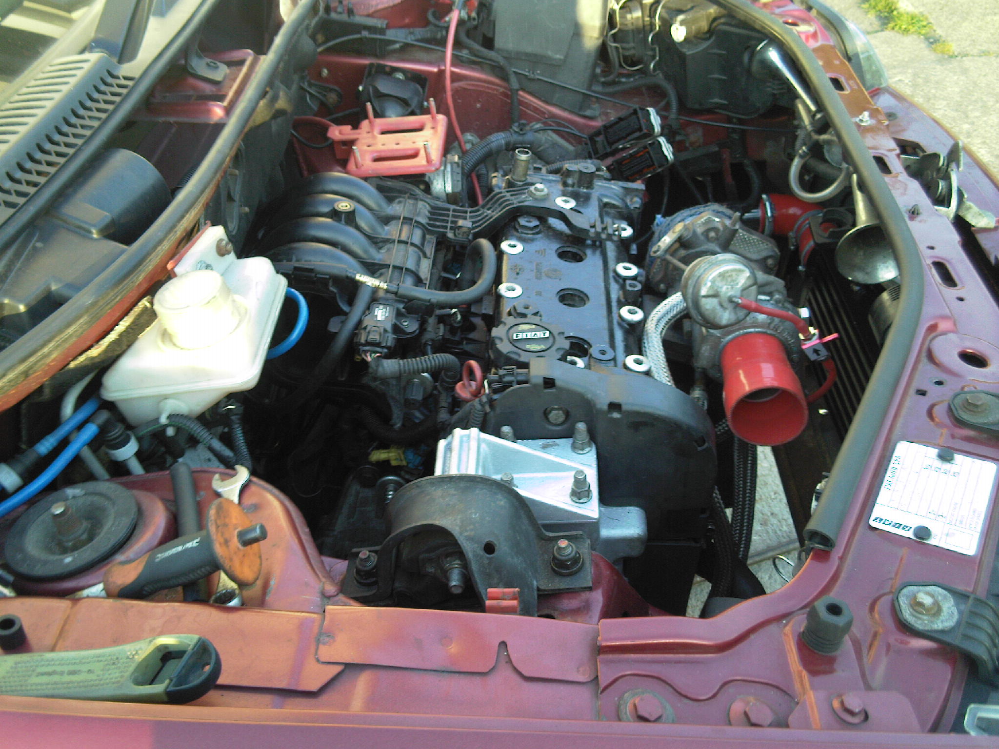

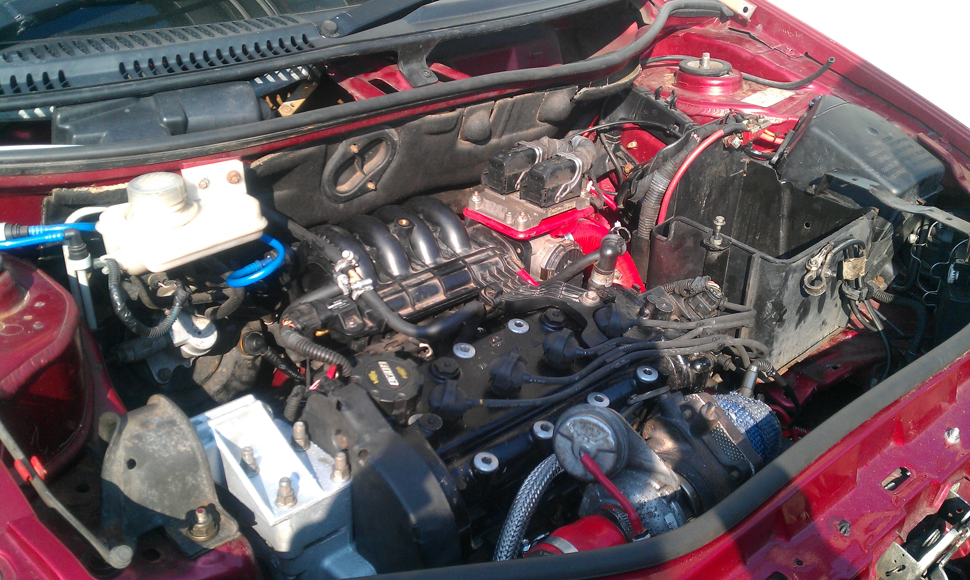

heres my big project that has gone wrong :/
yes that is a vl36 taken off a fiat punto abarth, but i need help here :/
it boosts perfect tho
http://www.youtube.com/watch?v=eMDCg...ature=youtu.be
before everybody asks it has a decomp plate and extra 4 injectors
