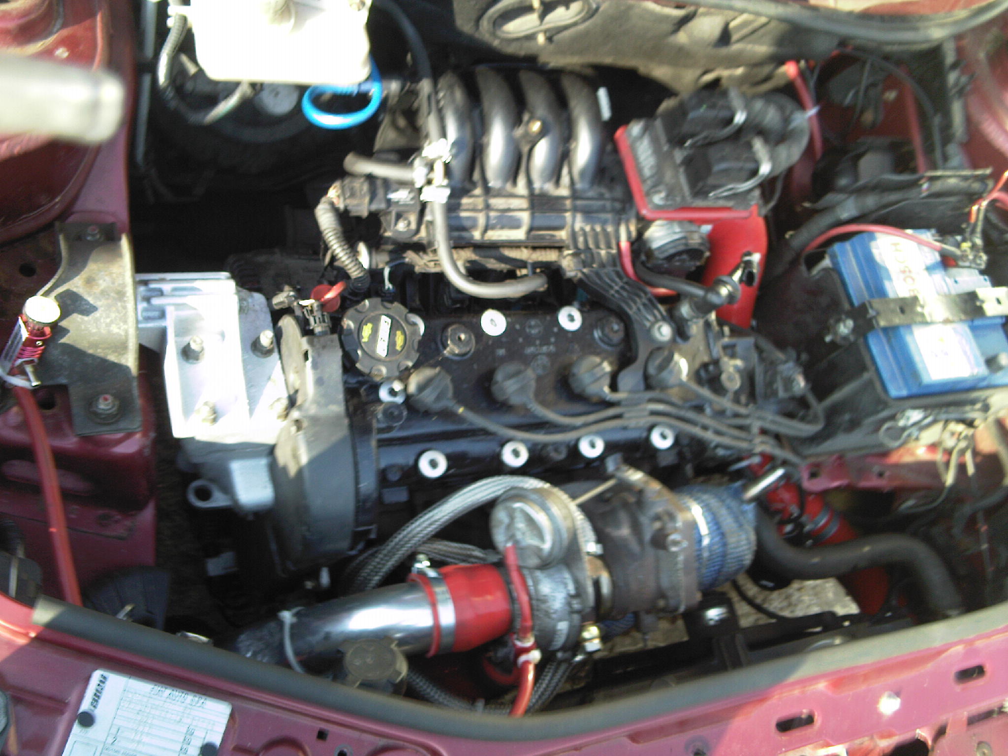

Next i put a Air filter on and moved it out of the way of the radiator :D
My oil breather was split anyway so i used some blue pipe and cut a hole into the intake pipe :) this made the car sound very throaty! i like it alot!!!
a month later i decided to tint my lexarse lights and put on a powerflow cat back exhaust system! ive got to say they have made a HUGE improvement on how the car looks and drives!

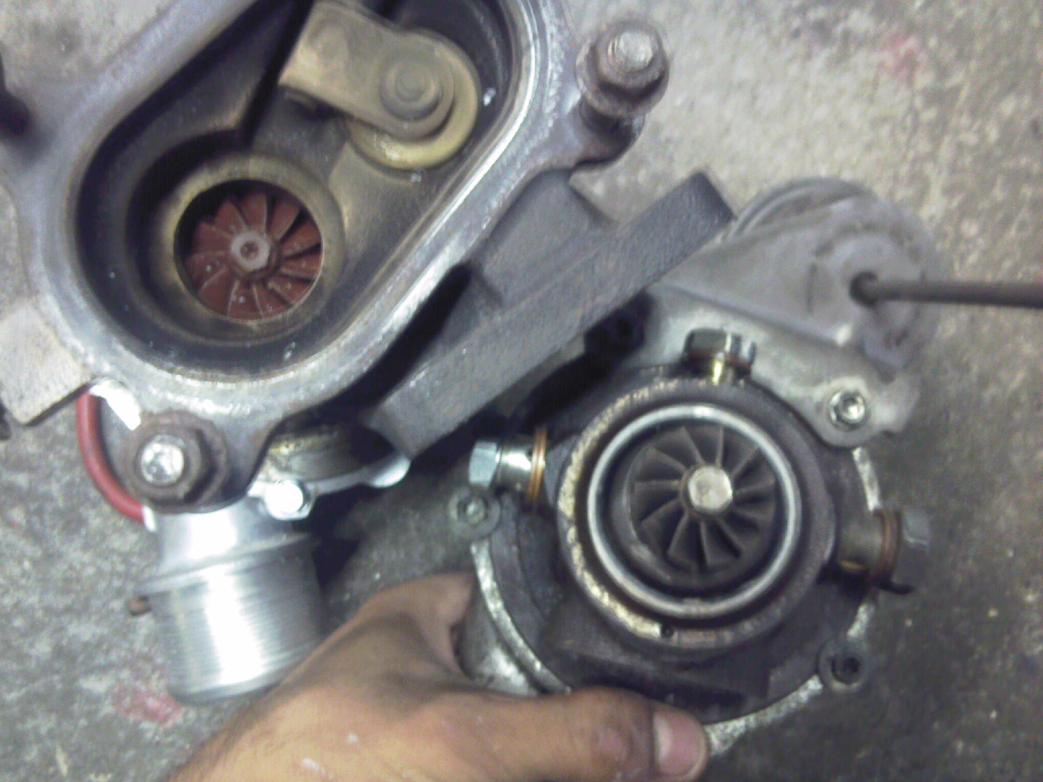

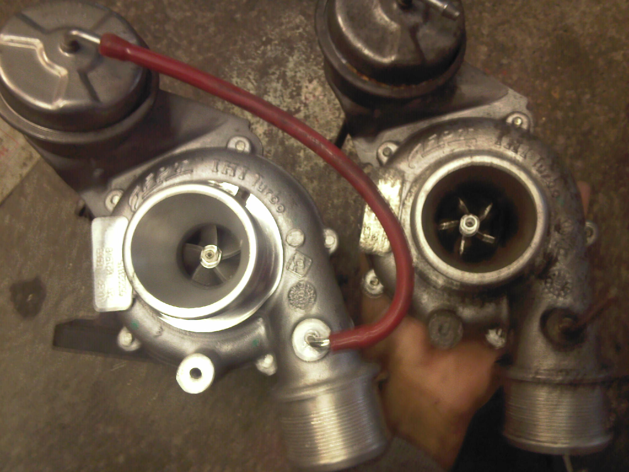

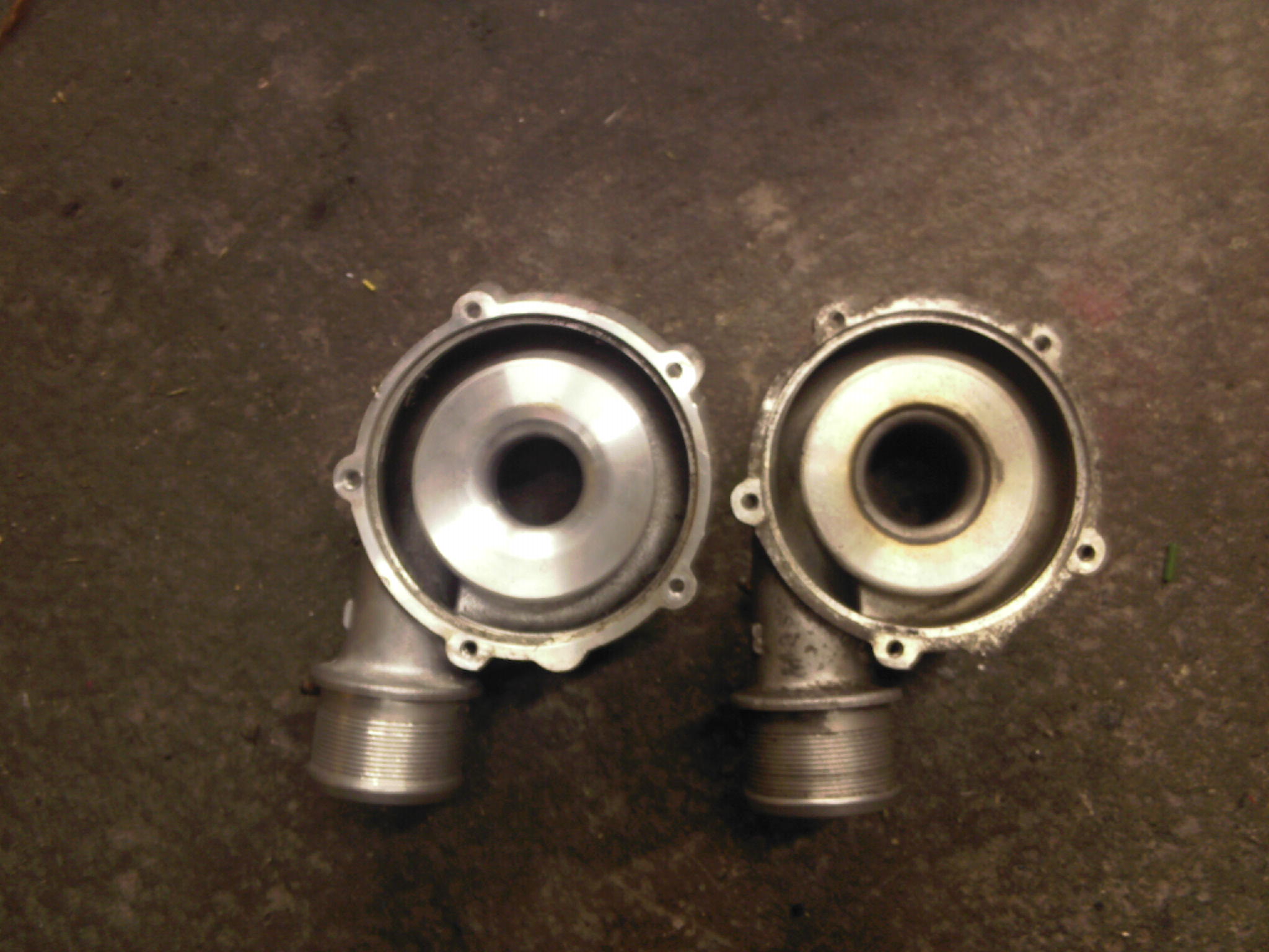

got my vl37 turbo today to compare the diferences and i got the vl37 dirt cheap so its worth a shot
on first inspection they are the same
VL37 on the left
after abit of dismantling the only thing different it the turbe and housing!
VL36 turbine on the left
VL36 turbo housing on the VL37
you can really tell the difference in size from this pic lol
VL37 housing on the left, notice how much smaller the intake hole is, this is great news! buy a vl37 turbo for cheap if your vl36 is leaking oil, mark where the turbines were and switch the two turbines and housings over!

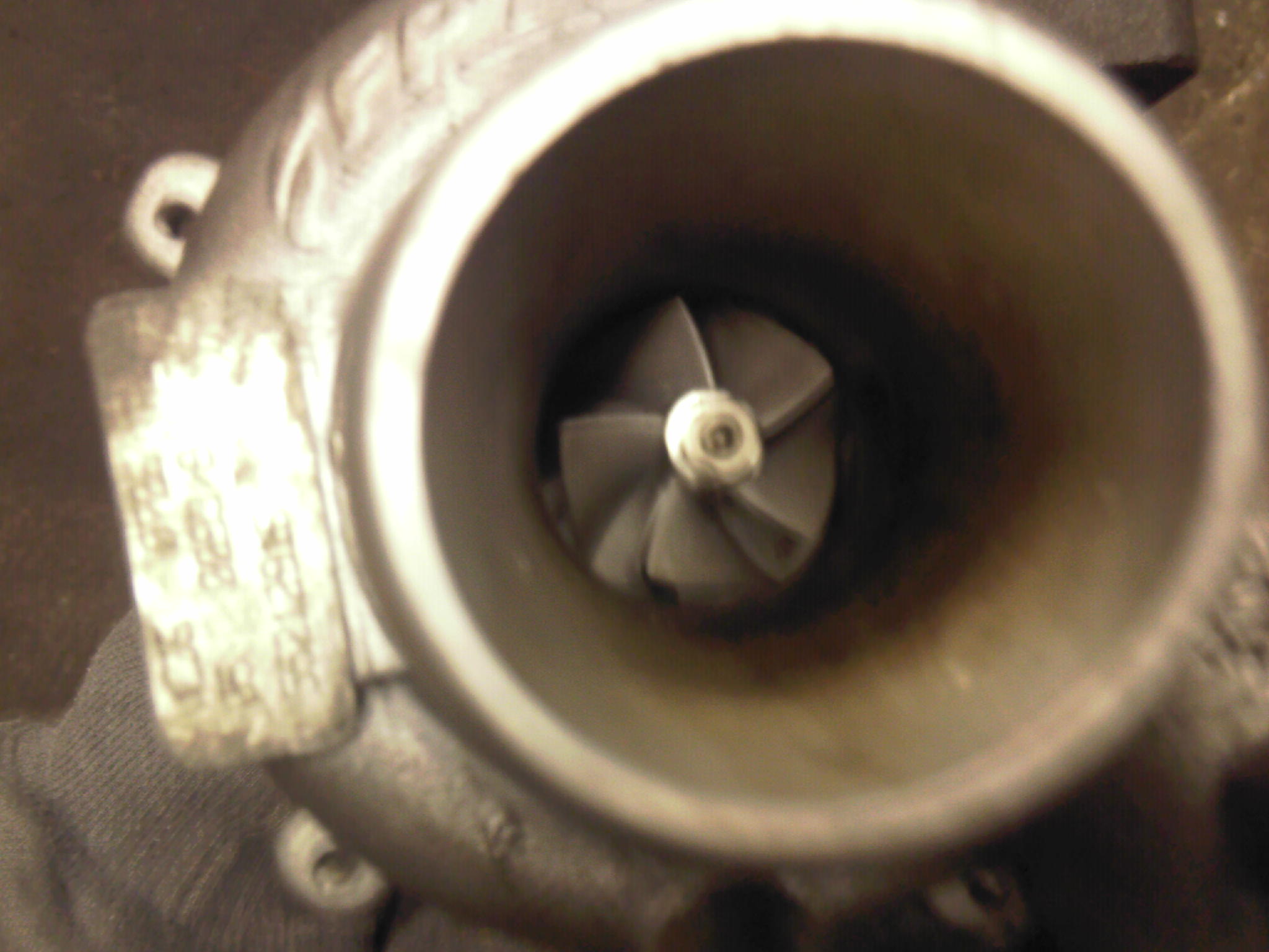

can i have veiws on my turbine off the vl36? the edges of the fins look sligtly damaged, but is it still reuseable?

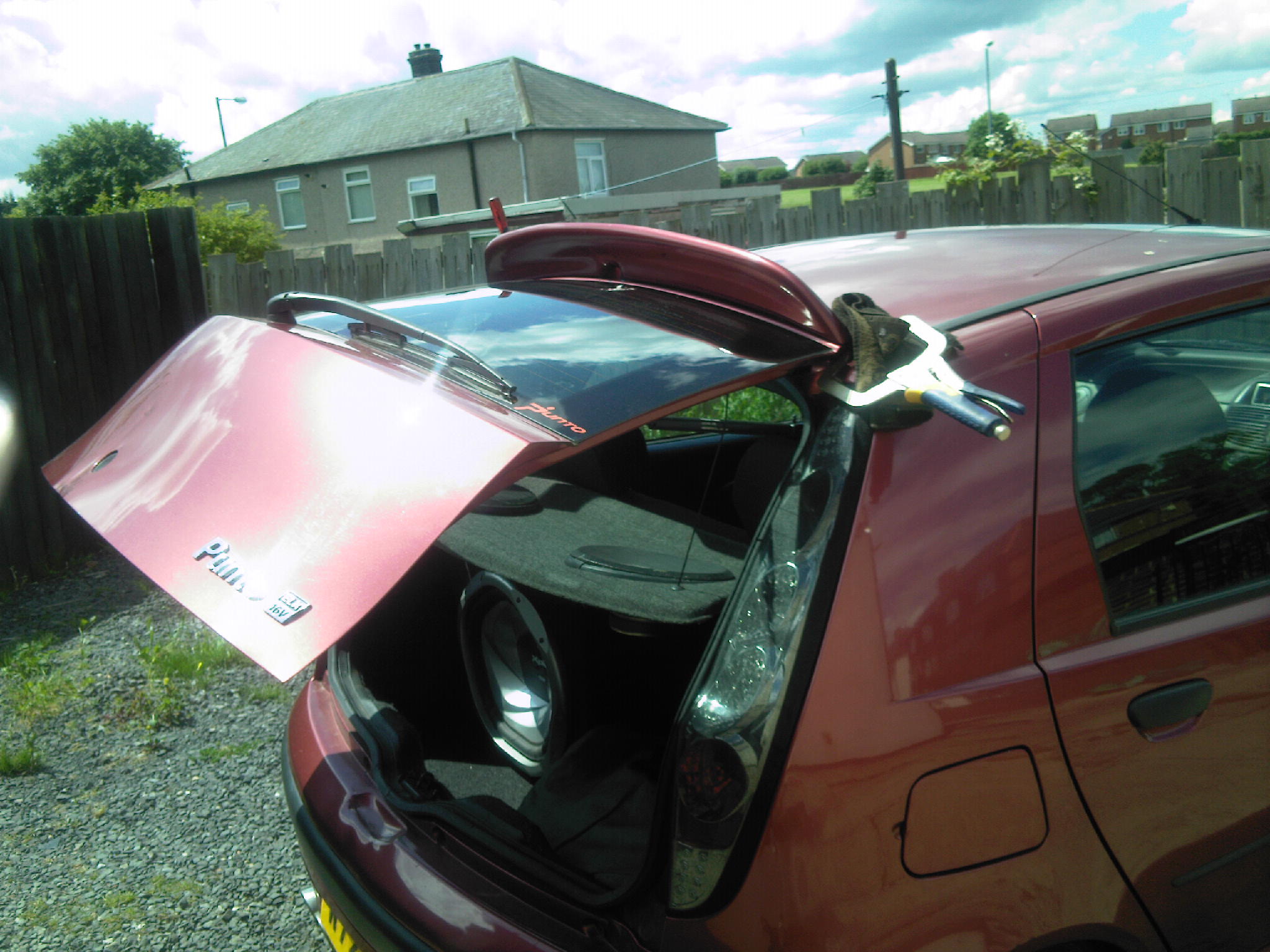

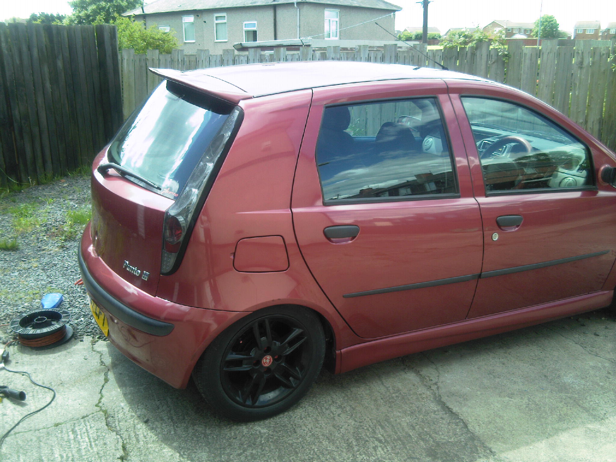

Fitted a spoiler!!!!
was already in primer, painted it myself using aerosols lol
Aftermarket - bigger than a sporting spoiler, i took a random guess as the pic of the spoiler wasnt 100% but when it came it was exactly how i wanted it to look!
in primer before i keyed the paint
4 base coats and 3 layers of laquers and i got the perfect paint match!!!
I LOVE IT! the back needed abit of styling!

PS: This may be too late, but wouldn't re-use the old turbo blades... -- had one commit suicide in my old Isuzu: and it took out a whole load of stuff with it.... Not pretty. Not fun. :mad:

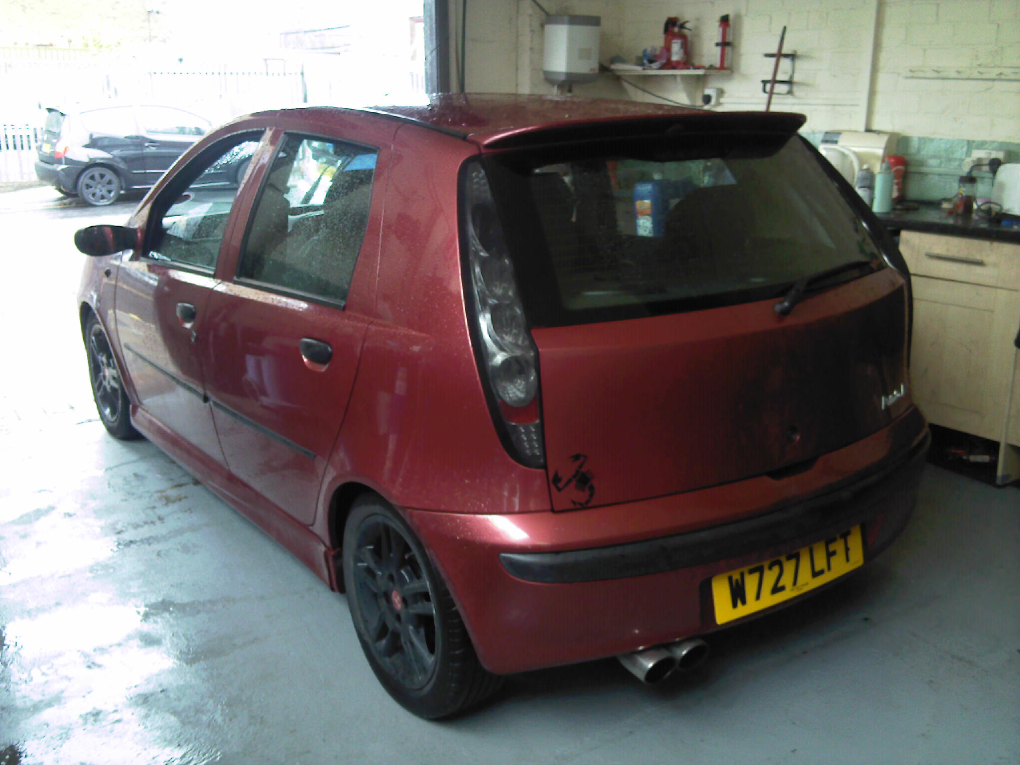

...after the repair wento for a posing shot!
I'm now insanely jealous... -- on both counts...! ;)
I've been really struggling to find a Scilla Rosso scrappy to plunder... -- plus that "posing shot" makes me realize just how badly I'm doing.... (Mind you, I shall stick with the excuse of being laid-up after a recent kidney op, for as long as I possibly can...!) :cool:
