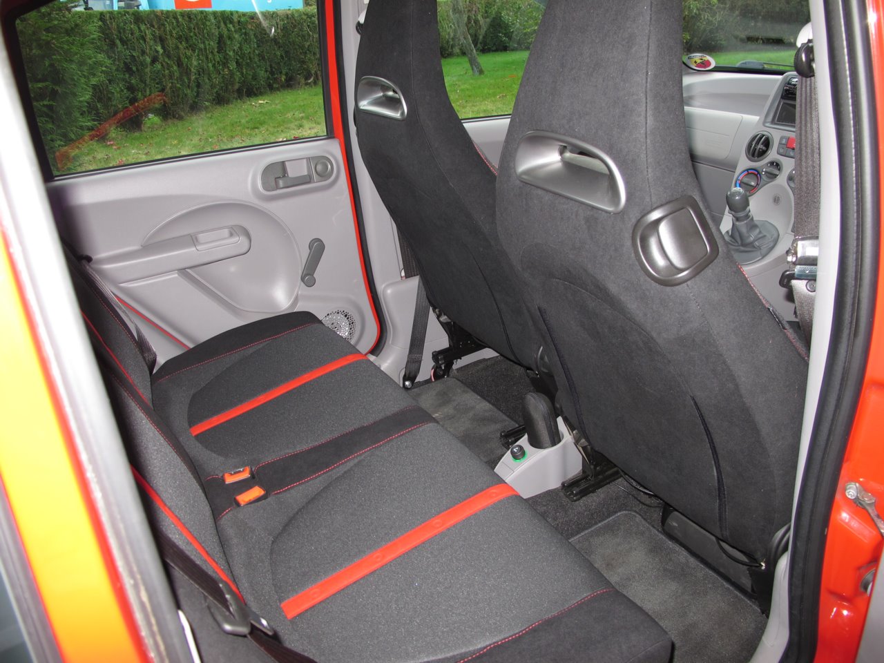

Thought it time to post some info about my long-winded build project, as I've had a few PM's about it. Have also now fitted the full compliment of 500 Abarth seats and the interior looks great I think. So to get that out of the way first perhaps.
Front seats needed the same mods as nicely described by Lewey earlier this year - 3 of the mounts line up but you need to surgically remove the B-pillar mount bracket from the original Panda seat and transfer it to the 500 seat, having first removed it's own original of course. Mucho drilling but all bolted up nicely in the end.
Rear backrest/upright bolted straight in without any mods, which was a surprise as I expected to have to change the upper seatback locking mechanism each side, but turned out not to be necessary. Rear squab/base needs a little more fettling, but nothing more than a deft chop of the odd edging frame wire to make it fit between the narrower width between the rear arches. Eben ended up using the std Panda seatbelt catches too, so it really was an hours' job only.
The front seats are so much more comfortable than the std Panda jobs and now the rears match to make the interior look correct. I plan to try and find the matching gear nob and gaiter if possible, just to finish it off.

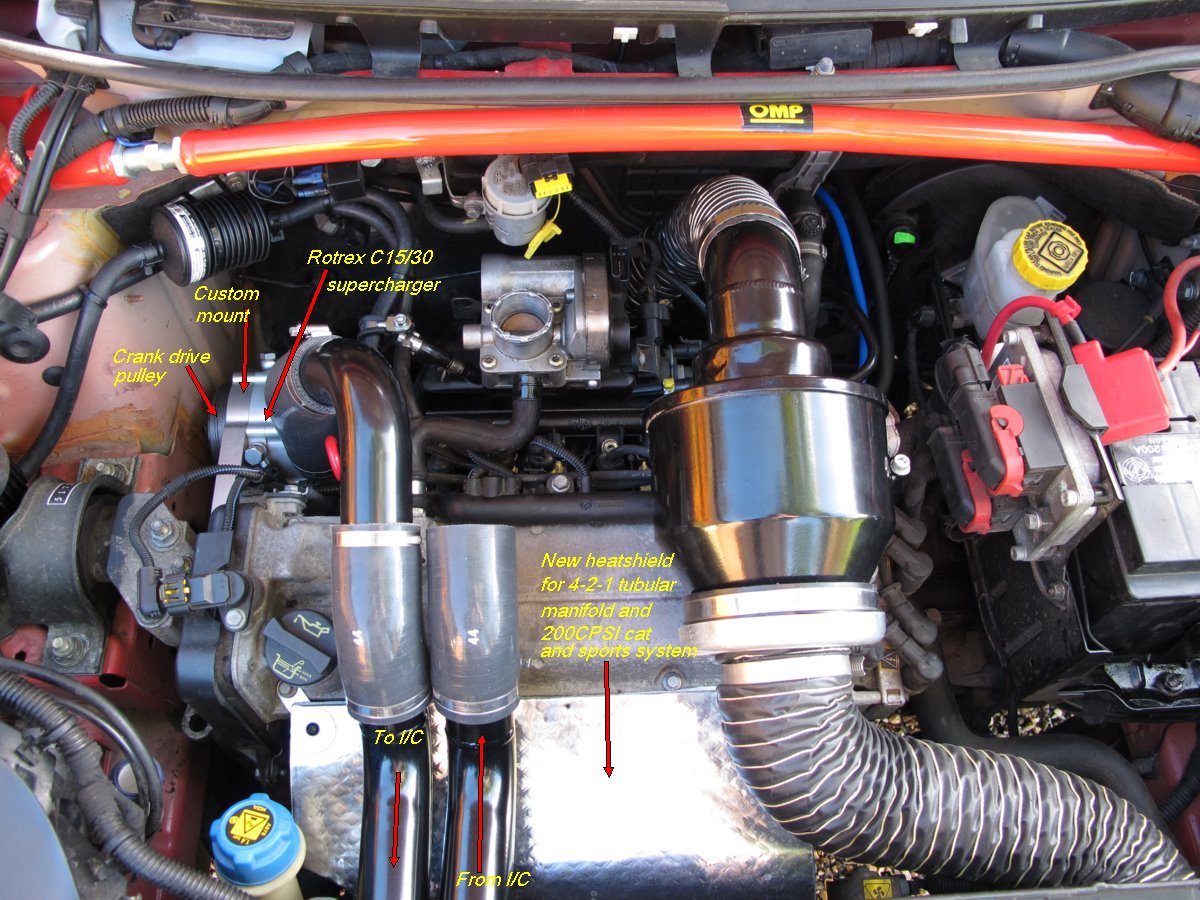

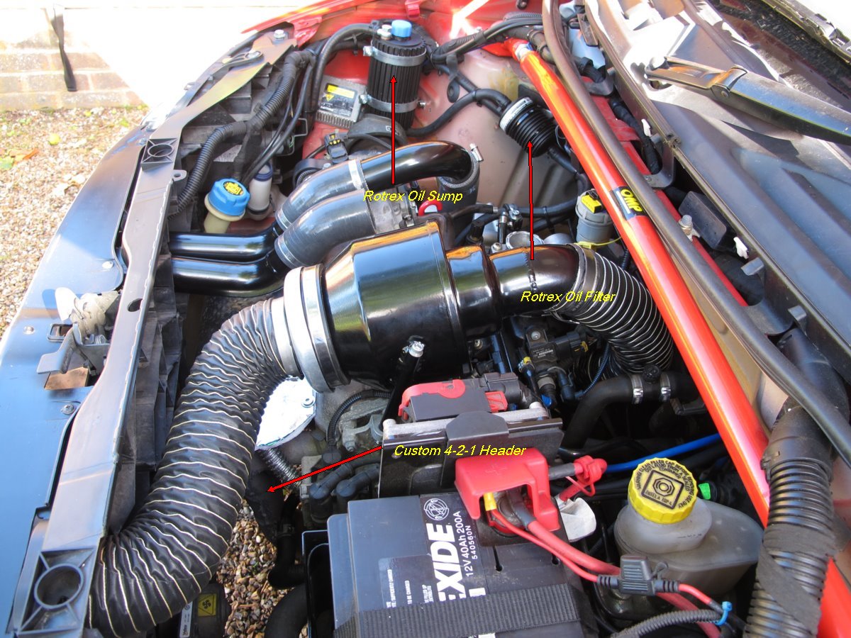

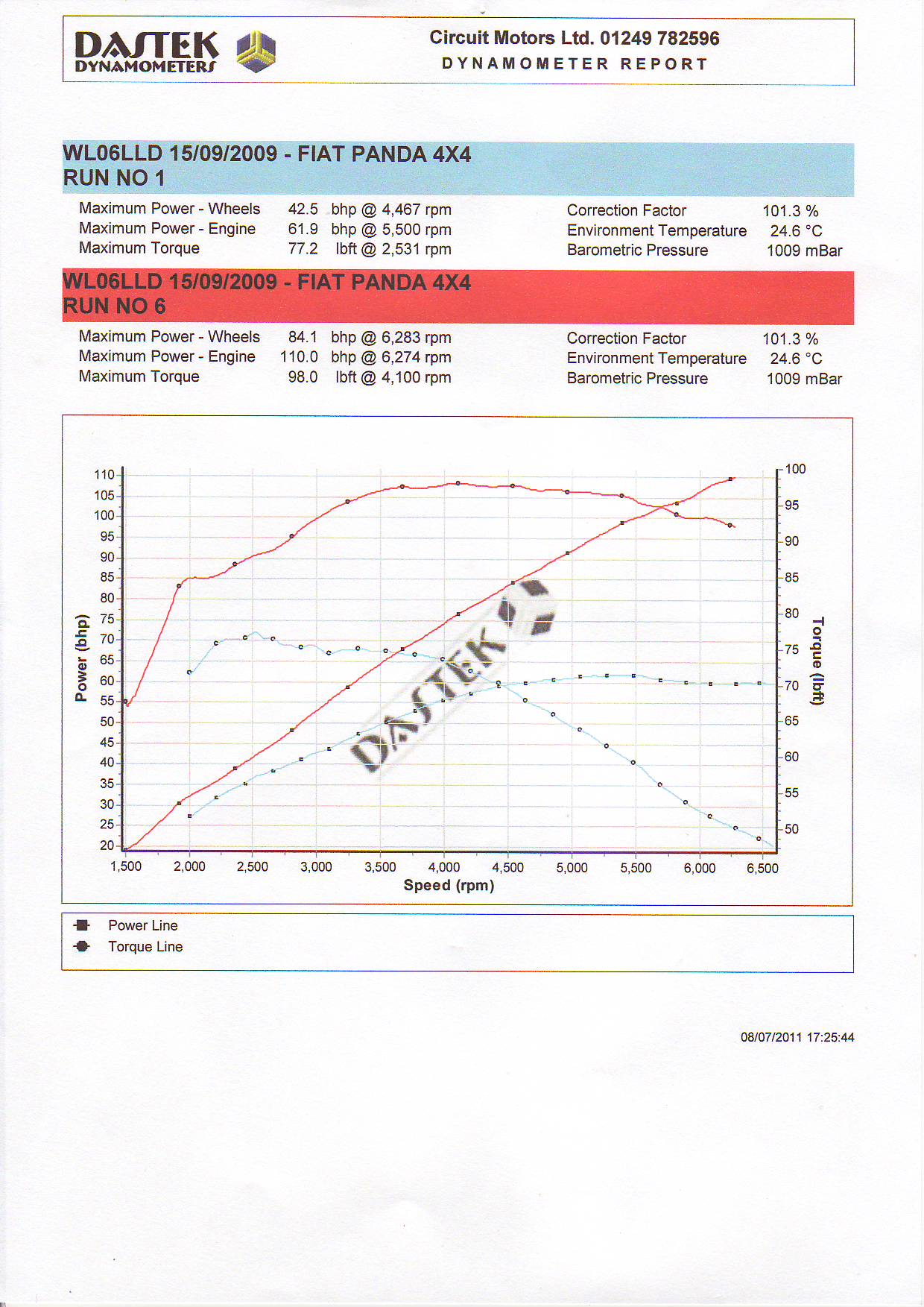

In my view the Rotrex is perfectly suited to fitment on a small, standard engine as it makes it's power further up the rev range, as centrifugal chargers produce linear boost, unlike the displacement Roots types that can make lots of bottom-end busting torque that would require reductions in CR and beefier transmissions just to cope. Same issues experienced with Turbo conversions on standard engines. Although I invested in an uprated CG Motorsports clutch, it remains on the shelf in the garage for now.
My Rotrex is the smallest going - the C15/16 - and is normally fitted to motorcycle engines. It is geared to produce 11psi at 6500rpm and that makes 110bhp at 6300rpm and 100ftlbs at 4000rpm or thereabouts. But best of all, it makes 92ftlbs from about 2500-6500 rpm. It really is a fabulously flexible motor now.

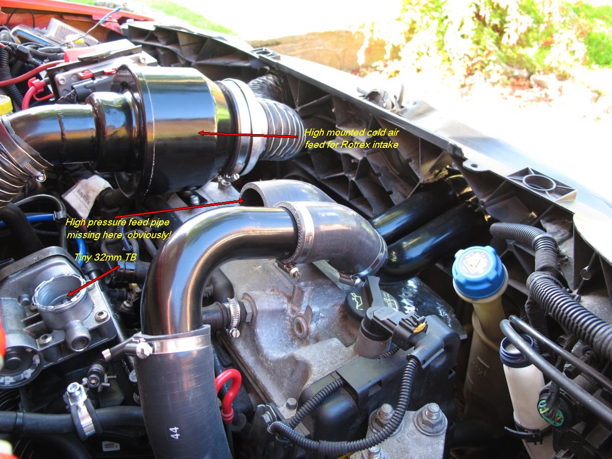

It sits in the place that an A/C compressor would go, were my car to have had one. This really is the only realistic place to fit it. A 1.4 FIRE engine could probably take the C15/30, which has a bigger compressor housing and was the one I tried first, but the boost was simply too high for my 8v 1.2 and I had to restrict it too much to keep power/torque down to acceptable levels. In the end the restrictor was too restrictive for the unit and it popped a seal, so I went smaller still but without restrictor. Less drag, same power, perhaps slightly less torque, but safer and more efficient all over in general. The correct choice.
My car went from 60-110bhp without any currently obvious issues (2500 miles in and counting). My BIG issue was the Magnetti Marelli ECU that stays permanently on CLOSED LOOP, meaning that it would always keep the AFR's at a perfect 14.7:1. Whilst this is fine for a normally aspirated engine, a forced induction wants about 12.5:1 under full power and the effort required to crack the ECU was significant. In the end I went with a Dastek UNI-Q ECU with their iDriver module to fly the injectors. This has produced a nicely mapped motor that still makes 35mpg in day-to-day driving. It was only averaging 38mpg beforehand - a 90% increase in power for only an 8% penalty in fuel. Those Rotrex units really are very efficient.
Injectors went up from 145cc/min to 215cc/min and my engine used the small Weber Pico units, unlike the 100HP and Fiat 500 1.4's on the larger Bosch jobs. It is relatively easy to get hold of bigger sizes though (Competition Systems near Reading - thank you chaps). I needed to move to a Saab 2bar MAP sensor, as mine was a 1bar only unit that threw a spazzy fit whenever it saw more than atmospheric.
Exhaust is a Punto 4-2-1 manifold (suitably modified to miss the transfer box bit of the transmission) hooked up to a custom Longlife system and 200CPSI CAT courtesy of Matt at the FastFit Service Centre in Basingstoke. This was important as the std exhaust would never have had the flow rate required for 100+bhp...
The installation of the compressor was by TTS at Silverstone and they were excellent. The quality of their work is faultless and I have a fully CNC machined billet mounting bracket that looks 100% factory, matched to a billet machined pair of crank and s/c pulleys, running perfectly true, with the crank pulley machined for a perfect fit with the OEM crank pulley. It really is very professionally done.
Mapping and setup was by the hugely talented Paul Shepherd at Circuit Motors next to Castle Combe - one of the most knowledgeable ECU experts you'll ever meet.

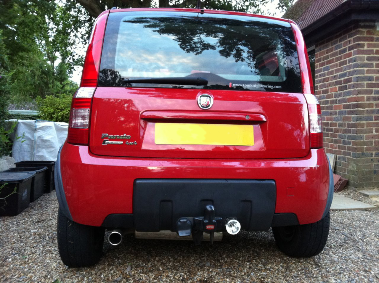

However is that a chrome towing plug. Look :yuck: IMO, but the rest is :slayer: all the way :D
Fortunately not - it's a small spotlight for use when hooking up trailers and things in the pitch black countryside. Also rather a good reversing light too....

Is it a difficult upgrade? Yes, unfortunately. Plenty of parts required, as the base car is designed to a budget price, not performance. Having said that, everything is relative and it's much much cheaper to do something like this to a Panda than something upmarket and German.
Jury is still out for the gearbox, but as you can see from my graphs, the power is all made at the top end and the torque is spread nicely around. As this box is used in a lot of Fiat vehicles with FIRE engines - some of them with broadly the same power - there's a good chance that this modest output is well within its capabilities. I do hope so anyway! I will steer clear of runs up the drag strip of course though - I'm far too old for that.....
