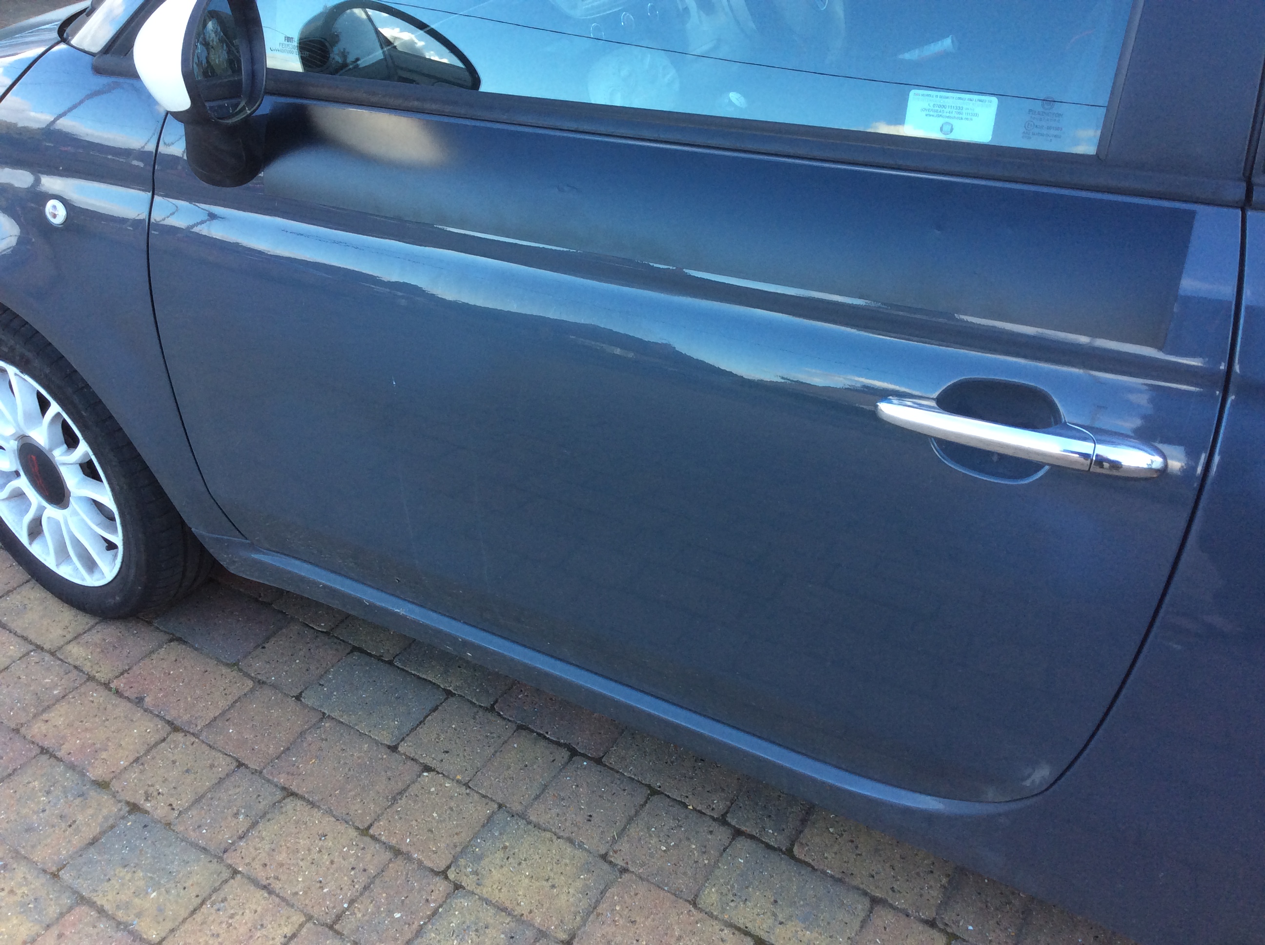

I had reason to have my car cleaned at my local Tesco and since then I have noticed that the paint has bloomed and it looks like a cloud in places. What can I do to get it back to where it was please ?

Here are the worst areas. The black area on the passengers door is magnetic rubber to let Max rest his claws on when he is window surfing. Going clockwise...top left..hazy in the middle of the door
top right...mid panel

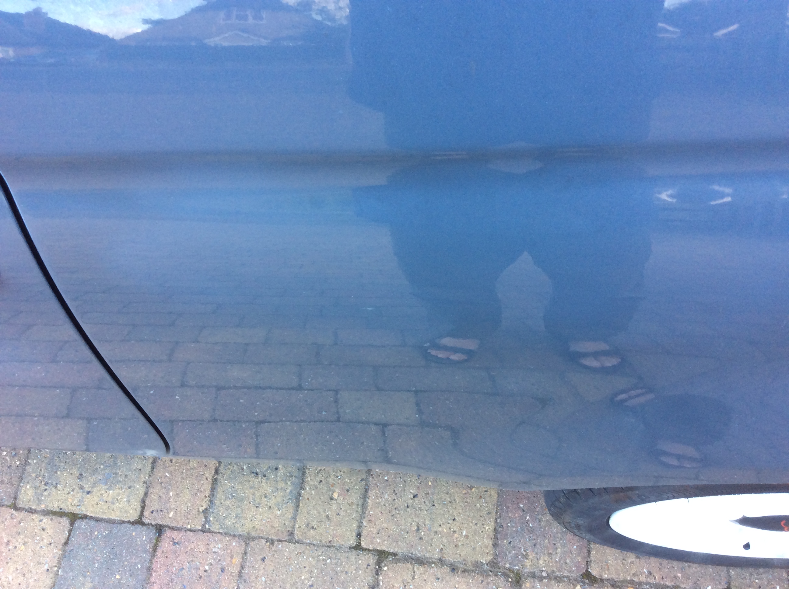

bottom left... middle of picture to the left of my reflection.

very hard to see from pictures,but has your car been sprayed repaired before,from what i can see looks like primer showing through the paint,as if not enough top coat was put on the final finish,only time a paint would bloom go cloudy,is if top coat was not dryed properly after been sprayed and dampness soaks into paint,
You could get a local car detailer around for a quote , he'd probably know what the problem is.
Or pop out to see Gareth again for a professional opinion.
(Next meet should be this coming Monday)
Most modern paint is lacquered. Sadly if the paint underneath is affected by the sun, polishing the lacquer makes no difference. Welcome to the future.
Is it stll new enough to have the Fiat paint warranty? After Gareth's opinion, might need a dealer visit.
It will be 6 years old in August !I think it may be from when I had the hail damage done as they offered to take out the supermarket dents at the same time. It's not life threatening, but just annoying because I cant unsee it :(
It was just after we went to the auto museum with the forum. The beginning of September 2018. A company in Reading. Given the state of the inside of the bonnet, tape residue etc, I am in no rush to get them to do anything !
